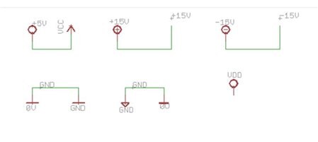

I've created a schematic design for a digital circuit with an isolated RS422 section. I'm using an isolating power supply for the transceivers and bringing the data lines onto the main board using an optoisolator. From that point, the rest of the board has common power and grounds. I'm using polygons with different names for GND on each section.
I'm running into 2 distinct problems.
1) I need to keep the isolated VCC and GND nets separated on the schematic. I'm having some sucess with this as I am using different net names (i.e. GND and -VOUT)
2) Power and Supply pins are more challenging. Some IC's have VCC, others VDD. The isolated section I've given the net name of +VOUT. All are at +5v.
When I run ERC, I get warnings of interconnected nets. I believe I'm using Power and Supply pins incorrectly. Simple case - how do I properly connect +5v to VCC and to VDD on the same net?
Slight mess! Yes, VDD has no net as it will generate more errors if I connect it to +5v.
I appreciate your time and suggestions!
Warm regards.

    0 dukepro over 12 years ago in reply to e14 Contributor
    On 10/01/2013 01:29 PM, David Kanazawa wrote:
    One side note - I'm not clear on why it's necessary to even have the
    supply and power connections laid out. Is it for clarity of which
    voltage is being applied to a particular net such as defining the VCC
    voltage?
    VCC, of course, stems from the collector voltage, just as VDD refers to
    a drain voltage.  Consider the case where a SUPPLY device called VDD is
    attached to a POWER pin on an IC named VDD.  This certainly avoids the
    DRC warning.
    Putting on my philosopher's hat for a moment, the purpose of a schematic
    is to convey the design of a circuit to a reader.  Some may call it art,
    and other may call it the essence of the circuit.  Whatever one chooses
    to call it, a schematic should convey what the circuit is about, and not
    necessarily how the design is manifested on a PCB.
    Back to engineering...  So, when a reader sees that a VDD supply is
    connected to VDD pin, it's a real "duh" moment.  The next question is
    "what is VDD?".  So, instead of using a SUPPLY device called VDD,
    consider using a SUPPLY device that conveys what the voltage on that net
    should be.  Something like "5V", "3.3V", or "+15V".  This serves a
    dual purpose in that it immediately conveys to the reader what VDD
    should be, and it produces a DRC warning allowing the designer to verify
    (by approving the error) that the proper voltage supply should indeed be
    connected to VDD of that particular IC.
    As far as leaving the power pins off of a schematic, I would recommend
    against it for the simple reason that it hides information from the
    reader.  Many IC's have power and ground pins on the corner (7 and 14,
    or 8 and 16); others have power and ground midway down the sides; and
    QFP's have multiple power pins scattered wherever they're needed.  In
    cases where the power pins are a separate gate from the main schematic
    symbol, I usually stuff them down in a corner of my schematic along with
    a bypass capacitor.  But keep them on the schematic
    I would recommend using SHORT devices sparingly in that it, in part,
    defeats the purpose of the DRC.  For example, if one were to connect a
    +5V supply to a GND supply through a SHORT, Eagle would not complain one
    bit.  But as soon as you applied power, your board would certainly
    complain with a puff of smoke.
    HTH,
        - Chuck
    • Reject Answer
    Use the supply symbols in supply.lbr or supply2.lbr for each of your
    different nets.  i.e. GND, GND1, GND2, etc.
    Eagle will treat these, as it should, as separate nets.  To tie them
    together, use the SHORT device in the attached shorts.lbr.  This is
    merely two pads that overlap each other.  This will produce a DRC error,
    but it can be approved to prevent from being a nuisance.
    are at +5v.
    You can use the supply symbol +5V from the supply2 library to name the
    net (it conveys more information to the reader).
    ERC warnings of the type "VCC connected to +5V" can be approved.  All it
    means is that the name of the power pin does not match the name of the
    net to which it's connected.
    If you want to connect separate nets, use the SHORT device.
    I do this quite often to separate different grounds such as analog
    ground, a noisy high-power ground, and a logic ground.  I want to tie
    them all together eventually, but keep them separate as long as
    possible.  So all the shorts are placed close to the battery connector.
    Since it's an on-board component, I take all shorts out of the BOM.
    HTH,
        - Chuck
    • Reject Answer

    0 autodeskguest over 12 years ago
    It is a warning. Either ignore it or fix the component to match your
    power and ground names. This is a check that helps simple circuits of
    beginners and a nuance with complex circuits.
    Paul
