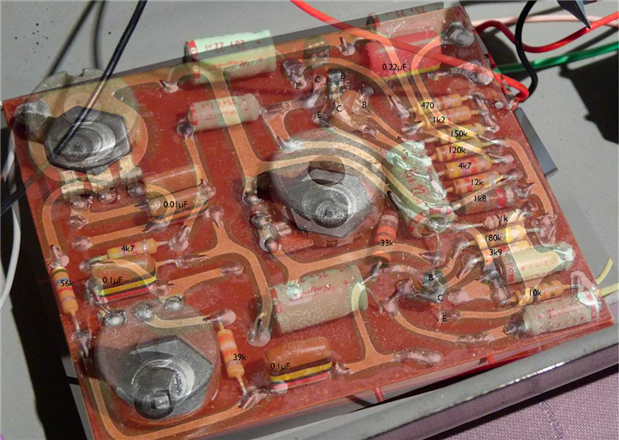

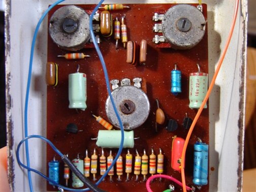

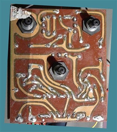

    Hi guys.

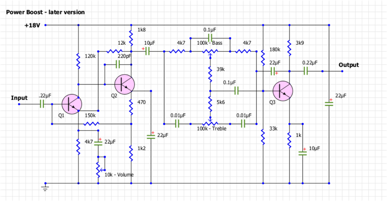

    Thank you all for your help, and comments. I've checked the schematic and that says that the 3 trannies in the circuit are BC169C, BC184C & BC109. However, I'm also working from an original photograph of the circuit and the trannies are ALL BC184L so I'll be going with that. The pin outs are the same on all those transistors I believe so i'll use the 109 from the library and rename it... Simples!! :-)

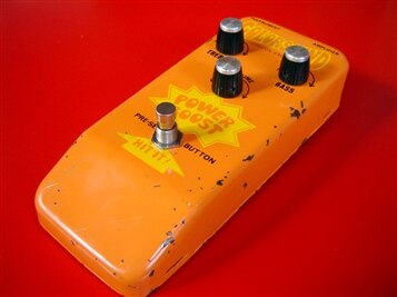

    For your interest, I'm recreating a Colorsound Power Boost version 2. The board will be the same, with board mounted pots, I just need to lay the circuit out in eagle and get the design as close to the trace as possible. I could manually trace the layout from the photo below, but it's a bit messy, and using Eagle to re-draw the circuit and create the board will ensure I don't make any ***-ups along the way as regards the circuit. I'm also sourcing (where practical) original components, so I've just received a delivery of NOS Mullard tropical fish caps the same as in the photo. all resistors are the same, I have however had to compromise with the axial electrolytic caps... I've gone with Vishay caps, a good brand and the same as what's used in the current power boost reissues.
    The photos below show a version 1 power boost, which had an extra 10k resistor which the version 2 didn't have. Apart from that they were identical.

    Groovy! Boost that power, man!
    Made in London, too.
    What does it do to the sound? It looks like it's a just preamp and a tone control. Do the bass and treble cut as well, or is it just boost? Nice colour and love the graphics.
    [In the time I took to write this you've added the schematic and answered my question.]
    The BC184L has the base at one end, the BC109 in the middle. I vaguely seem to remember that there was a non-L version with a different pinout (it's the kind of thing that causes no end of confusion because it's inevitable that eventually somebody doing the buying will get offered a great deal on the wrong part).
    Also, the pins of the BC184 are in-line, whereas those of the BC109 were in a triangular shape. It was quite normal to bend the centre pin out to form the triangle shape when you had an in-line part. We were producing industrial equipment, so we used small plastic formers that the parts sat on and that guided and supported the legs, but this is the cheap and cheerful end of the market and you can see they've just stuffed the transistors in any old how.
    Do the BC184s have a letter at the end? Either BC184LB or BC184LC? The manufacturers grade transistors and offer them in a narrower range of gains than you'd get if you just had them from the end of the production line. If it has C parts, you probably want to match it - that was the higher gain bucket and they wouldn't have paid the extra if they didn't need them for the circuit operation.

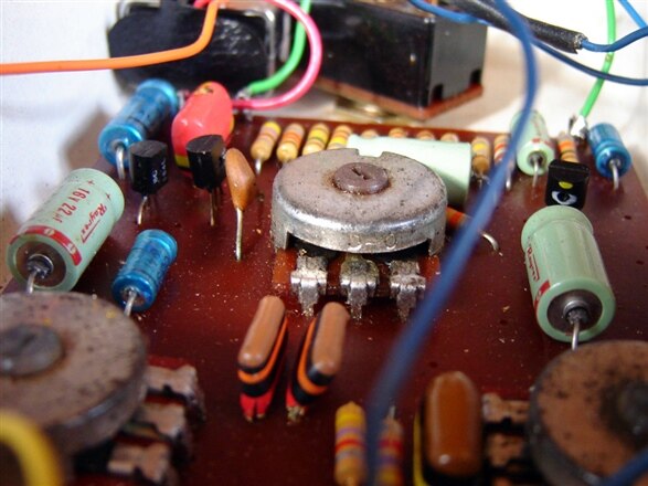

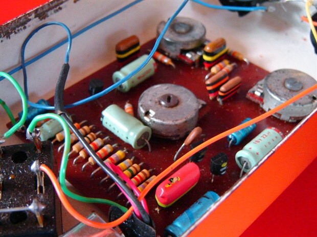

    The guy that owns that particular power boost has told me that ALL the transistors are BC184L's.
    Also the axial caps are 22uf (The big ones), however the actual powerboost has different smaller axial caps than the schematic... the owner has listed the caps as follows:
    "the small blue caps are 6.4µF, the small green one is probably a 4.7µF and the large green one is a 22µF." However the schematic lists them as 220pf & 10uf......
    As regards the sound. it is a pre-amp, with a treble and bass boost... It's only when you get to about 3/4 on the volume knob does it start to break up into an overdrive. Used extensively by David Gilmour throughout the 70's with a fuzz box, he used the power boost and a big muff fuzz for the classic comfortably numb solo. he also used it on the Animals album and on the solos in Shine on.
    Any help with identifying caps and stuff would be greatly appreciated.
    here's more pics

    Overdrive? That's when the signal slams into BOTH rails, is it? Does that mean that the track title "Interstellar Overdrive" was a guitarist's joke?
    The values on your schematic look reasonably sensible to me. It's a high impedance input, so the small capacitor there is alright (in a hi-fi preamp, with a 10k input, you'd expect to see something more like 10uF or 22uF to get the response down to 20Hz). The low frequency roll-off at the input is from a filter formed by the cap and the input impedance - as the impedance goes up , the cap can come down in value for the same cut-off frequency. The 220p from the collector to the base of Q2 rolls off the high response (above 20kHz, so beyond hearing). It might be necessary for stability - to stop the preamp oscillating - or might be there to try and stop it receiving mediumwave radio stations. It looks like a very small value but it gets magnified by the transistor's gain. Couldn't say whether the tone control capacitors look right.
    The Mullard caps have the value as a 3-band (digit, digit, multiplier) colour code running down from the top. Here are photographs of 10nF, 100nF, and 220nF. You'll see the 220nF (red[2],red[2],yellow[4 zeroes]) has the two red bands running together and forming one fat band.
    I seem to remember that the other bands are voltage and tolerance. Can't remember how they go, though.
    The 220pf capacitor is the brown disc between the potentiometer in the centre and one of the transistors. It's called a disc ceramic. Might just have 220 written on it, or something like that. They come with different dielectrics [the ceramic insulator that goes between the plates]. They have different properties, temperature stability etc, but I wouldn't have thought any of that matters to you for this.
    For the electrolytics, make sure that the working voltage is high enough. Designers vary in how much of an overhead they give themselves. It's probably good to have at least 1.5x, and 2x if you can. The one across the supply will need to be 25V or 35V. The others could be less, depending on what they are doing in the circuit.
    How are the potentiometers labelled? There are two main track types linear and logarithmic. [The log track is tapered.] Log types are often used as volume controls because of the way the response then is similar to how we hear different sound intensities. I should think the bass and treble controls are linear. The 'volume' might be either [because it's a guitar effect and not an amplifier as such]. Sorry to be a bit vague, here - I'm not an audio designer. Here are pictures of old log and lin pots to give you an idea.
