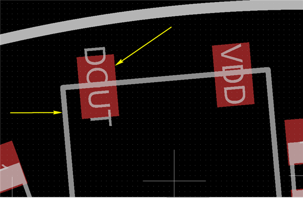

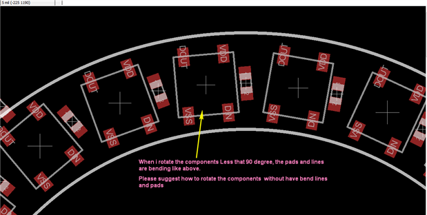

I have query on Rotate the components with circular board. I can rotate the component 90 degree rotation without any issue, i need to rotate the components 10 or 20 degree. when i rotate 10 ro 20 degree, iam getting lines and pads are creating like are bending like below. i would like to know how to rotate the component with component origin (component origin also should rotate) to avoid bending.

    Hello,
    I do not exactly understand what you would like to have changed.
    The "bended" lines are a matter of the graphics display. In reality on the board there will be proper drawn lines (depending on the resolution of the plotting device).
    Regards,
    Richard

    0 e14 Contributor over 12 years ago in reply to Richard_H
    Hi Richard,
    I Mentioned that there is a zigzagged pads also got zigzagged lines, You mentioned "reality on the board there will be proper drawn lines", How i came to know that this will Really draw proper lines, is there any way to view this.
