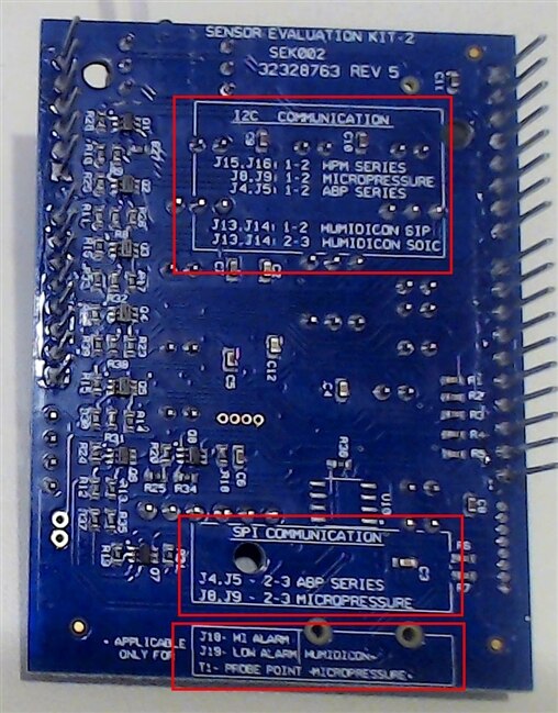

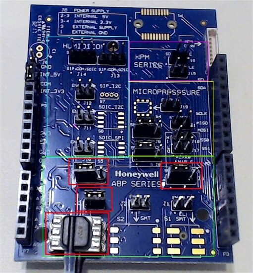

As is shown in the top level image of the SEK002, the board is separated in 4 blocks: ABP Series Sensors, Micropressure Sensors (MPR), Humidicon Sensors, and HPM Series sensors.
In the bottom left of the image, there is a ABPDRRT005PG2A5 Pressure Sensor Amplified installed at S3 which is the initial sensor tested in this blog post.
To enable communication to this sensor, a jumper has been placed at J3, and to enable the I2C interface to the sensor jumpers have been placed on the left side of J4 and J5.
The bottom side of the SEK002 board has the Jumper settings to enable the I2C Communication for the HPM Series, ABP Series and Micropressue sensors as well as for the Humidicon SIP and SOIC options. Also, the SPI Communication for the ABP Series and Micropressure sensors is shown.

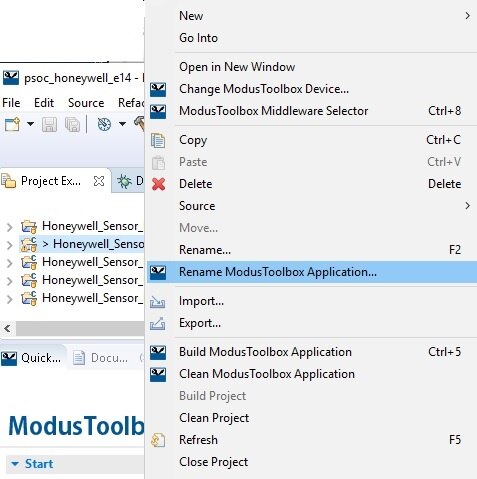

To change the name of a starter project, ModusToolbox has an option available when right clicking on the 'mainapp' part of the project and selecting Rename ModusToolbox Application which will rename all of the files and folders to the new name.

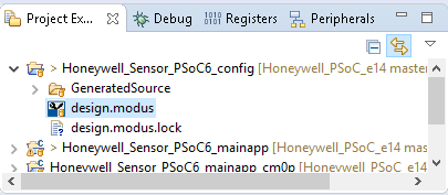

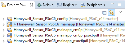

The typical ModusToolbox starter project has 5 parts that make up the complete project.
  • Honeywell_Sensor_PSoC6_config - Contains the Design Configurator file design.modus
  • Honeywell_Sensor_PSoC6_mainapp - Contains config files specific for the Cortex M4 core
  • Honeywell_Sensor_PSoC6_mainapp_cm0p - Contains files specific for the Cortex M0 Plus core
  • Honeywell_Sensor_PSoC6_mainapp_cm0p_psoc6pdl - Contains the M0 plus PDL files
  • Honeywell_Sensor_PSoC6_psoc6pdl - Contains the M4 PDL files

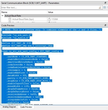

    • Serial Communication Block

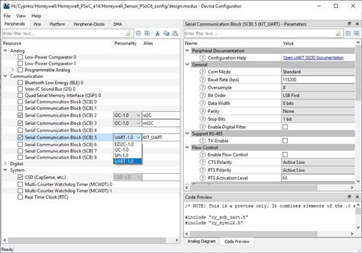

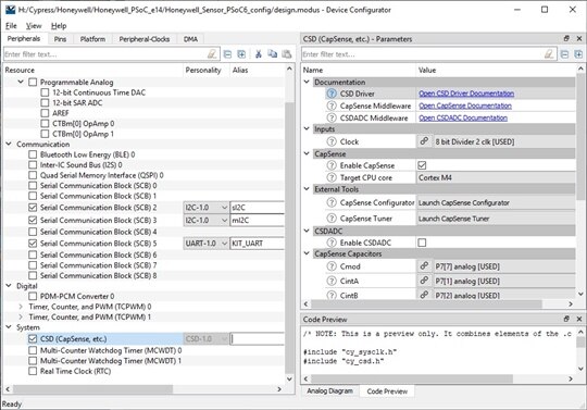

               The Serial Communication Block (SCB) from the Device Configurator can be used to quickly configure either a
                EZI2C, I2C, SPI or UART interface.  The Device Configurator is accessed by double clicking on the
                'design.modus' file under the config project folder.

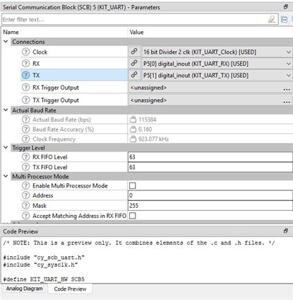

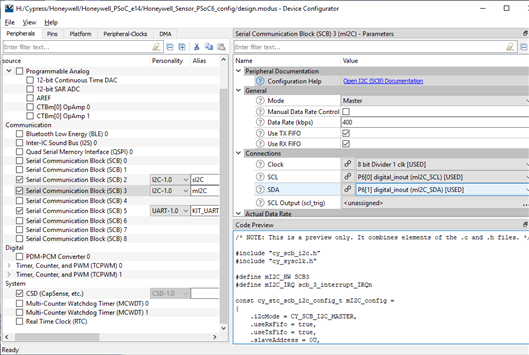

                Once the Device Configurator window opens, the SBC configuration is found under the Peripherals tab.
           Since the I2C Master starter project was used, both a Master and Slave I2C SBC still exist.
           However, the Master interface was moved to SBC 3 since this is tied to the main I2C interface on the
           Arduino headers and thus the I2c interface used to communicated with the sensors.
            Port 6 Pin 0 - Master SCL
            Port 6 Pin 1 - Master SDA

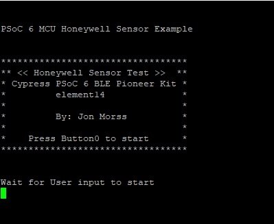

                 If the slave status is true, then the RED RGB Led will be lit and the Pump motor is turned on.

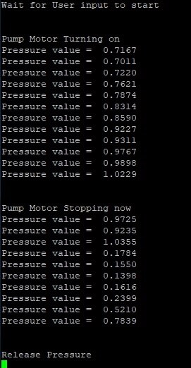

    • Read Sensor Value
                 Then the sensor is read using the I2C Master Write interface. While the converted sensor value is less then 1,
                 the program will loop and read the sensor again until the value '1.00' is reached.  The Pump motor is then turned off
                 and delays to normalize the reading.  The Red RGB Led will blink while the sensor is being read.
while (pressureValue < 1.0)
    if (TRANSFER_CMPLT == readPressure(tmpBuffer, TMP_PACKET_SIZE, &pressureValue))
    UpdateLEDs(&ledStates[RGB_RED]);
    DEBUG_PRINTF("Pressure value =  %2.4f \r\n", pressureValue);
    if (BUTTON1_TOUCHED == getTouch())
       break;
    Cy_SysLib_Delay(RUN_PUMP_DELAY);
    DEBUG_PRINTF("\r\n\nPump Motor Stopping now \r\n");
    gpioState(&ledStates[RGB_RED], LED_OFF);
    gpioState(&gpioStates[GPIO_MOTOR], OFF);

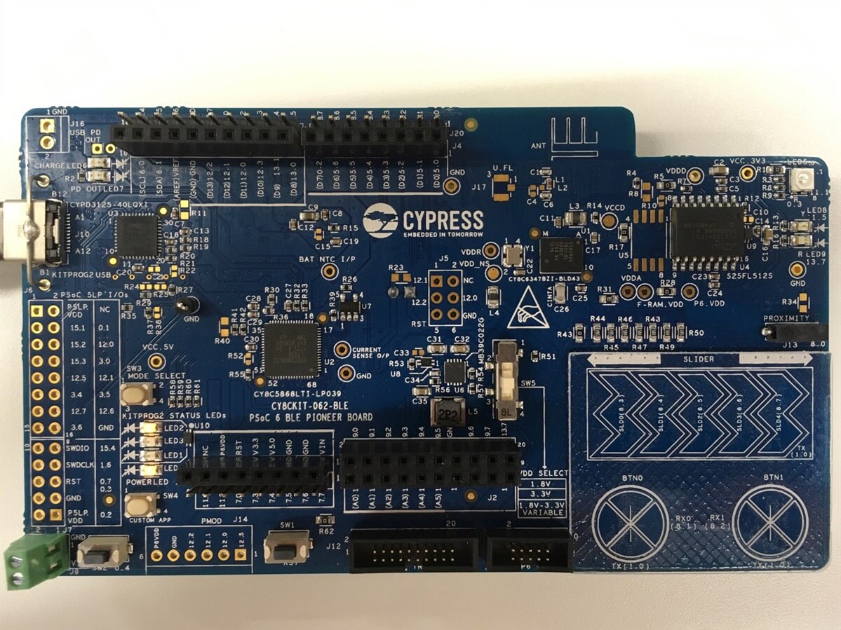

         For user input, the CapSense interface was added to the project. The CapSense interface on the CY8CKIT-062-BLE
         includes a Slider, 2 Buttons as a presence sensor. Only the 2 Buttons were used for the testing of the sensor at this time.

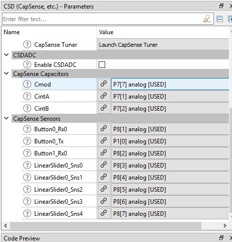

               To add CapSense to a ModusToolbox project, the first step is to enable the CapSense Peripherals System option
               from Device Configurator.

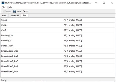

Once CapSense is enabled, multiple pins must be enabled and configured.
        In this instance, the CSX Sensing Mode is used with the following pin mapping.
NamePort[Pin]
CmodP7[7]
CintAP7[1]
CintBP7[2]
Button0_Rx0P8[1]
Button0_TxP1[0]
Button1_Rx0P8[2]
LinearSlider0_Sns0P8[3]
LinearSlider0_Sns1P8[4]
LinearSlider0_Sns2P8[5]
LinearSlider0_Sns3P8[6]
LinearSlider0_Sns4P8[7]

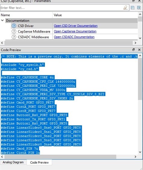

              From the Device Configurator, this will look like the following.

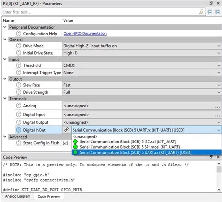

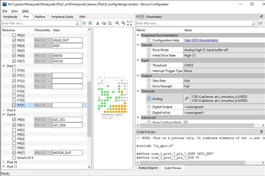

               From the Pins tab in the Device Configurator, the individual pins can be configured.
               Note where the P7[7] Terminals are set to  CSD CapSense amuxbus_a and amuxbus_b.

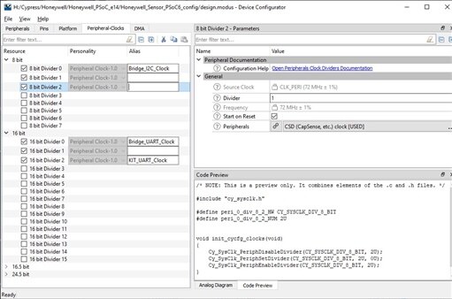

              A Clock will have to be enabled and configure for CapSense functionality which can be added
             from the Peripheral Clocks tab.  The 8-bit Divider 2 was added for CapSense.

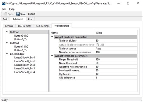

    • Button Config

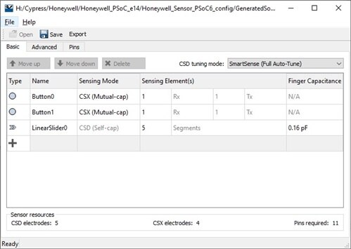

              Going back the Peripherals tab, the ModusToolbox also includes a CapSense Configurator
              and CapSense Tuner to fine tune the CapSense configuration. These are added as
              separate tool that can be launch from command line, but in ModusToolbox these have separate
              Launch selections under External Tools.  Selecting Launch CapSense Configurator will
              open the CapSense Configuator tool.
         From the BasicTab in the CapSense Configurator window, the CapSense devices can be added
         and the Sensing mode set.
         Here Button0 Button1 and LinearSlider0 have been added.  The Buttons have the Sensing Mode
         to CSX (Mutual-cap) where the Buttons can share the cap config.
         From the Advanced Tab, the Widget Details can be accessed where the device settings can be fine
         tuned and each port can be individually configured.
        The Pins Tab will display the Signal and Port/Pin Mappings.
         Once the settings are complete, clicking Save will save the config data and update the necessary
         project files.  This can be seen from the Code Preview window under Peripherals.

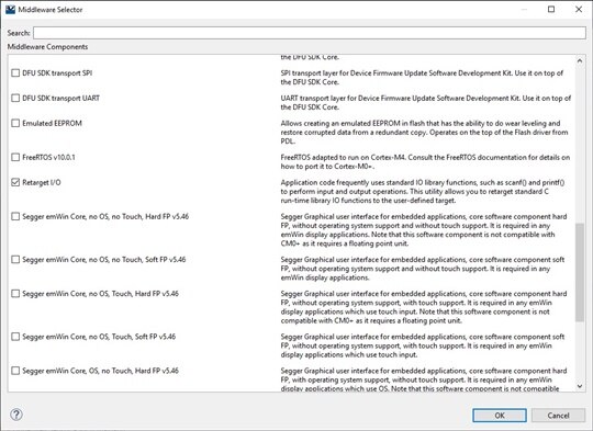

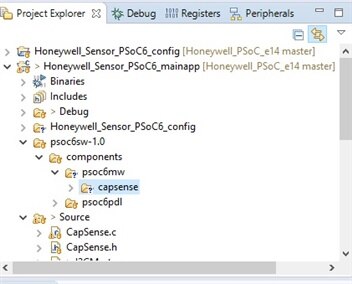

           The required libraries to support the CapSense Interface can either be added manually or via the
            ModusToolbox Middleware Selector by right clicking on the mainapp folder.  Here the capsense library
            was added to the mainapp folder psoc6sw-1,0->components->psoc6mw.

 /* Process all widgets and read touch information */
 Cy_CapSense_ProcessAllWidgets(&cy_capsense_context);
 gestureStatus = Cy_CapSense_DecodeWidgetGestures(
 CY_CAPSENSE_LINEARSLIDER0_WDGT_ID, &cy_capsense_context);
 /* Button0 is active */
 if (Cy_CapSense_IsWidgetActive(CY_CAPSENSE_BUTTON0_WDGT_ID,
 &cy_capsense_context)) {
     currentTouchData = BUTTON0_TOUCHED;

    • ModusToolbox Middleware Selector
      • Retarget I/O
            To enable the Debug UART on the CY8CKIT-062-BLE, the Retarget I/O Middleware software must be added.
            This is done by right clicking on the mainapp project folder and selecting the ModusToolbox Middleware Selector
            option.  This adds the Retarget I/O library files 'stdio_user.h' and stdio_user.c' to the project files.
            Retarget I/O provides a means to send standard I/O commands such as 'printf' out a user defined Target such as the Debug UART
            From the Middleware Selector window, ensure the checkbox for Retarget I/O is selected.

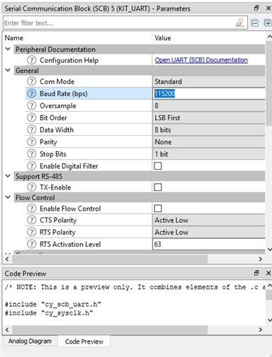

    • UART SBC
                To enable the SBC UART for the Debug port (KIT_UART), open Device Configurator and
                 enable a SBC set to UART-1.0.  SBC 5 was used in this instance.
                 From the Parameters pane, the UART Baud Rate, Comm Mode, etc can be set.
                  Also from the Parameters pane, the PIn mapping for Tx and Rx can be set as well as the
                 appropriate clock.
NameConnect
Clock16 bit Divider 2 clk
RXP5[0]
TXP5[1]
                    The UART SBC can be assigned to the Tx and Rx from the Parameter pane.
                  Once the Debug UART has been configured, the code preview for the SBC can be viewed
                  from the Parameters tab.

         To send a string or data to the Debug serial port, the DEBUG_PRINTF macro is used.
UART_DEBUG_START();
DEBUG_PRINTF("\r\n\nWait for User input to start \r\n");
     DEBUG Uart output example:
   Debug output while reading pressure sensor

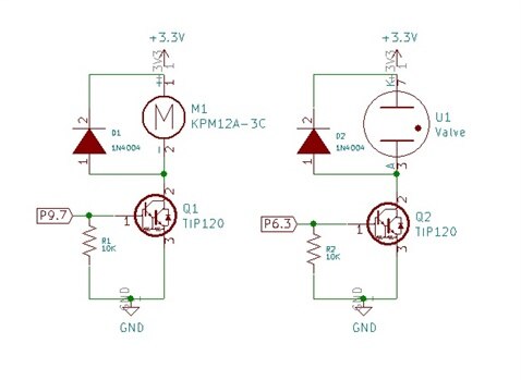

        To test the pressure sensor capabilities, a Mini Pump and Solenoid Valve along with a modified manual
       Sphygmomanometer were used.
Mini Air Pump Motor Model : KPM12A
YOOTOP 2Pcs DC3V Mini Air Pumping Motor Tank Oxygen Circulate Pump Replacement Accessories for Aquarium DIY Projects
Solenoid Electromagnet Valve
Uxcell a14010700ux0271 Uxcell
       A circuit board to power the Pump and Valve was created using 2 TIP120 transistors.
          The following Pin Mapping were used to control the Motor, Valve and RGB LEDs.
NamePort[Pin]
VALVE_OUTP6[3]
MOTOR_OUTP9[7]
RGB_REDP0[3]
RGB_GRENP1[1]
RGB_BLUEP11[1]
         To enable the configurator devices, the  'init_cycfg_all' function is called.
init_cycfg_all();
