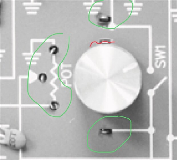

hello would like to learn how to measure components on my elenco am radio kit.
am new to electronics, trying to figure things out.
read about lissajous patterns, just need some direction as to how to set up my connections, see if components are functioning as necessary.
my 9 volt battery gets hot, no audio output,so  i think i have short somewhere?
thanks
john

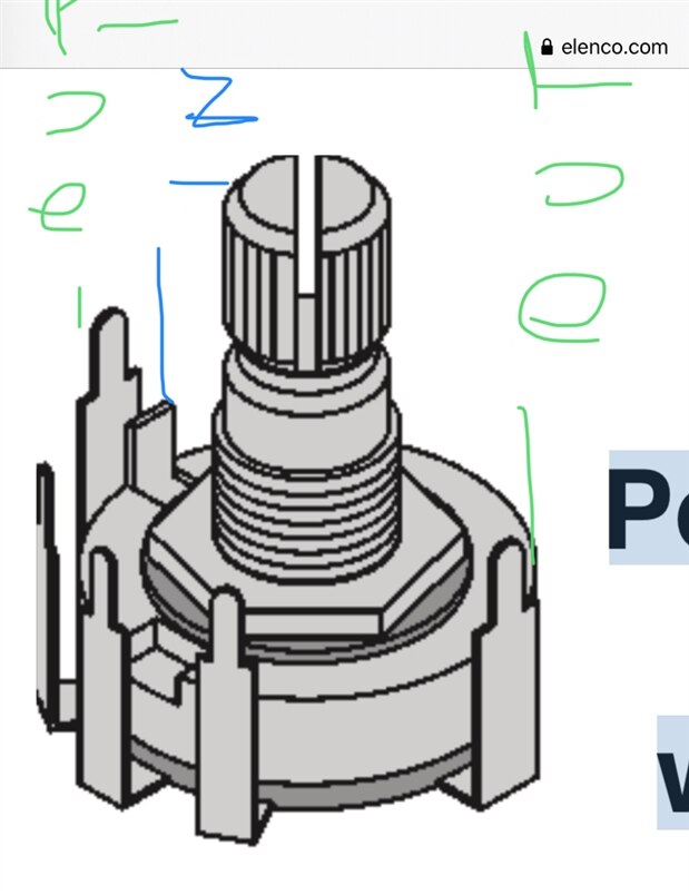

    Looking at the potentiometer, it seems that it has been inserted from the wrong side (inserted from above instead of pushed in from the underside).. The movable switch part looks forced (blue), and the…

    I think that the second pin of the switch is soldered to the wrong hole:

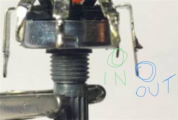

    With my vom one of the pins was bent toward the housing of the switch, should be separate and part,so i have created a short.
    gonna straighten things out and repost some images.
    john
    • Reject Answer
    0 shabaz over 6 years ago in reply to Jan Cumps
    The pins that are southbound in that photo snippet belong to a couple of capacitors, connected to ground : ( And that's the same copper area near the switch. Hot battery issue root cause solved I guess!

    one of the wiper pins is physically touching the base of switch,vom shows low resistance, almost like a short.

    Taking off the switch is not easy, once the pins are soldered. It may be easier to try and desolder only that one that's mounted in the wrong hole, and place it in the correct hole.
    If you can't get it out, clip it as close to the PCB as you can, then use some wire to bridge the gap.
    It will impact the strength of the construction though. The 2 switch contacts also play a role to keep the potentiometer from twisting in place ...

    0 johnwater over 6 years ago in reply to johnwater
    took switch off, looked at connection points.
    still not sure that what is circled in blue is correct slot.
    i think these boards are made generic for other radios as wetland that slot seems to be  way off to the side.
    took pics of top and bottom of board.
    definitely had a part of pot on /off blade touching the base of pots i unbent it and straightened it out.
    gonna desolder everything and get back to u all.
    slot i circled in red appears to need to stay open, it just would be too outside the pot pins, may be for some other project.image

    Hi John,
    The switch terminal cannot go in the nearer slot, because that area of copper connects to ground, you can follow it to the negative terminals of capacitors for example, and if the switch is connected to ground, that's a short to ground.
    I agree it's confusing, but that nearer slot is likely for a different potentiometer/switch, where perhaps the shell has a locating peg that could be soldered there.

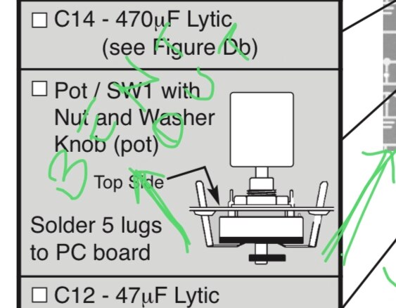

    Yes, it has to go in the outer hole, sharing the copper trace with C14+ and jumper J1. The closer hole is for potentiometers that have a small hook on the housing to keep them oriented correctly.
    In the instruction manual, you can see that the 2 switch pins are bent outward.
