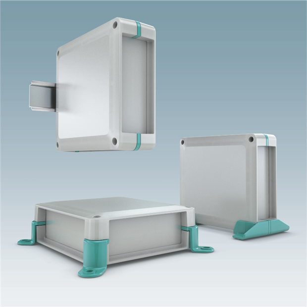

    garynelson over 6 years ago in reply to shabaz
    Hi Shabaz,
    Thanks for sharing your design I always enjoy seeing how people have used our products in their projects and designs as they are always so varied!
    I'm pleased you were happy with the RPI-BC enclosure as this was our first major step into brining Raspberry Pi's into the industrial marketplace and the results have been staggering. As you can imagine when designing it we used an existing product from our BC range and modified it to ensure easy access could be achieved to the ports on the Raspberry Pi and be expandable.
    In answer to your question we have a new range of enclosure products called UCS and within this range we have created a number of Raspberry Pi versions. The real beauty of this range is all 4 sides are flat, so easy to mill and drill, and top and bottom are identical making it far easier to modify them with printing or again milling. The range includes a number of mounting accessories enabling wall, desktop or DIN rail mounting.
    The UCS -RPI ranges already have pre-milled sides for access to the ports and was originally launched in 2 sizes and 2 colours. When the new 4B came out we redesigned the enclosure milling to suit the new layout so we now have those available as well. The last addition to the range for Raspberry Pi's is a larger case with pre-milled sides for the ports and a pre-milled top to accommodate the official 7" touchscreen enabling you to create home media controllers, industrial low cost HMI's or, in my case, an arcade machine!
    Here's a couple of images of the products and I've listed our part numbers which should help you to find them on the Farnell website. The only ones currently not available on there are the new ones for the Raspberry Pi 4B as these only came out this year so are available but not yet in the Farnell portfolio. It's also worth noting that the display case is currently only available for the 3B/3B+ products.
    I hope this helps for your next design and thanks for using Phoenix Contact products. You'll find the parts list after the images.
    Parts list:-
    Article no.Farnell pt no.TypeDescriptionRaspberry Pi version10197202821862UCS 145-125-F-GD-RPI 9005 Small size in black3B/3B+10197232821863UCS 125-87-F-GD-RPI 9005Larger size in black3B/3B+10197242821864UCS 125-87-F-GD-RPI 7035Small size in grey3B/3B+10197492821865UCS 145-125-F-GD-RPI 7035Larger size in grey3B/3B+11047803226511UCS 237-195-F-GD-RPI-DT7 7035Display case in grey3B/3B+11047813226512UCS 237-195-F-GD-RPI-DT7 9005Display case in black3B/3B+1139227N/AUCS 125-87-F-GD-RPI4B 7035Small size in grey4B1139237N/AUCS 125-87-F-GD-RPI4B 9005Small size in black4B1139240N/AUCS 145-125-F-GD-RPI4B 7035Larger size in grey4B1139242N/AUCS 145-125-F-GD-RPI4B 9005Larger size in black4B
