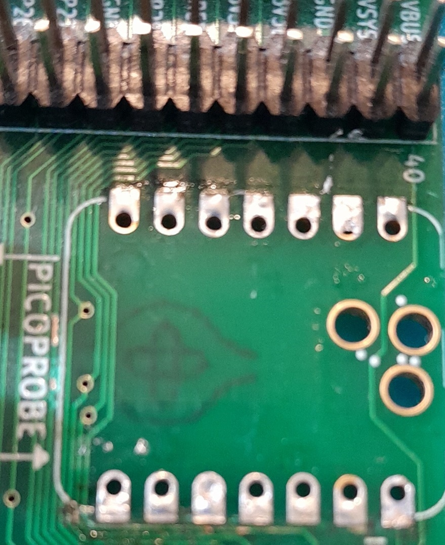

Removing castellated PCBs, once soldered, can be a tricky task. It's not easy to get the solder on all castellations heated up at the same time.
I had to replace the XIAO RP2400 board on my  Pi Pico Eurocard Development Board. Doing this with a high capacity iron, or with hot air isn't easy. By the time you get to pin 14, pin 1 has gone solid again.
You may get away with prying under the board while attacking each castellation, but chances are that you 'll tear off the pads from the motherboard.
One possible solution is to ply a thick copper wire in such a way that it surrounds the PCB and touches all castellations. Then, with a decent iron and a lot of flux, heat up that wire.

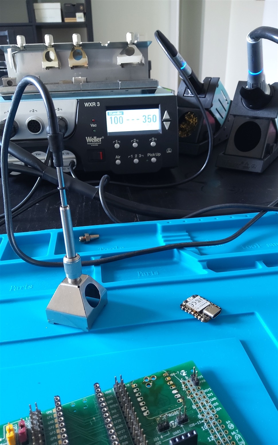

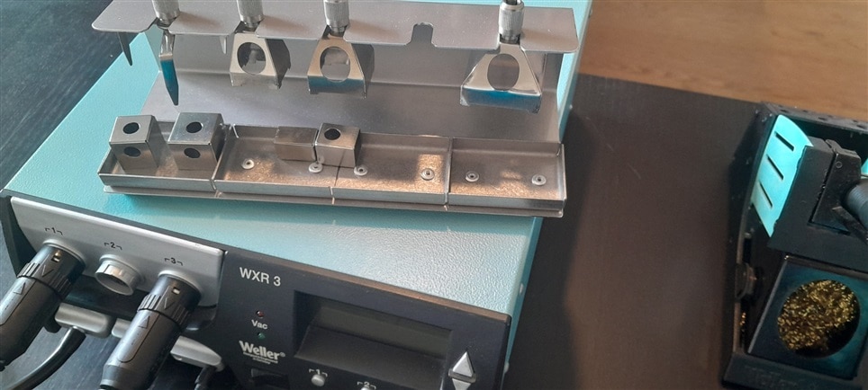

I decided to try removing the IC with a Weller WRK SMD reflow kit.
This kit has little ovens that you can put on top of something. And it has a vacuum-actioned suction cup that you can stick on top of the device that needs to be removed.
When you then put a hot air pencil in the little oven's opening, the inside gets hot very fast. No risk of burning the neighbour components. And very efficient heat usage.
When I tried this at 380° C, the castellated board lifted off in 20-30 seconds. Without any damage.

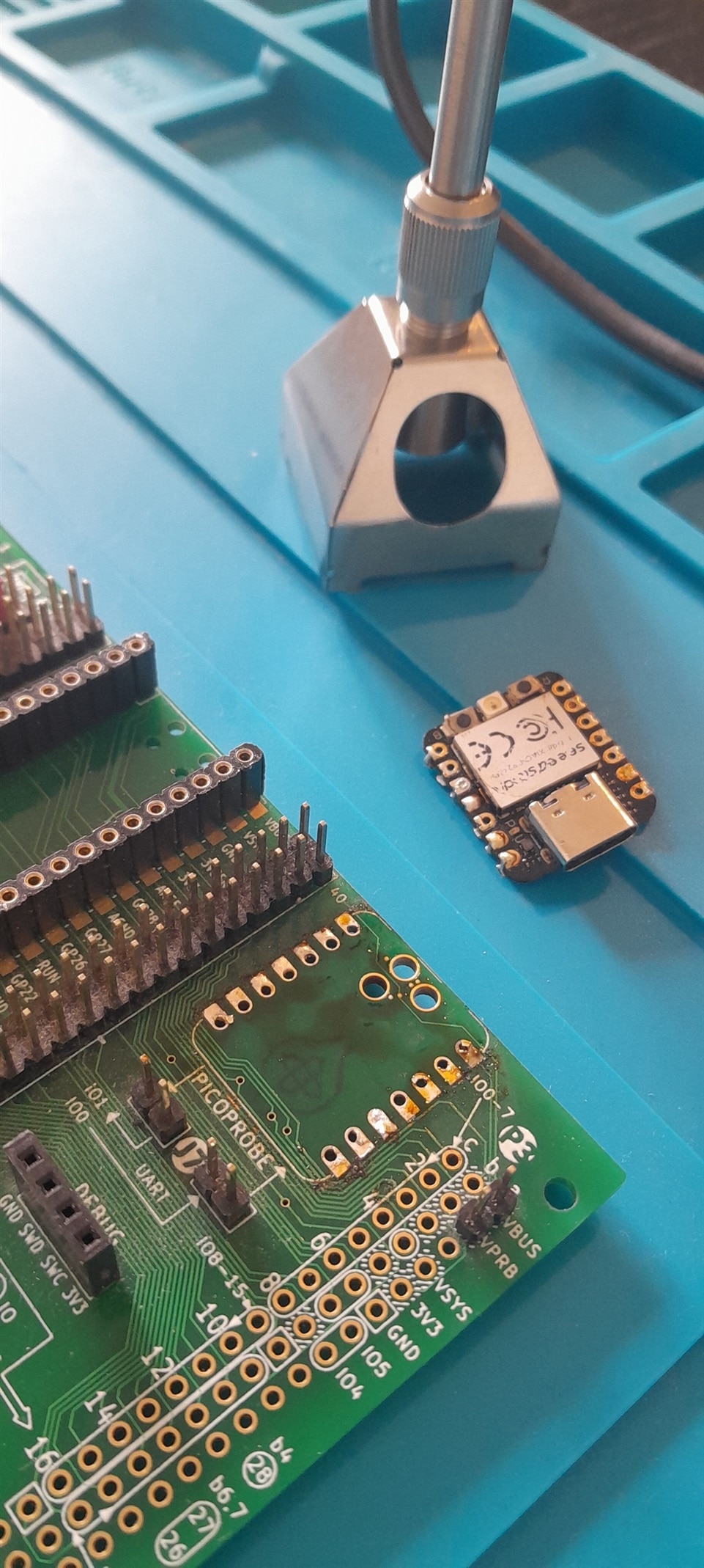

This is the motherboard after the action:
And the castellated board survived too:

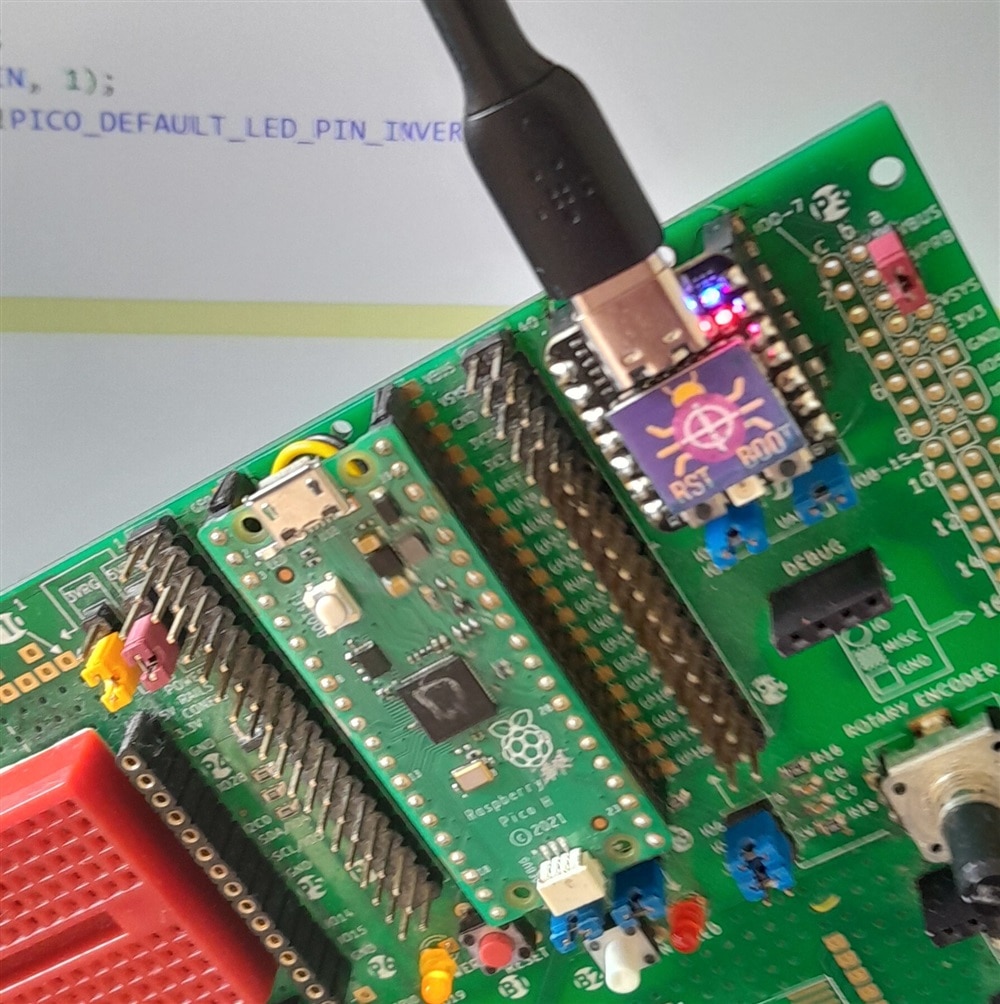

Anyways, after this exercise, I cleaned up the motherboard and put on a new XIAO RP2040.

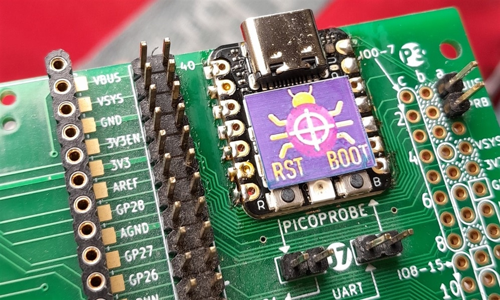

    Jan Cumps over 1 year ago
    another year, another victim Slight smile
    That rework set proves to be helpful. 2nd time that I replace the XIAO debugger on this board, and all the copper pads survived. After the last repair, I used lead-free. So I had to up the temperature a little. I used 350°C.
    This time, I think  I'll place headers instead of soldering the new XIAO direct on the PCB.
  • scottiebabe
    scottiebabe over 1 year ago in reply to Jan Cumps
    Did your XIAO fail?
    Jan Cumps over 1 year ago in reply to scottiebabe
    yes. It's used as a PicoProbe. I made a mistake when connecting both Xiao and Pico to USB, and lost a GPIO
    Back in business. The most difficult part was to transfer shabaz ' debugger sticker without damaging it Slight smile.

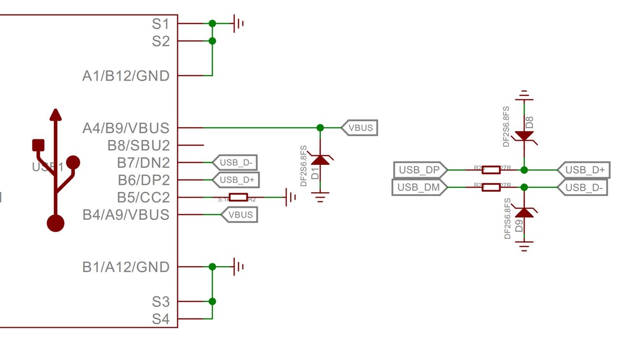

    shabaz over 1 year ago in reply to Jan Cumps
    I was wondering if the Xiao might not have ESD protection on the USB connector, but according to the circuit diagram it does:
    Maybe due to the tiny size of it, minute flexing on the socket could cause a capacitor to crack or something : (
    There's a load of tiny resistors in a line, but there's also a capacitor (C2) which is across the 3.3V rail, so it's possible it could have shorted. It's 0201 sized which is insanely tiny of course : ( If it's possible to pull that part off (it's the second part in that row, see the yellow arrow), if it was indeed faulty then the XIAO might start working perhaps. Anyway this is all just speculation, it might be something completely different. I've never used an 0201 part, all I know is that those small parts (0402 too, which I've experienced this with) are so easy to crack, especially with hot air tools too.
    (btw I looked at a slightly older revision in EAGLE, because I happened to have downloaded the XIAO files in the past, I didn't download the most reccent ones).
