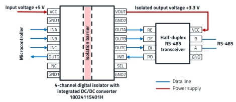

Figure 1: Block diagram of isolated half-duplex RS-485 interface.

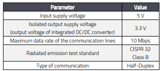

3.1 Key parameters
The board is optimized for a data rate of 10 Mbps and a shielded twisted cable length of 10 m (distance between the transmitter and receiver boards during radiated emission test).
Table 1: Key parameters of isolated RS-485 board.
The integrated DC/DC converter within the digital isolator cannot operate in boost mode therefore the output voltage must be less than or equal to the input voltage (VCC). In the design example the output voltage selection pin (SEL) of the digital isolator is connected to the ground (GND2) for 3.3 V output voltage.

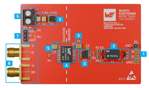

The top view of the application example board is shown in Figure 2. The board can be conditionally divided into 8 blocks:
  1. Pins A and B: non-inverting and inverting bidirectional bus data lines (RS-485 input)
  2. Filter circuit of the data lines and TVS diodes for overvoltage protection
  3. Half-duplex RS-485 transceiver in SOIC-8NB package
  4. 4-channel digital isolator with integrated isolated DC/DC converter
  5. Filter circuit of the DC supply voltage line
  6. Terminal block screw connector for power supply
  7. THT 3-pin header for signals from controller
  8. SMA connectors for RS-485 interface signals*
* The SMA connectors (high-speed connectors) are used for a test signal feed by a signal generator into the PCB. This is a simulation of a single ended board level signal source feeding the signal to the digital isolator.
Figure 2: Top view of the application example board.

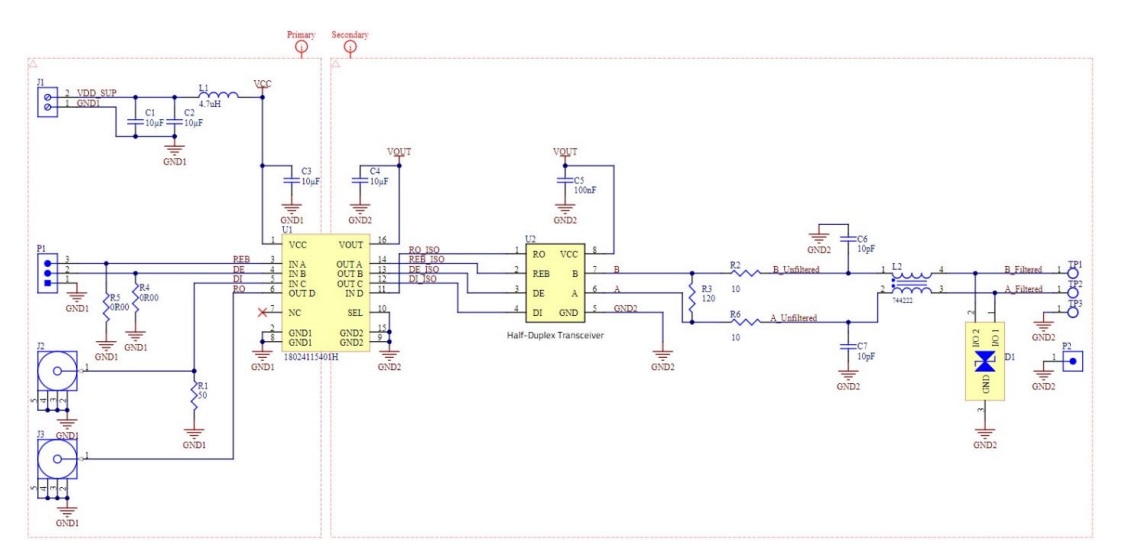

Figure 3 shows the schematic of the transceiver and receiver boards used during the radiated emission test. The differences between the boards are detailed in Section 6.1.
Figure 3: Schematic of isolated half-duplex RS-485 transceiver and receiver boards.

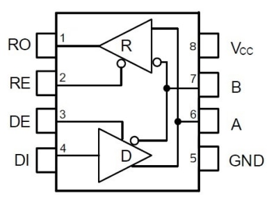

4.2 Half-Duplex RS-485 Transceiver
Half-duplex RS-485 transceivers provide bidirectional communication over a single pair of wires by alternating between transmitting and receiving data. This allows multiple devices to share the same communication line efficiently, reducing the number of required wires and simplifying system design. The design example uses a standard half-duplex RS485 transceiver in the SOIC-8NB package.
Figure 4: Simplified block diagram of non-isolated half-duplex RS-485 transceiver in SOIC-8NB package.

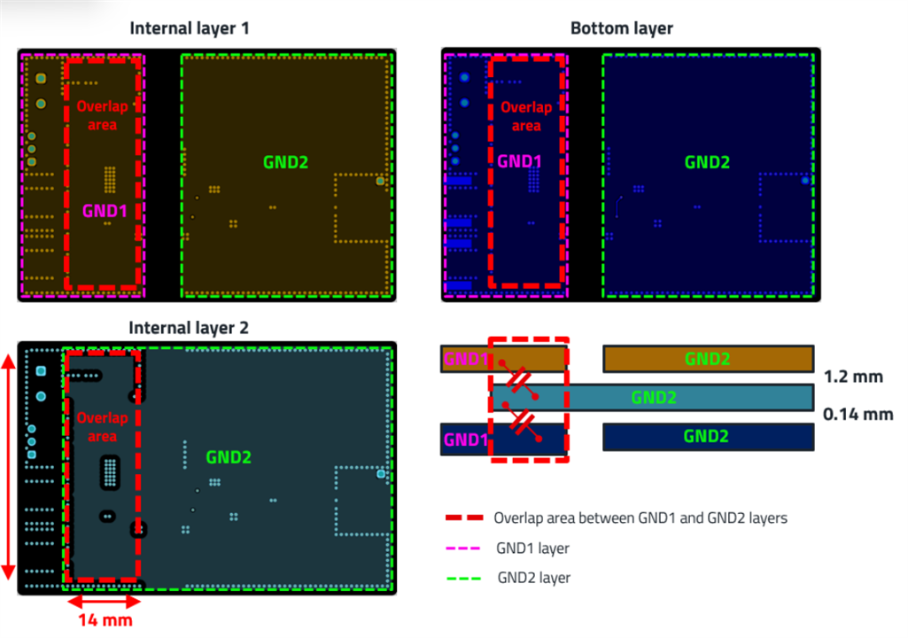

5. REDUCING COMMON-MODE INTERFERENCE WITH OVERLAPPING STITCHING CAPACITANCE
The 18024115401H digital isolator provides galvanic isolation between the input and output of the system, but parasitic coupling capacitance of an isolation barrier allows common mode currents to flow. As a result, the isolator may be a source of common-mode interference. Typically, design engineers address this issue using an external Y-capacitor between the input and output. However, an alternative approach is to utilize the parasitic capacitance between PCB layers as an integrated Y-capacitor. This method, commonly referred to as stitching capacitance, provides an effective high-frequency return path for common-mode noise, reducing EMI without requiring external components.
Careful attention needs to be taken regarding the layout to meet any safety isolation standards. Depending on the targeted safety standard the requirements applying to inner layers for thickness and distance along a cemented joint. The outer layers and any exposed inner layer edges are subject to the creepage and clearance rules. This design example is designed to meet reinforced isolation.

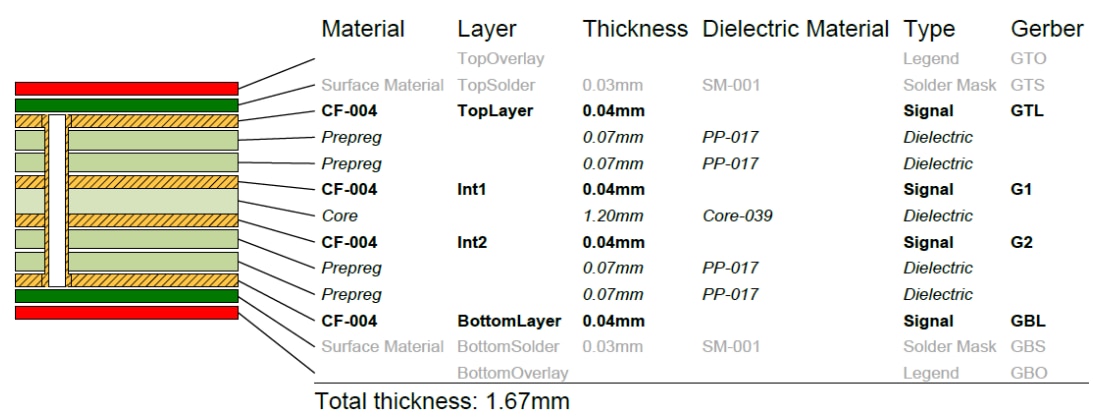

This design example board has a 4-layer PCB structure. The stitching capacitance is formed by the parasitic properties of overlapping copper planes in different PCB layers (between internal layer 1, internal layer 2 and bottom layer). The PCB layers and the overlap that form the stitching capacitance of the board are shown in Figure 5.
Figure 5: Overlap area of isolated RS-485 design example board
Figure 6: Layer stack legend.

  • Overlap area (between GND1 and GND2 layers): 14 x 44 mm2 = 616 mm2;
  • Distance between overlap layers and relative dielectric constant:
    • Internal layer 1 to internal layer 2: 1.2 mm, εr= 4.6;
    • Internal layer 2 to bottom layer: 0.14 mm, εr= 4.
The total stitching capacitance of the PCB is the sum of the capacitances between the two overlapping regions:
image(2)
The approximate stitching capacitance of the design is 177 pF, providing an effective high-frequency return path for common-mode noise and significantly improving EMI performance. Measurements of radiated emissions demonstrate the success of this approach (Figure 9), as the 4-layer board with stitching capacitance remains well below the required limits, proving that this integrated design effectively suppresses common-mode interference. More detailed information about common mode interference and coupling capacitance can be found in Application Note ANS022.

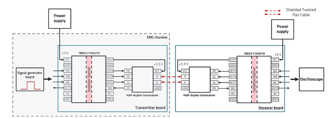

6.1 Test Setup
The test setup for the radiated emission measurement is shown in Figure 7.
The configuration differences between the transmitter and the receiver boards are:
  • The transmitter board: resistors R4 and R5 are not installed.
  • The receiver board: resistors R4 and R5 are installed.

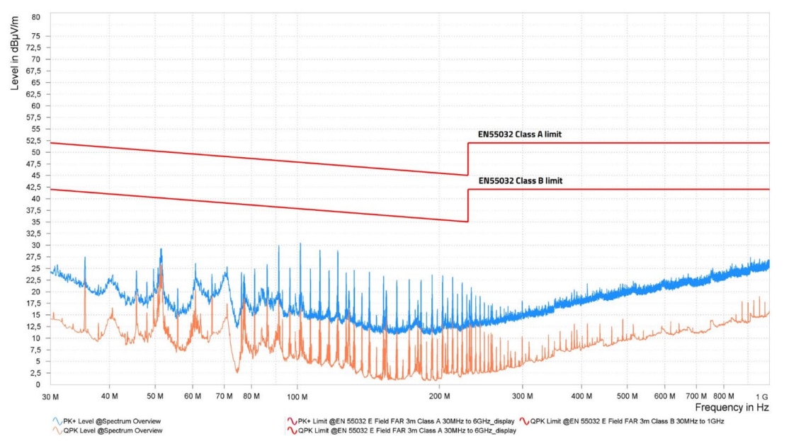

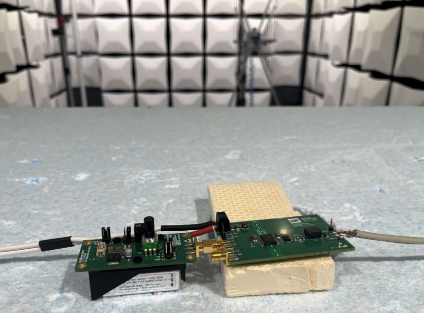

6.2 Radiated Emission
Measurements made with 10 m shielded twisted cable length between transmitter and receiver boards and 10 Mbps data rate.
Figure 8: Transmitter board and signal generator board in EMC test chamber.
Figure 9: Radiated emission (CISPR 32 Class B).

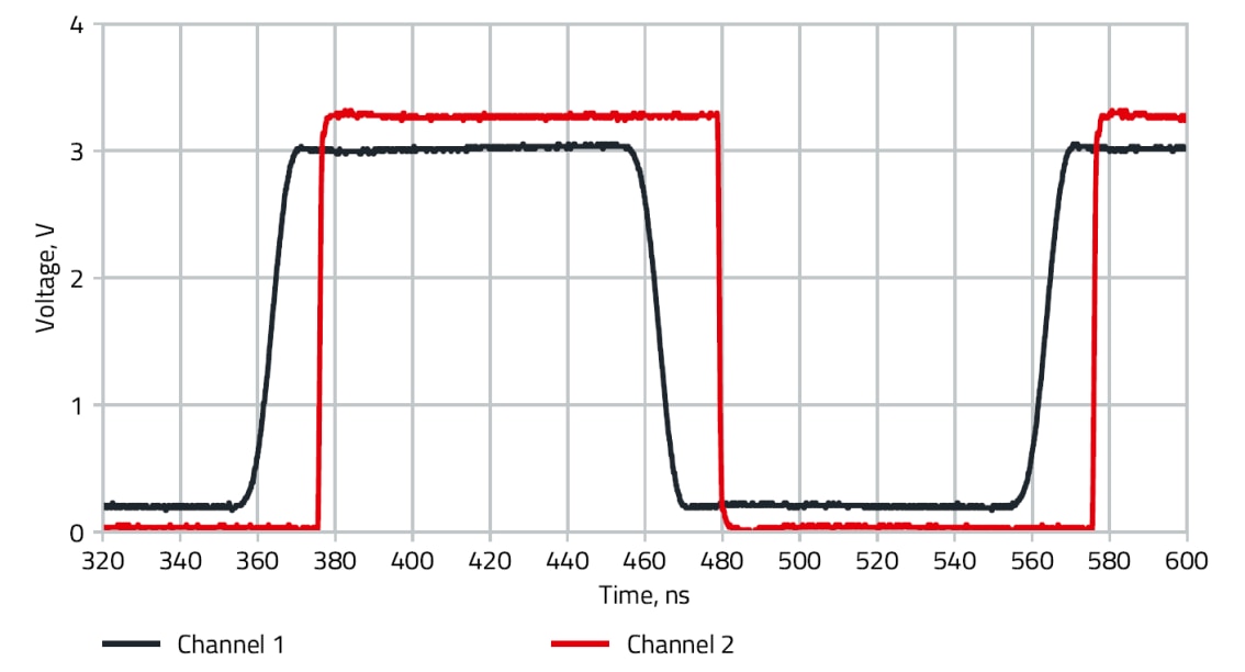

6.3 Propagation Delay
The propagation delay between the input and output signals of the digital isolator is ~15 ns (Figure 10), ensuring fast switching, minimal signal distortion and stable communication via the RS-485 interface.
Figure 10: Propagation delay between input (Channel 1) and output (Channel 2) signals of the digital isolator 18024115401H.
