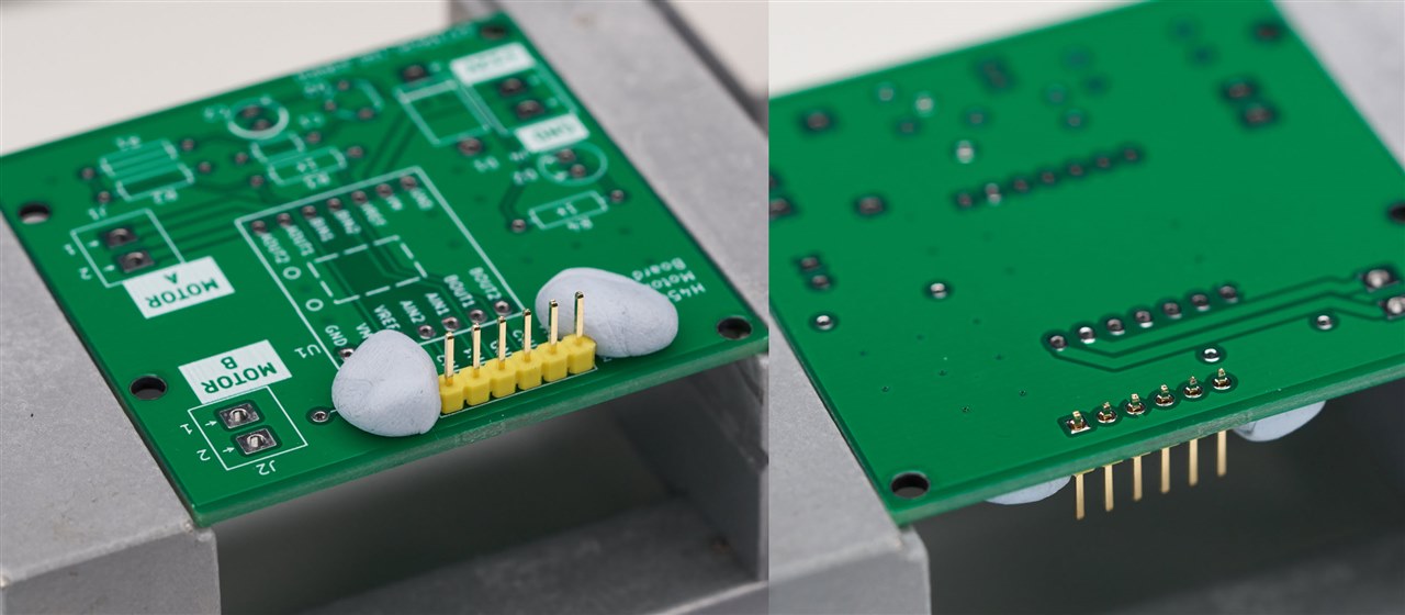

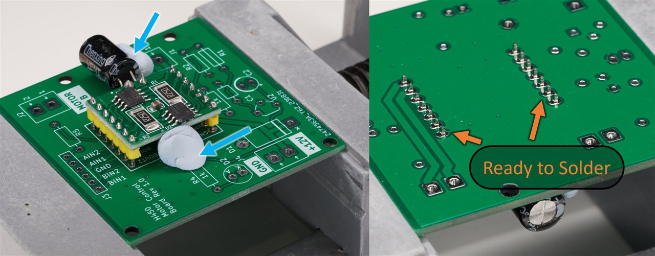

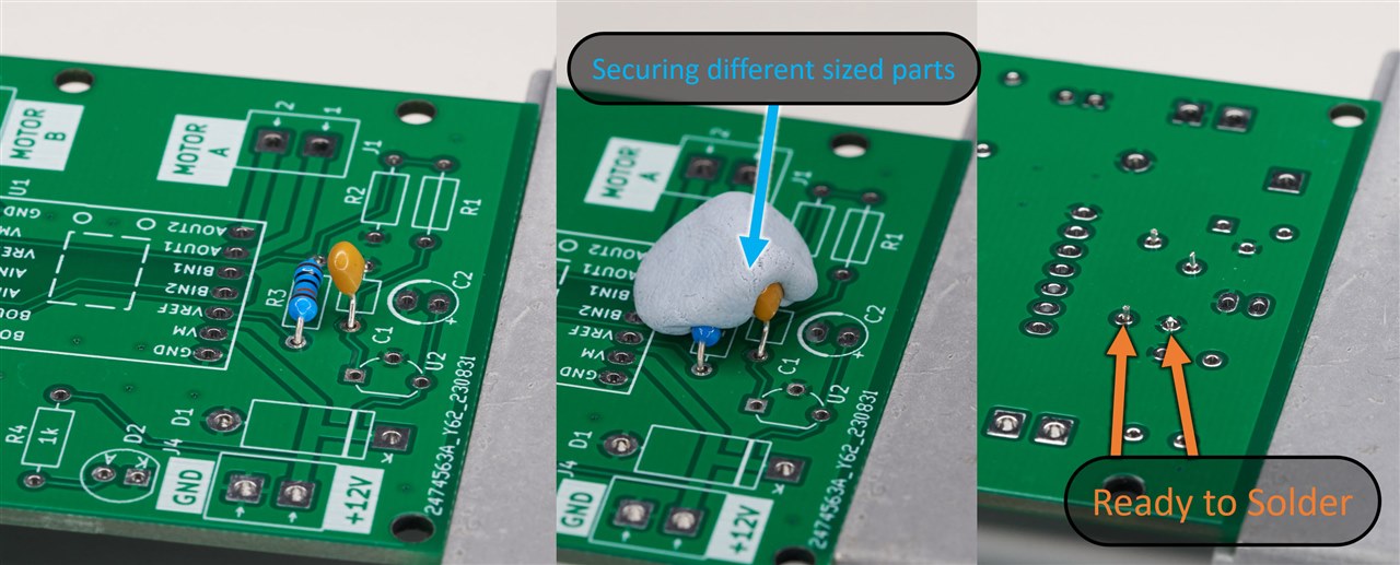

    shabaz over 2 years ago in reply to colporteur
    It is a genius material, so many uses. It comes in a sheet form, between waxed paper. The first time it is used, it just needs to be stretched a bit, and it becomes sticky (without leaving any residue). The properties of blu-tack remain approx. forever, i.e. the material is always reusable and never dries up.
    It can hold multiple parts at once, the photo below shows a couple of parts being held down. It's strong enough that the parts don't move when soldering, and afterwards, it comes off in one piece, with no residue left. If it is in an awkward place, then dabbing it with a larger piece of it will lift it all off.
    I suppose it may leave a micro-film of oil, but probably no more than finger oil. When Blu-Tack is removed, the surface is dry and zero visible residue. Even if it gets hot, nothing seems to happen to it. It's as benign/inert as one could hope for I guess.
    An example of holding a larger module; here the module was deliberately raised off the board slightly, just to demonstrate that Blu-Tack holds the item in a controlled fashion, and doesn't sag/slip in normal use:
    It's super-useful for pin headers, LEDs, large capacitors, etc., it holds them all in vertical alignment!:
    I also use it for holding down ICs too, connectors, pretty much anything.
