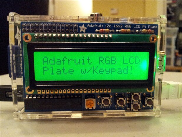

I'm quite excited about Adafruit's new RGB LCD + Keypad Pi Plate which:
lets you control a 16x2 Character LCD, up to 3 backlight pins AND 5 keypad pins using only the two I2C pins on the R-Pi! The best part is you don't really lose those two pins either, since you can stick i2c-based sensors, RTCs, etc and have them share the I2C bus. This is a super slick way to add a display without all the wiring hassle.
The kit is offered with 3 different LCD options:
RGB Positive 16x2 LCD   (colored background; this is the model I assembled and pictured here)
RGB Negative 16x2 LCD (colored text)
Blue & White 16x2 LCD
Any of the above models are:
perfect for when you want to build a stand-alone project with its own user interface. The 4 directional buttons plus select button allows basic control without having to attach a bulky computer.

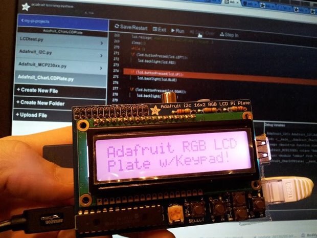

Here's the demo program which displays text on the LCD and then changes the backlight color according to which button is pressed:
Unfortunately, it was hard for me to capture all the colors accurately with my smartphone camera.  In person, the contrast is better and backlight color is truer.  Here's another demo program which cycles through the different backlight colors:

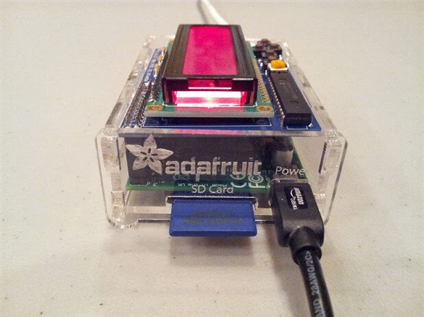

The Raspberry Pi and the LCD Plate are inside the Adafruit Pi Box in "convertible" mode (the top of the Pi Box is removed).  Here's a side profile of the Pi Plate to give a sense of its height:

I'm using Adafruit's execellent WebIDE for the Raspberry Pi (shown below), so my files are automatically committed to my BitBucket repository
