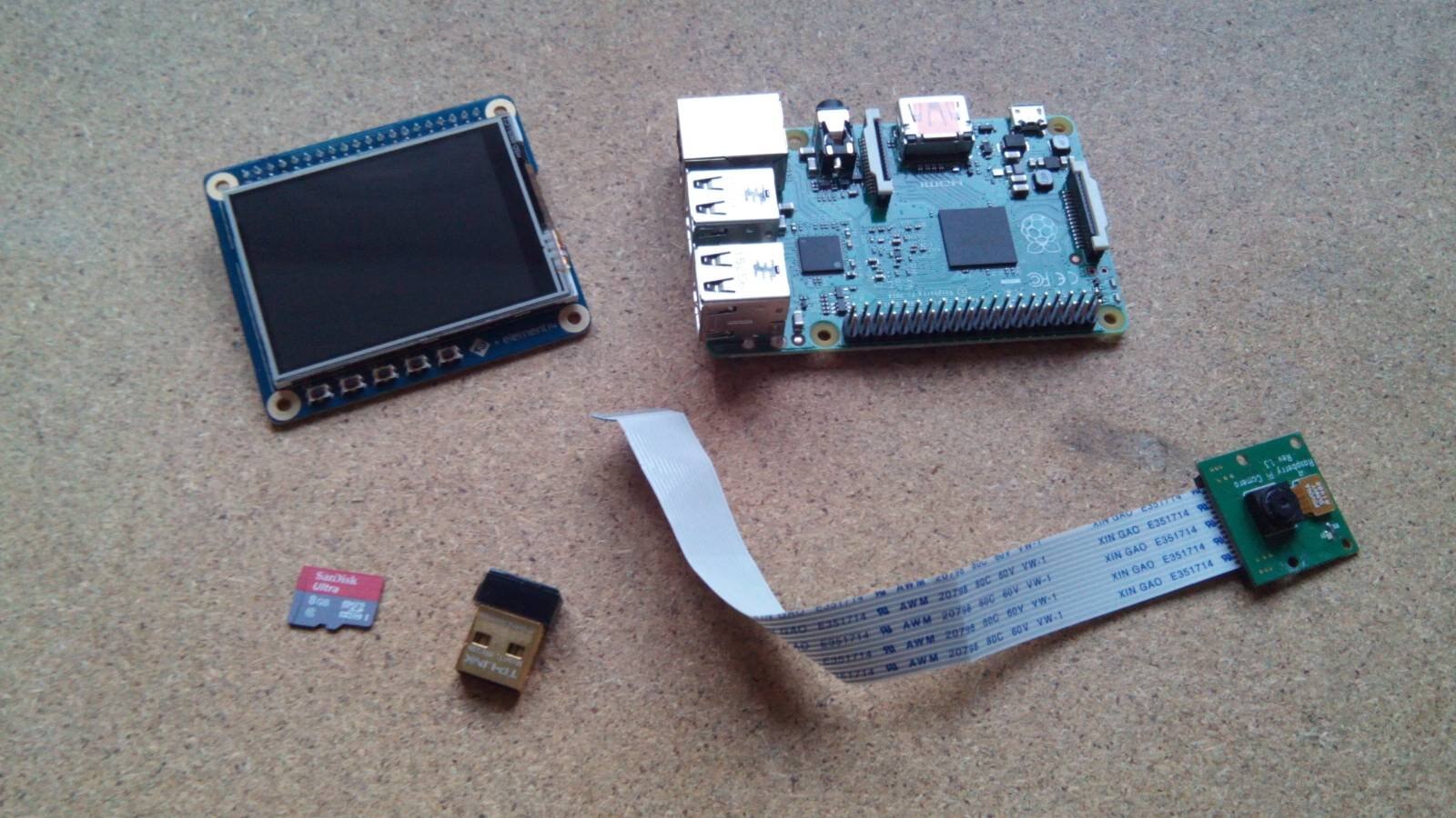

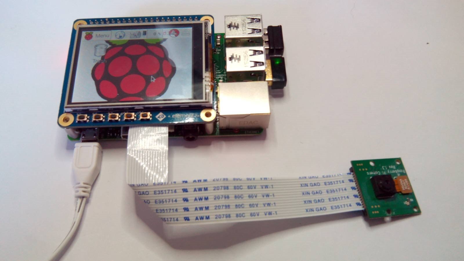

In this fourth article of the series Essential Raspberry Pi Peripherals we will see how to install the Pi Camera and the 2.4" Touch Panel on the Raspberry PI 2 . In the next article we will use this base setup to make a PI Camera where the PiFace CAD LCD display is be replaced by the 2.4" Touch Panel.
The components we are using are shown in the image below including a small and almost inexpensive (about 5$) LinkSys WiFi USB dongle and a class 10 8Gb Micro SD card.
Note: if you have only one of the two devices you can follow this guide excluding the parts that refers to the other (the camera or the touch panel) alternatively.

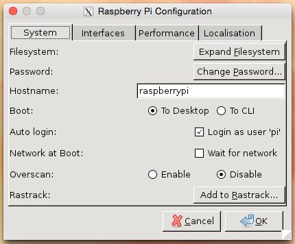

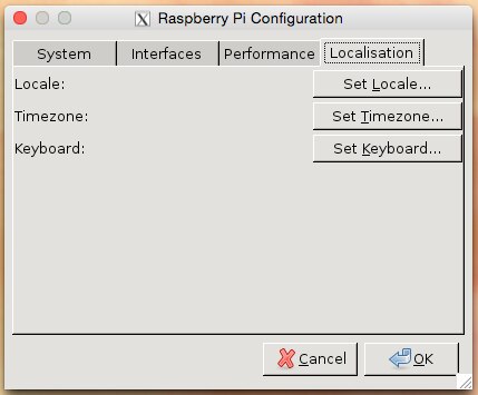

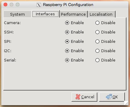

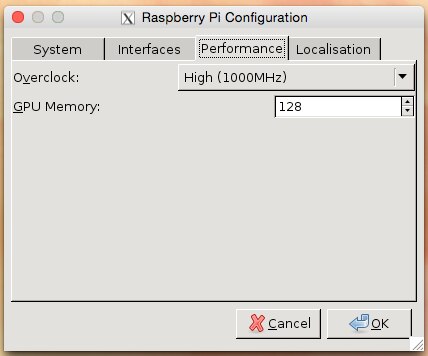

The most notable feature is the new version of the Raspberry setup directly accessible from the setup. All the options available in the raspi-config command are now accessible through a more comfortable user interface.
The four images above shows the four sections of the Graphical User Interface version of the Raspberry PI settings with the suggested settings for the setup we need.
Note: as far as I know it is not mentioned anywhere but confirming every panel you are asked for reboot despite the changes you apply. I suggest to follow this method (that means four reboot if you change at least one parameter on every panel to be sure that changes are saved permanently. For those who has problems with the previous wheezy version on the locale and keyboard settings, this issue has been solved. After setting the parameters in the fourth panel Localisation the settings are correct and the terminal warning of a wrong locale never appear.

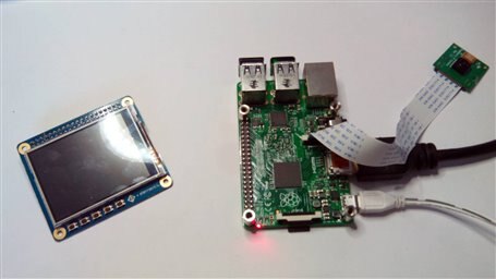

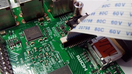

After the linux installation, power off the Raspberry PI and connect the camera cable to the camera plug as shown in the following images. Pay attention to the side of the flat cable else the camera is not recognized by the system. If your Raspberry PI does not recognises the camera, the most probable issue depends on the incorrect cable orientation.
The camera software installation is easy. The most complete and simple tutorial to follow is in the Element14 Pi Camera introductory guide.
After the installation and testing as shown in the tutorial, it is not needed you go ahead, we will step back to this device when all the parts are set correctly.

Follow the installation instructions until you are asked for the last reboot after inserting the touch panel in the Raspberry PI. After the reboot we see the desktop running on the touch panel.
Note: There is an easy-to solve issue in the installation manual: you are asked to set the sudo su before the installation commands; this means that all the further commands are sent as super user. The last command in the manual is preceded by sudo again: write the command without the sudo word because you are already in a super-user environment. That's all.
Using the Raspberry PI with the 2.4" HAT Touch Panel
Nice eh? Yes but almost unusable. This is the reason that we do somethings to make it better...

The installation of the touch panel replace some components of the original Jessie Linux Kernel with custom ones. This means that some features you have set in the kernel maybe lost. In particular, the Raspberry PI Consiguration settings (the four panels explained above) should be reviewed and applied again (depends on the settings you have used before).
When also this operation has been completed and the last reboot has been executed we are ready to move to the next step.
