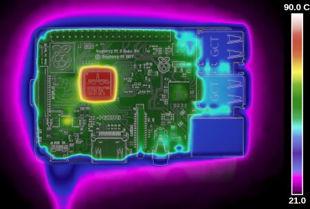

Raspberry Pi 3+ thermal map
Source: Gareth Halfacree from Bradford, UK [CC BY-SA (https://creativecommons.org/licenses/by-sa/2.0)]
It has been reported that Raspberry Pi can be vulnerable to overheating issues. The thermal map above shows a Raspberry Pi 3+ processor reaching towards 90oC. In several tests, the Pi’s SoC has been shown to exceed 100oC. In certain situations, the Pi can be pushed beyond its qualified operating temperature range, therefore its long-term performance is not guaranteed.

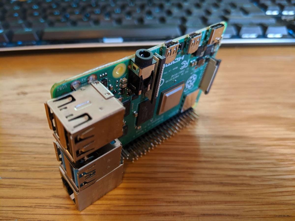

Get vertical
By simply moving the Raspberry Pi into an upright orientation with the GPIO header at the bottom and the HDMI ports at the top, management of the ambient temperature will be improved.
Raspberry Pi 4 in upright position
Source: Raspberrypi.org/blog
Orienting the components vertically will have an immediate impact on cooling, and will slow subsequent heating down, as improved convection allows the surrounding air to draw heat away from the board more rapidly. Additionally, the available surface area for cooling is increased by moving the rear of the board away from heat-insulating surfaces.

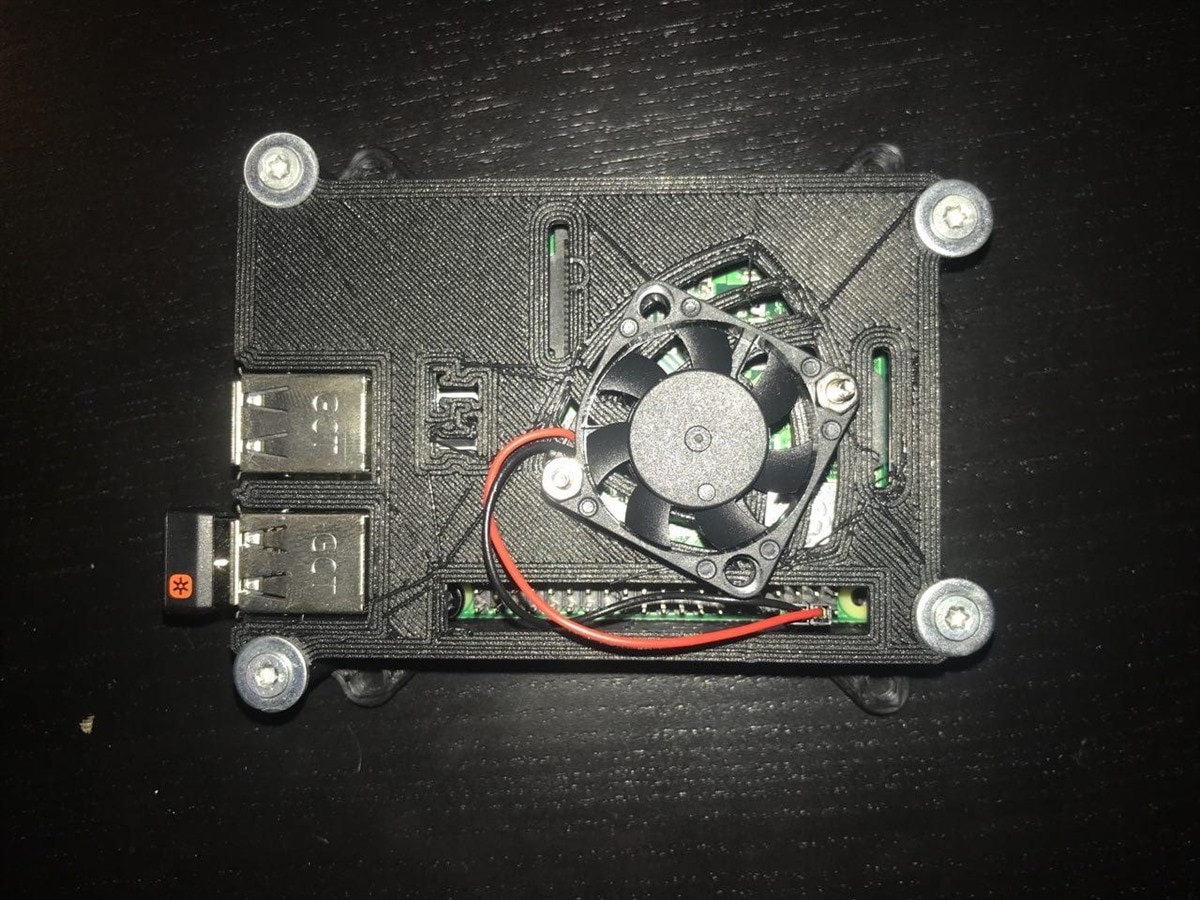

Install a fan
Raspberry Pi with fan and case
Lorenzo Toscano [CC BY-SA (https://creativecommons.org/licenses/by-sa/4.0)]
If heat can be removed from the components quickly, then the load induced temperature rise will not have as dramatic an effect on performance. One option to dissipate heat from Pi’s components is to mount a cooling fan, powered through the GPIO. Compatible fans are widely available at a relatively low cost and can be positioned to deliver cooling to where it is needed most: the SoC.

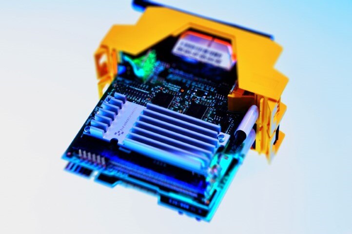

Brainboxes BB-400 with custom aluminium heatsink
Brainboxes designed a custom aluminium heatsink for the BB-400 Industrial Edge Controller , that sits in direct contact with the Pi’s SoC. The surface area of the heatsink is maximised to most efficiently utilise thermal conduction and draw heat away from the processor. When situated in the industrialised cover, the Raspberry Pi is in a vertical orientation aligned with the vent openings and so also exploits heat convection to provide the highest degree of cooling possible. In addition, the LAN7515 is replaced with an industrial spec chip, making all of the BB-400’s components rated for industrial operation (from -25oC to +80oC.)

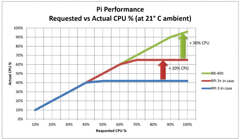

Requested vs Actual CPU
Tests performed at 21oC ambient, actual CPU recorded after sustained operation:
On the bottom x-axis is the CPU requirements being made by an application – for example, a monitoring application may need 75% CPU utilisation for sustained periods of time to perform its job. On the vertical y-axis is the amount of CPU performance that the Pi is able to deliver. In the absence of throttling, will track with the requested CPU performance on a 1:1 basis, given that CPU throttling occurs when the component temperature rises. However, throttling/ processor underclocking due to overheating means that the actual delivered CPU performance is less than the requested.
The first thing to note is at 21oC, a typical office temperature, the Raspberry Pi 3 could only deliver a maximum of 40% CPU performance for sustained periods of time. The Raspberry Pi 3+ offers a great improvement - due to its metallic lid it can offer up to 65% CPU for sustained periods of time.
The BB-400 with its custom heatsink can deliver 95% CPU performance for sustained periods.
