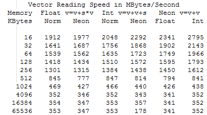

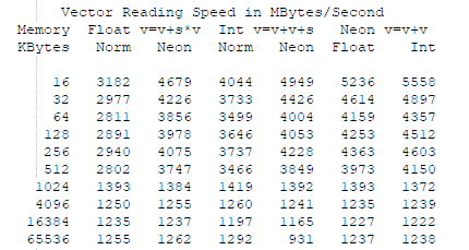

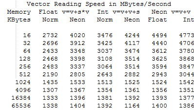

NEON Speed Test v1.0
Raspberry Pi 3 Model B+ Raspberry Pi 3 Model B Raspberry Pi 2 Model B
image image

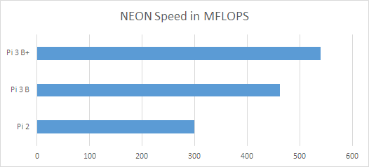

NEON technology was added with the Raspberry Pi 2. This increase in speed result should mean that the Pi 3 is faster at handling calculations relating to video, vector graphics rendering (so gaming and 3D) and potentially audio processing. Again it is interesting to see the point at which the performance starts to fall off.
There was also another NEON related test, which was the Linpack Single Precision Benchmark. This related the speed to MFLOPS, The Raspberry Pi 3 Model B+ shows a 17% speed increase over the Raspberry Pi 3 Model B, and a 80% speed increase over the Raspberry Pi 2 Model B.
Pi 2 : 299.93 MFLOPS
Pi 3 B : 462.07 MFLOPS
Pi 3 B+ : 539.68 MFLOPS

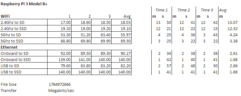

Testing Network Throughput
With the new network adapters on the Pi 3 B+ it makes sense to put them through their paces, it has been many years since I have had access to a proper academic network testing laboratory from my University days, so instead I set up the hardware at home. To understand how I setup the core structure of this network, I felt it would help to have a rather broken-out view of the network layout (or topology):

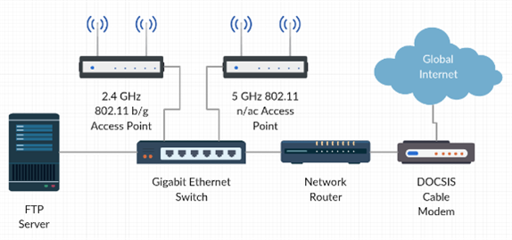

Using a File Transfer Protocol (FTP) server to test transfer speeds is, to me, the most visceral and raw test of data transfer you can do. Without encryption sat on top of the method of communication, or protocol, it is very bare bones and just takes your network connection and throws data across it. Which is what we are interested in!
It is unlikely you would strictly find a setup exactly like depicted in the diagram above like this, in your own home. Devices are not usually split into their individual components unless you are at a networking data centre, medium to large size business, or a University campus. At home you're more likely to see a device like this:
Image result for virgin media superhub
These are typically called 'gateways' though everyone calls these a 'home router' or a 'home modem', it actually integrates the wireless access points, ethernet switch, network router and cable modem in one device and is usually based around an ARM micro-controller or equivalent. Thanks Virgin Media. For the purpose of these tests we are only interested in the network to the left of the 'router' in the detailed diagram above, we do not actually 'talk' or transfer data out to the global internet with any of these tests that I have performed.
Setting up the Tests
The FTP server in the diagram is actually a desktop computer system that is used as my main computer in the house, it runs a 'Solid State Drive' (SSD) which is a storage device based on a type of memory rather than spinning metal disks, a 2.8Ghz intel Core i7 processor, gigabit ethernet and 16 gigabytes of RAM. I decided it was best to use some hardware that would not be the main restrictive component in the testing of the Raspberry Pi models.
Each Raspberry Pi model tested was then plugged into the official 2.5A, 5V power supply, keyboard, mouse and monitor screen.
A copy of the latest Raspbian image was downloaded from the RaspberryPi.org site and stored on the FTP server, this was some 1.6gByte in size as a zip file.
The file was then transferred either over the the following:
  • On board 2.4 GHz WLAN
  • On board 5 GHz WLAN
  • On board Ethernet (100mbps or up to 300mbps)
  • USB 2.4 GHz WLAN (WiPi)
  • USB 3.0 Gigabit Ethernet adapter
Thinking about it, finding a compatible 5 GHz USB WLAN adapter would have also been a good comparison test, oh well, maybe next time.
To compare the speeds, the file was then saved in the following ways:
  • Over FTP and saved to the SD Card
  • Over FTP and saved to an SSD connected to the Pi Desktop HAT via USB
If you're not familiar with the Pi Desktop, it is an enclosure and Raspberry Pi HAT which is designed to help you run your Raspberry Pi as a desktop computer (Desktop Computer Kit for Raspberry Pi ) by allowing you to connect your Raspberry Pi to an SSD and boot from it over USB. It made sense to use this as a basis of testing the file transfer as the SDCard could impose a limit on the transfer speed.

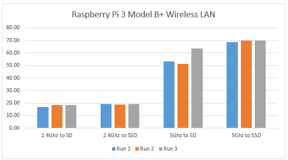

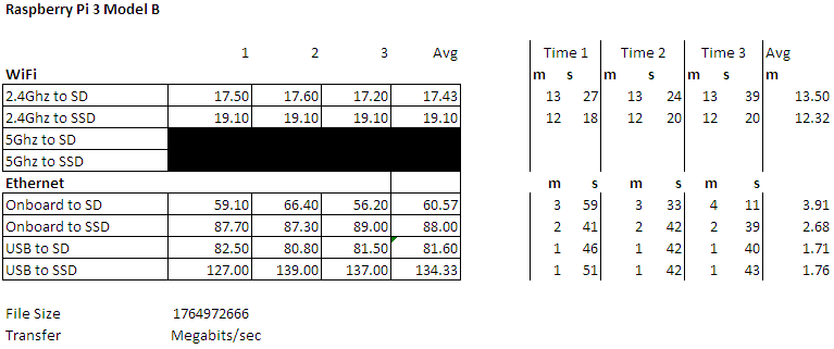

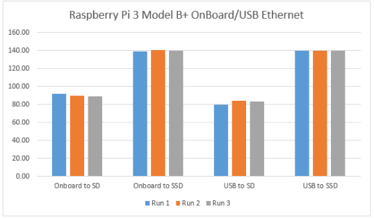

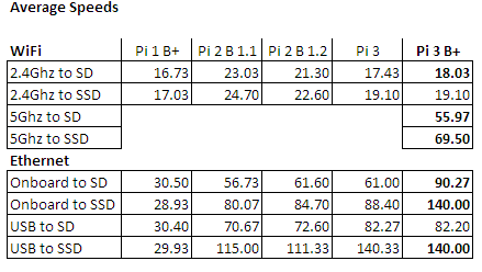

The Speed Results are in!
From the early versions of the Raspberry Pi we're seeing a steady increase in data transfer speed capability. It appears that the limitation now is the transfer speed to/from the SDCard used for the Raspberry Pi, though with the introduction of the Pi 3 Model B+ we still see a speed increase between the Raspberry Pi models, it is evident that the best transfer method when using one Raspberry Pi with the Model B+ is going to be the on board ethernet, followed up closely by the 5 GHz WLAN.
The reason why I had chosen to test a USB 3.0 Ethernet adapter is that I read a blog post that advised using one because it was faster than the on board controller chip. I am pleased to say that it is now on par and there's no reason to spend money on additional hardware, unless say, you're using it as a 'firewall' or 'proxy' gateway and need the throughput.
The speeds across the boards were reasonably consistent with a few percentage of change on each run, and while there's not a lot between the Pi 3 Model B and the Pi 3 Model B+ for 2.4 GHz WLAN (and obviously using a USB Ethernet adapter), the strength of the Pi 3 Model B+ definitely shows in the new USB and Ethernet controller chip and wireless LAN chip as the speeds match and exceed the default alternative.
For your perusal, you can see the individual network speed results, along with a bonus set from an accidentally overclocked Raspberry Pi 3 Model B to 1.4GHz, the benefit of seeing this benchmark is to show that the speed of the data transfer isn't entirely locked to the processor speed alone and there have been other improvements as well.
{gallery} Network Speed Results
Raspberry Pi: 1 Model B+
Raspberry Pi: 2 Model B v1.1
Raspberry Pi: 2 Model B v1.2
Raspberry Pi: 3 Model B
Raspberry Pi: 3 Model B - Overclocked - Oops!
Raspberry Pi: 3 Model B+

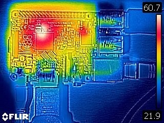

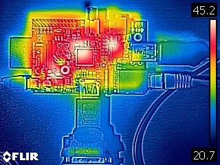

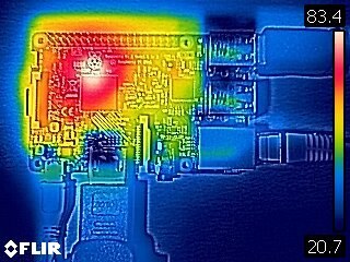

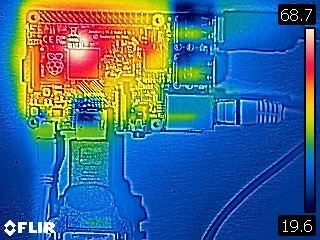

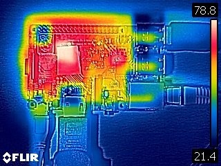

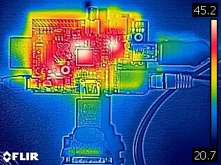

Cool Runnings
If you were around for the Raspberry Pi 3 launch you may remember that there were photographs circulating that showed it ran a bit warm (Raspberry Pi Operating Temperature Comparison (A+, B+, Zero, Pi 2, Pi 3) ). You'll be pleased to know that with the Pi 3 Model B+ the thermal management is performing really well. With the new SoC package the processor can dissipate heat a lot better, even when it is under load.
Thanks to FLIR's C2 thermal cameraFLIR's C2 thermal camera, we're able to take photographs, and thanks to a touch of thermal tape, even the emissivity of the metal cover on the SoC managed to not get in the way (you can adjust for it with the camera, but I was taking no chances!)
{gallery} Raspberry Pi Thermal Imagery
Raspberry Pi: The original Pi 1 Model B
Raspberry Pi: 1 Model A+
In Summary - It's Cooler and Faster
There appears to be no doubt that with each version of the Raspberry Pi there are improvements. If I was upgrading from even an original Raspberry Pi this is a significant improvement, and from the last version of Raspberry Pi, it's a very good step up.
We will soon be in a position with the Raspberry Pi, thanks to the Power over Ethernet HAT, where we can purely power and boot it from the end of an Ethernet cable. Making the device a cool, energy efficient Internet of Things capable device, or thin client. Especially with the other connectivity on board.
This appears to be an improvement that addresses those concerns a lot of people had, and I'm very interested to see where we can go from here.
