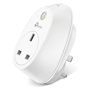

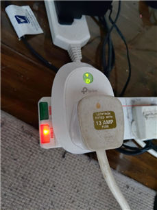

In this project, we're focusing on the TP-Link HS110 which is an IoT, WiFi connected power socket. With this device we find that we can get the information that we want and need out of it, without having to do too much additional work.
This device is perfectly hack-able in more than one sense, in one way it's hack-able in the Maker, Hacker, Inventor and Hobbyist sense, and in another because its local security and encryption is terrible. There are good articles that explain how it has been reverse engineered. The way in which the HS110 is intended that you control and manage its data is by using Kasa, TP-Link's IoT platform. TP-Link have integrations with various different systems, such as Google Home, Amazon Alexa, IFTTT and SmartThings APIs, though I didn't look too hard there wasn't a very evident way of officially interrogating the device. They also have IOS and Android apps.
If node.js is more your coding environment there are plenty of ways to communicate with the TP-Link API to control the socket, however there are other implementations on github, or if you have a home automation setup already you might be looking at Domoticz or OpenHAB.

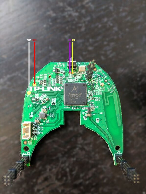

Inside the HS110 is basically a small, micro-controller based computer. Its hardware isn't too far away from some portable WiFi Access Points or Routers that're also made by TP-Link. This means you can flash custom firmware to the hardware, there's also a build of OpenWRT. This also means if we don't want the hardware phoning home to TP-Link, or we want to secure it in the future, we have the possibility of doing so (though doing so may be no small feat in itself).
So thanks to this interim socket connecting to your local WiFi, and allowing you to remotely control whether or not the power socket itself is turned on or off, and further to that, it keeping a log of real-time, daily and monthly power usage which is then sent to its cloud service and stored locally, we have a good basis for retrieving the information that we need. Thanks to a python library, which also functions as a standalone tool, pyHS100 lets us import code into Python to discover what sockets we have on the network, and their 'emeter' readings.

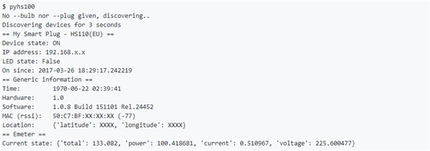

And then you can start writing python to interrogate the devices on the network, you can have it automatically discover the devices, or if you know the IP addresses, pass them or hard-code them into the file yourself.
Example discovery code:
from pyHS100 import Discover
for dev in Discover.discover().values():
   print(dev)
Example hard-coded code:
from pyHS100 import SmartPlug, SmartBulb
from pprint import pformat as pf
plug = SmartPlug("192.168.XXX.XXX")
print("Hardware: %s" % pf(plug.hw_info))
print("Full sysinfo: %s" % pf(plug.get_sysinfo())) # this prints lots of information about the device
More information can be discovered about the library at the github site, but I also discovered that I had to manually find out what modules/functions were accessible in the code. It was not obvious from the github site at all, and so running the following commands gave me more information:

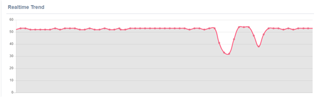

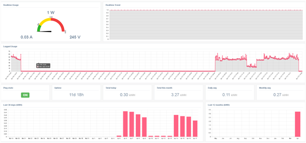

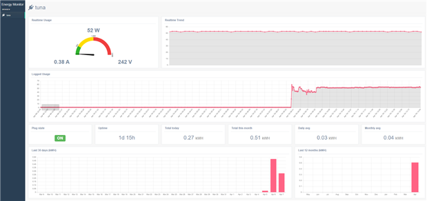

There is also a really nice, and easy way to plot and show all of the information we're interested in, thanks to James Barnett on github. The 'TPLink Energy Monitoring dashboard' has been written in node.js and is installed using npm, and while it doesn't let you directly control the socket, it will gladly discover the sockets you have on your network, and show you the status of them. It also logs the readings to local files.

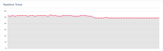

The charts created from this are really fascinating to watch, here we can see a dip where I turned off (and back on) the computer monitor attached to the laptop (and in line with it on a multi-socket connected to the TP-Link) which then has a curious power bounce:
And then there's a subtle dip when I close the laptop lid, thus turning off the built-in LCD display screen:
Which also highlights that the use of an LCD display makes the power usage very variable as it fluctuates when it's active, but pretty static when the screen is off.
To have this up and running you'll have to install npm on your system:
$ sudo apt-get install npm
And then you run the following commands:
$ git clone https://github.com/jamesbarnett91/tplink-energy-monitor && cd tplink-energy-monitor
$ npm install
$ npm start
If your install is anything like mine, npm, after you install it, or when you run 'npm install' will complain that there are security vulnerabilities. It'll advise that you run commands to fix this. Do so, do all of it. Even the 'dangerous' advice it gives to fix these vulnerabilities didn't break my tp-link energy monitor dashboard install, so you should be good to go.
Once installed, you can go to the IP address of your Raspberry Pi, and you should now see the dashboard. By default it runs on port 3000, so for example:
http://192.168.0.3:3000

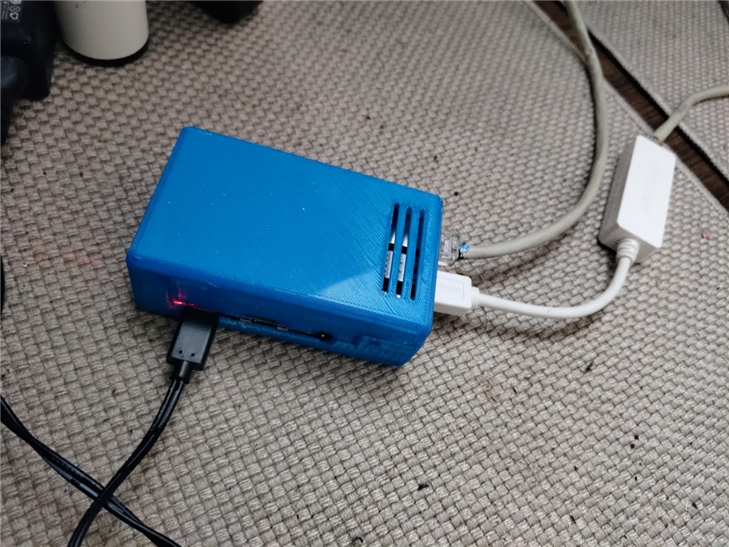

I have an academic background in network technology, which is why I am fortunate in having the hardware to hand to set this one up. I appreciate not everyone will, and not everyone may fully understand what is happening with this setup. The goal here, is to monitor and track all computer network traffic coming out of the 'black box' which is the laptop, or frankly this could be any device that's plugged into an Ethernet adaptor connected to the Raspberry Pi.
With this part of the project, I use functionality called 'bridging'. Usually when your Raspberry Pi connects to a network, any computer communication traffic on that network goes only to the device that is directly connected. Whether it is the Wireless LAN, or the on-board Ethernet socket. Bridging the connection allows communications to pass through that device to another on the Raspberry Pi, otherwise the two never really know about each other.
To do this, in Raspbian (Debian Linux) we create another network device, one that is in software and not physical (this is called br0 typically) that allows all of the network traffic pass through two devices connected to the Raspberry Pi (or more if you really want), and we can then monitor/watch/observe the data and communications going through those devices. So This could be setup in any of the following configurations:
  • From the on-board Ethernet through to the on-board Wireless LAN, or
  • It can be on-board Ethernet to USB Ethernet, or
  • On-board Wireless LAN to USB Wireless LAN, or
  • USB WiFi to USB Ethernet.
In our case, we're going to use a USB Ethernet adaptor which will route the computer communications on the network back and forth through the on-board Ethernet. So that we do not interfere with this information being passed along, we will not include the on-board Wireless LAN in the bridge. We have to be careful when using USB Ethernet, If you have read any of my blogs where I benchmark the network connectivity on the Raspberry Pi (A Comprehensive Raspberry Pi 3 Model B Plus Benchmark or Benchmarking the Raspberry Pi 4 Model B ) you may be familiar that using Ethernet connected to USB can slow down the network connection, and in some cases, be faster than the on-board Ethernet. This is because USB is rated at a different speed to Ethernet. USB 2.0 is at most 54 megabits per second, with the Raspberry Pi 4 we are working with Gigabit Ethernet, to ensure that the Raspberry Pi doesn't slow down the network connection to the laptop in this case, we want to go from Gigabit Ethernet to Gigabit Ethernet, USB 3.0 is rated at 5 gigabits per second which means a USB 3 Gigabit Ethernet adaptor should be fine.
The USB 3 Gigabit adapter I am using is the TRENDnet TU3-ETG/EUNL v1.0R, this will identify itself as 'eth1' when connected to the Raspberry Pi 4, the on-board Ethernet will identify itself as eth0.
The Raspberry Pi 4 case I'm using here is a slightly modified version from this blog post: Raspberry Pi temperature and cooling testing Part 1 initial tests. which also has an attached 5 volt small fan attached to the GPIO pins (I haven't connected the third pin for speed control/monitoring yet..), perfect for keeping it cool. I'm using alleged 'diamond' heatsinks and thermal paste to help keep the Pi 4 cool.

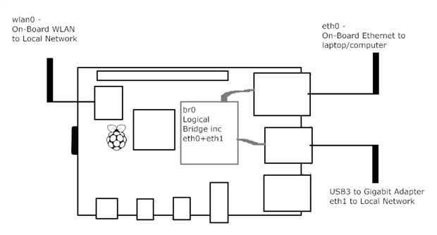

Bridging Connections
We will be using the on-board Wireless LAN to monitor and setup the Raspberry Pi 4, this identifies itself as 'wlan0' by default in Raspbian. The Ethernet adaptors will be eth0 and eth1. We will also go with the default bridge virtual interface identifier as 'br0'. Here's a diagram that might help you to visualise what's going on:
In Linux it is pretty straightforward to setup a bridge, but it's a bit trickier to set one up that just acts as a 'pass through' for network activity, and to ensure it sets itself up whenever we start up the Raspberry Pi 4. What if I told you, that your network connection doesn't need an IP address for it to work? You are probably used to connecting to your Raspberry Pi by using an IP address such as '192.168.1.15' or something similar? Well, there's a mode called 'promiscuous mode' which lets your network connection accept all traffic and to pass it through, and this is how eth0 and eth1 will run, but it means to prevent confusion for the laptop or computer connected to the Raspberry Pi, we need to make sure that eth0 and eth1 do not receive an IP address. wlan0 can continue to receive an IP address, it needs to so that we can talk to it.
In this setup we're assuming that you've already setup your Raspberry Pi so that your Wireless LAN is connected to the network, and we're connected to the terminal on your Raspberry Pi, either physically with a keyboard, mouse and monitor. Or you've found out the IP address of wlan0 (by running ifconfig wlan0 on the Pi) and you've connected via SSH.
If you're trying to set this up while connected over SSH to your on-board Ethernet, you're going to have problems. Make sure you don't have any cables plugged into the Ethernet ports. It's also worth noting that for eth0 to your laptop/computer you may need to use a crossover cable, and each Ethernet cable needs to be at least Cat5e so that it is rated for Gigabit transmission and reception.

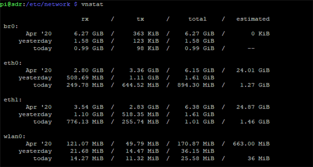

Then by default, type the following:
$ vnstat
And you will get an output similar to this:
You will notice that the amount received (rx) and amount transmitted (tx) will be different for each interface. Our bridge (br0) has aggregated/combined together how much data has gone through eth0 and eth1, so this is not a very accurate measurement of how much information has transferred across the connection. Where as eth0 and eth1 are actually similar, there will be some increase on eth1 in this case, as that is directly connected to the local network and there will be some amount of traffic filtering going on with the Raspberry Pi bridge that's preventing it going directly through to the laptop/computer.
However for the least confusion here, you could take the rx and tx numbers from eth1 and present those as how much data is used by the laptop/computer.
vnstat can be customised further, for example if you don't see a list of interfaces like I do here, you can add them, you can also 'clear' the database that's being stored, and you can remove interfaces. You can find more information about the commands on the vnstat man page:
$ man vnstat

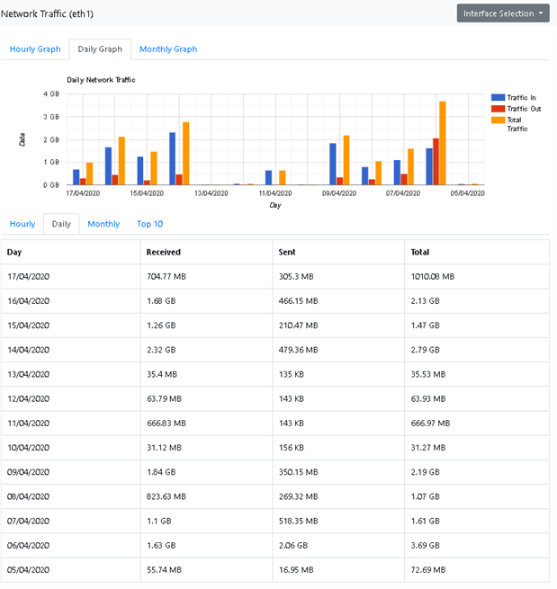

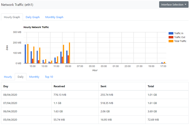

However we want a pretty graph, we have two options for this. One is a package called 'vnstati' which can produce a one-off graphic (unless you automate it), or there's 'ntopng',  and these can also be installed with 'apt-get' (ntopng will clash with the TP-Link Energy Monitor unless you change the port it defaults to). Or we can use the vnstat dashboard:
I encountered a number of problems getting the vnstat dashboard to install and work. Mainly because of permissions when setting up the Raspberry Pi as a web server. So here I present to you the steps I took to get this setup and running, feel free to add comments below if you encounter problems (since you can use this for monitoring the network of a Raspberry Pi anyway, it doesn't have to be for this project). If you're already running a web server on your Raspberry Pi, then change the folder structure to what you need so that it doesn't conflict.
$ sudo apt-get install apache2 php php-gd wget unzip
$ sudo service apache2 restart
$ cd /tmp
$ wget https://github.com/alexandermarston/vnstat-dashboard/archive/master.zip
$ unzip master.zip
$ sudo cp -a /tmp/vnstat-dashboard-master/  /var/www/html/
$ sudo rm /var/www/html/index.html
By default vnstat dashboard will look at all the interfaces. If you want to change that then you'll have to edit the following file:
$ sudo vim /var/www/html/includes/config.php
And now we change the following lines to read as follows:
vnstat_bin_dir = '/usr/bin/vnstat';
// Set to true to set your own interfaces
$use_predefined_interfaces = true;
if ($use_predefined_interfaces == true) {
    $interface_list = array("eth0", "eth1");
Other lines can be left as they are. Now you can save and quit your text editor.
Your VnStat Dashboard should now be accessible on the IP address of the wlan0 interface of your Raspberry Pi, for example:

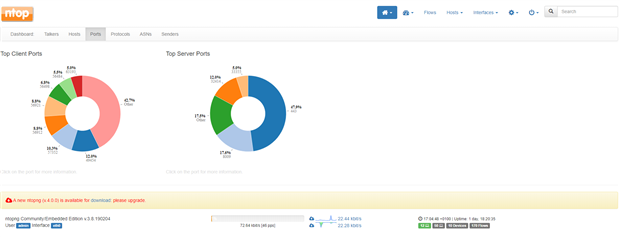

ntopng
One such tool is 'ntop' or 'ntopng'. Now, you're on your own with setting up and configuring this one, see if you can work it out. It can clash with the install of the TP-Link Dashboard because it tries to run on the same port. It gives you a lot more information about the network traffic that's going through your Raspberry Pi interfaces:
You can install this via 'apt-get ntopng', however this tool is a little more out of scope for this blog post, but I figured I'd mention it just to get your interest!
A Week's Worth of Data
I thought you might appreciate an update where it's been about a week of monitoring the bandwidth and power usage:
I'm really glad that my ISP doesn't cap my internet usage per month, I think I'd really struggle to work from home with this amount of data usage!
How's that?
Hope you've enjoyed this little guide to monitoring your network and electricity use for your hardware. Consider this a 'starter' to getting the full benefit of logging and information onto your Raspberry Pi and IoT hardware in the home.
