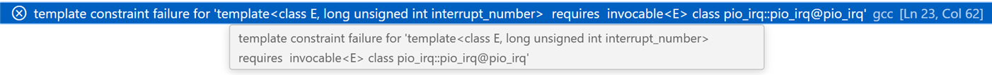

    C++ has a mechanism to enforce that a class has to provide particular operations. This allows to only accept classes and objects that can do a particular thing, without the need for a base class. And without inheritance.
    In the lib that I'm writing, it's expected that the objects you pass to it for interrupt handling, can actually be executed. They need to provide the () operator.
    C++ has concepts. Guards that you can use to investigate capabilities at compile time. There are standard ones, and you can define your own checks.
    In this case, I'm lucky, because there is a standard concept to check if a template type can be executed: std::invocable. If I set that as a requirement for a template parameter, the code will not compile if you use the template class with a type that doesn't have the () operator:
    // guard that E has to support () operator.
    template <std::invocable E, uint32_t interrupt_number> class pio_irq {
    This is a help to the user of the library. They get a clear message that they are using the library with objects that aren't fit to handle the interrupts.
    The nice thing is that E can actually be a simple function pointer. Doesn't need to be a class with () operator.
    Another nice thing is that the runtime cost is zero.
