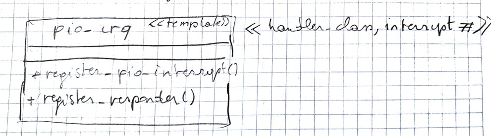

Object Oriented library to design C++ classes that support PIO interrupts.
Goal: make a PIO state machine call the very C++ object that's managing (or watching) it.

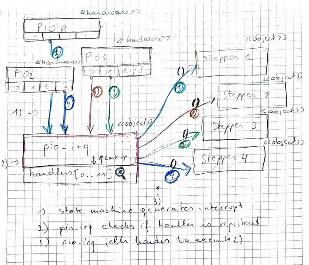

When I designed a Pico library to manage stepper motors with the PIO co-controllers, I created a utility to handle PIO relative interrupts.
My design was object oriented, and I used objects to handle the PIO state machine for each stepper motor. One of the things I got working then, was to call the right stepper object when a PIO interrupt occurred for its particular PIO state machine. The PIO APIs aren't very OO friendly, and require bridging mechanisms to translate raw interrupts into something that's delegating duties to objects. Here is the documentation of that exercise: Handle Raspberry Pico PIO "relative interrupts" in C++
This is functionality that is useful in many OO PIO designs. I developed it specifically for stepper motors. In this series, I try to make it generic. Usable for any OO designer that wants to react on PIO notifications.
A PIO relative interrupt is an interrupt that contains info of the PIO controller and the state machine that generated the interrupt.
This will be an evolving series. I'm going to make it as flexible as reasonable, for an embedded system. Initially, I'll try to support objects that can be executed. (in C++ language, that means that they overload the () operator).
Watch this thread while I'm trying to transform a project specific construct into a reusable library ...
sneak preview:
PIO interrupts can only call functions without parameters. They can't call object members.
This static embedded class delegates interrupts to the relevant object.
The objects have to implement the () operation.
// guard that E has to support () operator.
template <std::invocable E, uint32_t interrupt_number> class pio_irq {

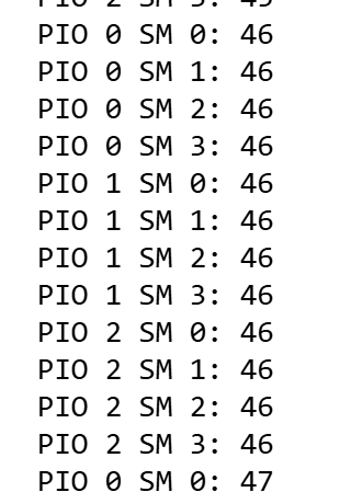

    Jan Cumps over 1 year ago
    All 12 available PIO state machines on a Pico2 having all their PIO relative interrupts managed by their own object:
    This is captured on a RISCV core. It works the same on the ARMs

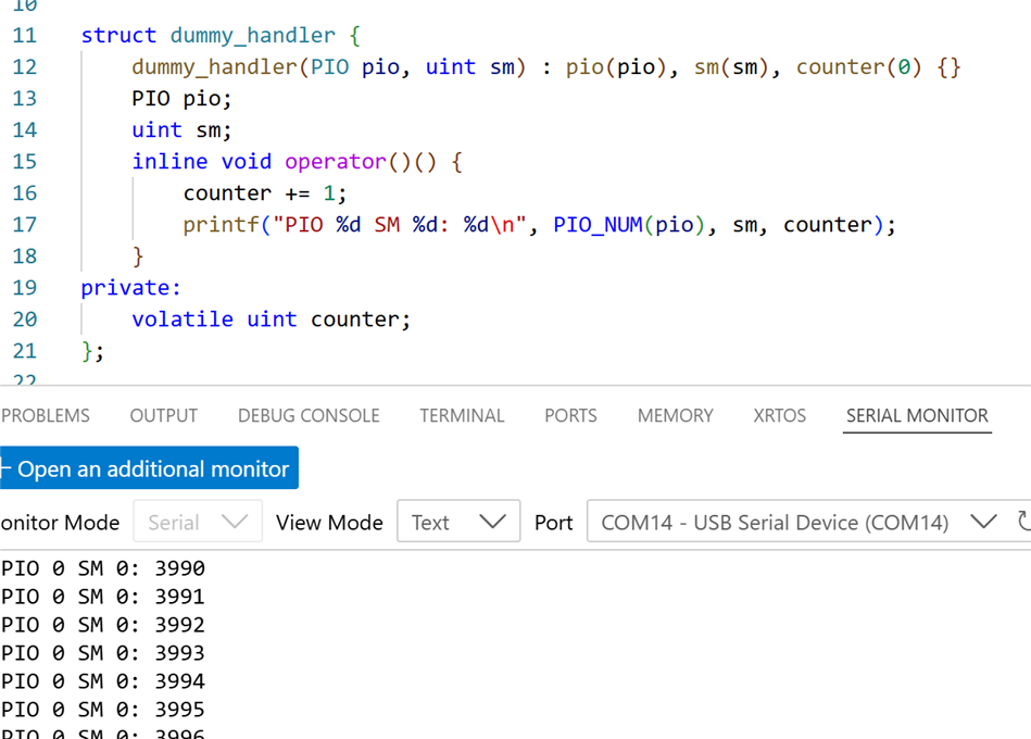

    Early results:
    The mechanism works. A single class with 2 public methods supports the mechanism.
    One to tell that we're interested in managing an interrupt. The other to register the object that will handle the interrupt.
    The screen capture shows a minimal handler, that just prints a message and counts how many times it's been invoked.
    The only requirement for a handler class is that it has line 15. All other implementation parts are for demo use.
