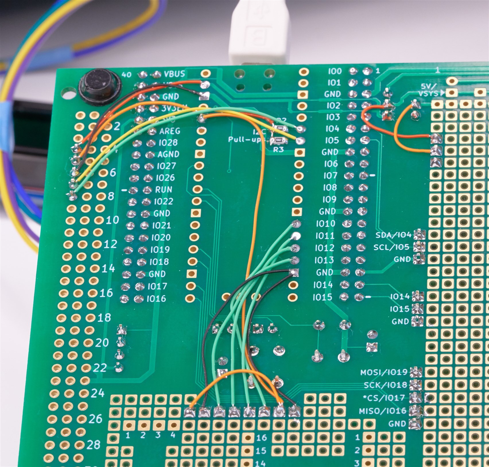

    I modified this rev 1.0 board to rev 1.3 functionality, by soldering connections for TFT and LCD screens. I'm still waiting for a TFT screen to arrive.
    It was a great suggestion to add the display capabilities! This particular LCD screen doesn't have great contrast, but is easy to control and has plenty of source code - it is a Waveshare display). It has a multi-color backlight which is unusual too.
    The easiest way to use stripboard is shown on the left side in the photo above. The surface-mount sockets are easy to align while soldering, by pushing a row of pin headers in from the other side (the sockets accept pins from both directions. In theory this means you could use either side of the stripboard face up (e.g. for some surface-mount work, it's better for the traces to be face-up).
    The latest rev 1.3 files simplify the addition of stripboard, by having a single long column of contacts, so that many separate ones are not needed.
    The photo below shows what it looks like with stripboard added (the other side could be supported with more pins/sockets if desired). The blue row of sockets is for the TFT screen.
    The wire mods to obtain the rev 1.3 functionality:
