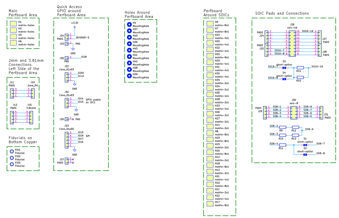

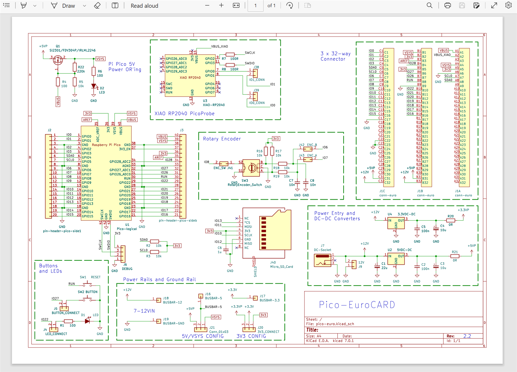

    I've tidied it up, but also decided to embrace that area beyond the frame..
    All the prototyping area pads clutter is off the frame. It could move to a separate sheet, but I'll leave it there for now, it's still nicely out of the way and yet can be quickly zoomed/scrolled into view.
    Close-up of the stuff that is beyond the frame!
    The neat thing is that when plotting to PDF, just the important bit gets plotted!
    I'll get the Kicad 7 project source into the GitHub site. There are lots of DRC warnings (all related to silkscreen cuts/overlaps or to the inverse text silkscreen, since that was just pasted in without a library) but those can be improved another day, since that could be quite tedious to fix each silkscreen issue. Also I have two weird errors where KiCad expects two footprints of type "Through-Hole" but sees "SMD". This might be a KiCad 7 error (I don't recall seeing it in KiCad 6 but I might be mistaken), but it seems benign, since this has not changed between revisions, and clearly the Rev 2.1 boards worked since they are tested physically.

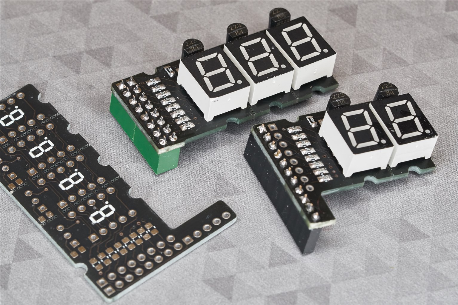

    I built up these  Easy 7-Segment Displays  the other day. If they work I'll send them across to you and Jan soon (I want to create a plug-on protoboard with Mikrobus Click shield adapter since that seems handy). It's just a simple 7-seg display, just BJTs, and no driver chip, it relies on code to do the multiplexing effort, and it hangs off the 3x32-way connector area on the right side of the board.
