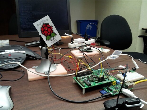

I hosted a webinar today on the PiFace and Gertboard.  I thought it might be helpful if I shared the resources I used to create the demostrations:
