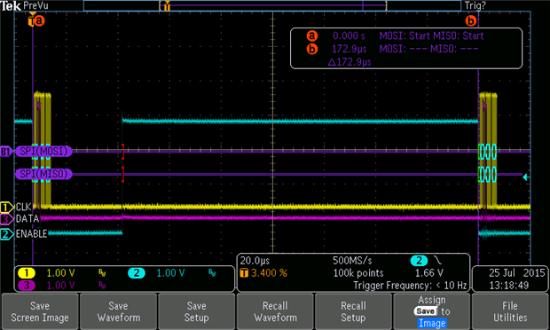

So I have shown in the past using the PI with Windows 10 for IOT and driving SPI devices, and in those examples I was using Mode 0 of the SPI bus for clocking etc. I initially assumed as I was also using TI chips that this mode would also work with the DAC8734... Wrong, It took me a while to figure out what was wrong but eventually I did, thanks to my trusty MDO3054 scope and the SPI decode module to make life a little easier. The chip requires Mode 1 of operation
Here are two captured traces, one MODE 0 and one MODE 1, see if you can tell the difference without looking up the SPI standard image. I will be posting a complete video and write up on this issue after this post and am keeping it seperate in order to keep the videos under an hour each (Yes I did hear you all from my previous posts). For now here is the teaser waveforms

Here are the timeing diagrams for one period (2 sample outputs), the three diagrams show the complete cycle, the first 24bit output and then a subsiquent one. As you can see, there is a significant delay between the end of the data being output and the chip select releasing.
So if being able to output 256 samples in 44mS seems reasonable, if I simply comment out the lowest level write to the SPI bus I can, it will complete 255 loops of 256 values in only about 33mS equating to about 7.7Khz so if this had efficient lower level drivers perhaps the PI would still be able to output a 256 sample waveform at about 5Khz, that would not be too bad. Lets see what MS has to say and also what the release builds due out in a week or two will show.
