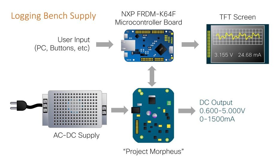

The solution overview diagram is shown below. Apart from the main board, all other parts are off-the-shelf low-cost modules.

The earlier diagram shows the Morpheus board connected to a NXP FRDM boardNXP FRDM board. The FRDM board is a bit like an Arduino – it can be coded using near-identical commands.
Any controller board can be hooked up, provided a serial peripheral interface (SPI) is available. Eventually I will swap to a Linux board such as the BeagleBone Black.

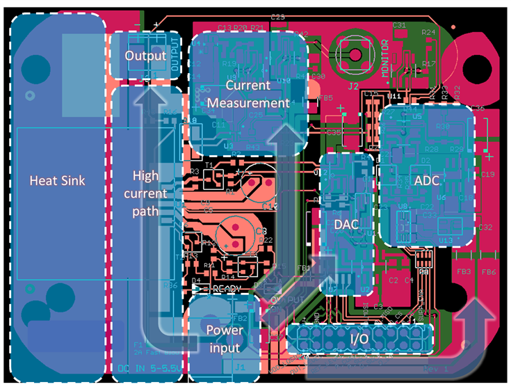

The diagram below shows the Morpheus board functionality.
The entire left side of the board contains an adjustable voltage regulator and some heatsinking for it. Power is applied to the board at the bottom. The microcontroller board is attached to the I/O connector at the bottom-right of the board. The SPI bus is used to configure the digital-to-analog converter (DAC) that controls the adjustable voltage regulator. At the output of the voltage regulator, there is a sense resistor and amplifier circuit to create a voltage that varies as the current changes. There is a small connector that can be attached to an oscilloscope to capture this. The right side of the board contains an analog-to-digital converter to pass the measured current value to the controller board. For voltage readback (to confirm the DAC and voltage regulator are behaving correctly and for auto-calibration), a voltage proportional to the output voltage is available to the microcontroller (so that the microcontroller’s ADC can be used to monitor it). However things are still reasonably accurate (typically within 10mV) even without such calibration, for an unloaded supply. Once the supply is loaded, I see about 27mV drop at the board output terminals, at 5V 500mA load. A lot of this (15mV) is due to the sense resistor, and so power calculations can be quite accurate if this is taken into consideration in the software.
There are a couple of other bits of minor functionality, but the key areas have been covered.

This project is restricted to 5V output maximum, because I’d originally intended it to simulate a single LiPo cell. This is very restrictive for a general bench supply, but still lots can be done because many portable projects operate from 5V or lower voltages.
The maximum current is 1.5A, but the maximum measurable current can be optionally lower, depending on an on-board current sense resistor value. A future implementation of this project could have switched sense resistors. Currently I’ve soldered a 30 mOhm sense resistor to the board, which allows me to measure up to 700mA. If I need to measure up to 1.5A then I’d need to change the sense resistor.
Anyway, 1.5A or 700mA, at up to 5V, should hopefully be sufficient for many IoT projects. This project is really just a prototype, and it could be redone one day with higher voltage and current ranges.
The Morpheus board requires 5-5.5V for operation. With a 5.5V supply, the output can reach the full 5V DC, however the maximum possible output is slightly lower if a more commonly available 5V supply is connected. But for most circuits, the difference is negligible. If fitting in an enclosure, an enclosed chassis AC to DC PSU could be used, as they often have a trim adjustment for setting non-standard voltages provided it is close to the stated voltage.

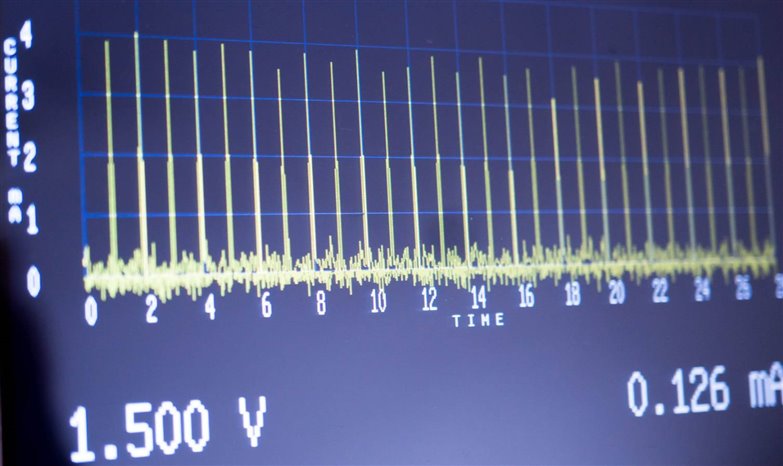

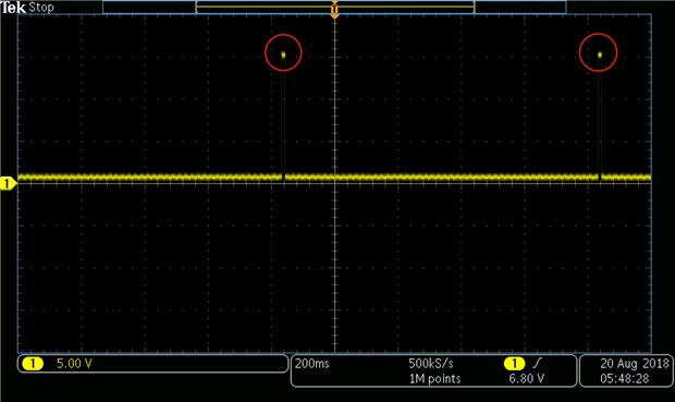

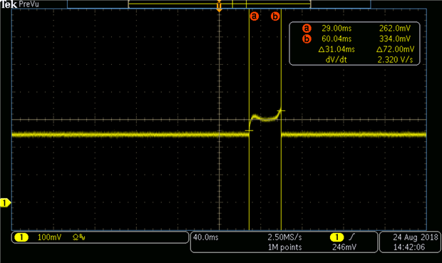

Here is an example of how it can be used currently. I set up Project Morpheus to supply 4V to an external device, and monitored the oscilloscope output, to see the current consumption.
The oscilloscope trace below shows the current consumption. It is clear that the connected load is of low power but is occasionally demanding short bursts of current (circled in red because they are hard to see). These bursts occur every second, but they could be more rare, and you may want to capture for many minutes or hours. This ‘scope has 8-bit resolution so the noisy looking stuff at the bottom isn’t very clear. Oscilloscopes aren’t intended for logging for such long periods.

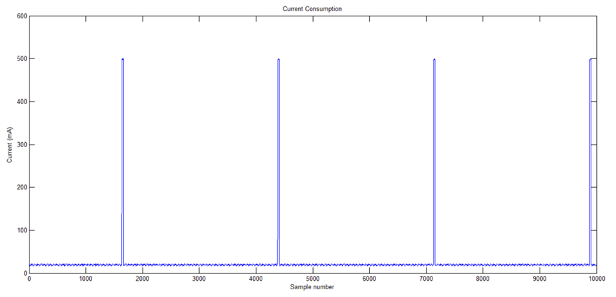

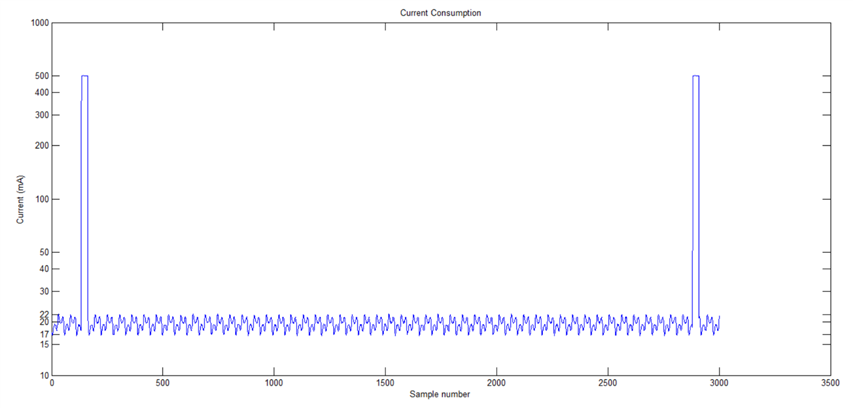

Here is the output captured via the USB serial dump and then imported into MATLAB; it looks similar to the ‘scope capture:
But, it is possible to zoom into this. In the chart below, the vertical axis has been changed to logarithmic, so the low-level detail is clear as well as capturing the short bursts. Now it can be seen that as well as the short 10 msec bursts of heavy current, there is some small fluctuation in current consumption at other times, in a repetitive pattern.
Based on the sample rate, it is now possible to deduce that the tiny stuff at the bottom is remnants from a 50Hz source (UK mains).

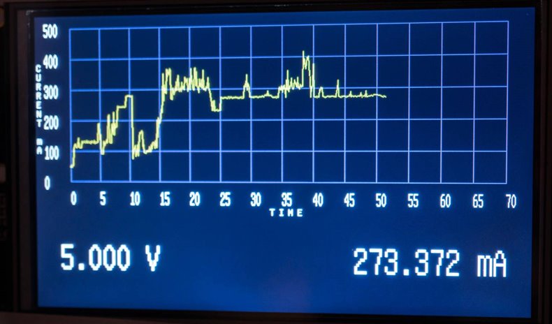

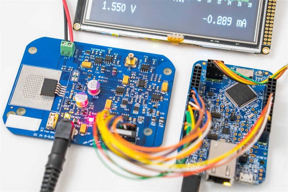

Here’s another example; I attached a Raspberry Pi 2B+ onto the output, set it to 5V and turned on the output. This photo shows the chart on the TFT screen during Pi boot-up for the first 50 seconds – this is from the slower (10Hz) logging that occurs continuously, it doesn’t need any configuration. I figured that way, one is more likely to catch interesting behaviour, by having the system continuously charting always, whenever the supply is used.
I really liked having this continuous view, because I could see the slight changes in current (the vertical resolution is 2mA per pixel on this chart) whenever I typed commands or executed anything. It would be possible to optimise software for portable battery operation with this power supply.

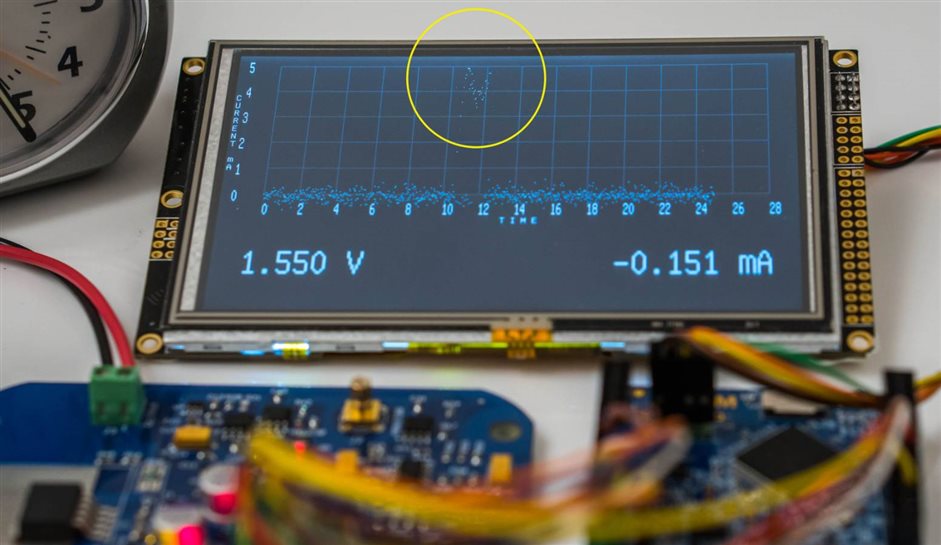

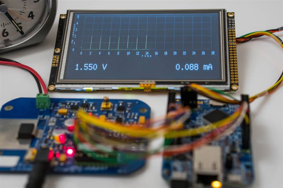

As another example, I set the y-axis to 1mA per division (currently it is hard-coded so I had to edit the code to do this) and the horizontal setting to 2 seconds per division, and then attached a small analog table clock to the output. It uses a single AA cell, so the output voltage was set to 1.5V.
It was possible to see each spike as the clock moved its seconds hand. This is quite an extreme test for the continuous charting feature though, because each spike is very brief. Apologies for the poor photos – the resistive touchpad on the TFT screen is very glossy : (
From the menu system the high-speed capture was started, and it logged to a buffer for a brief period of time. Here is the output:
Currently the x-axis doesn’t update for the high speed capture. Also, it just plots data points (with no attempt to join the dots) in the high-speed logging mode.
Anyway, it can be seen from the circled content in the photo above that the burst seems to have two mini spikes. To see more detail, the analog output connector on the board can be attached to an oscilloscope:

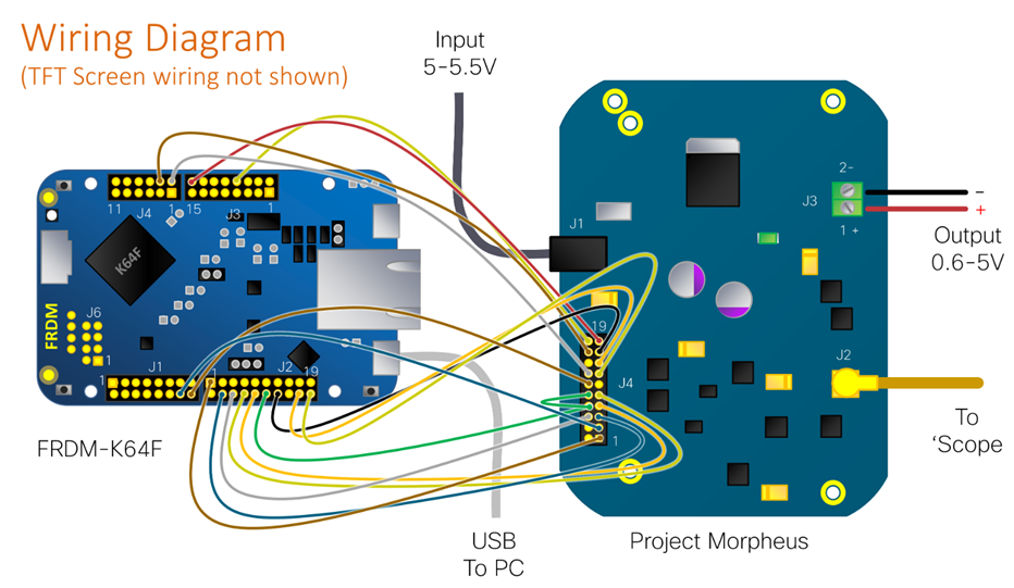

There are just a few steps. The Morpheus board needs to be constructed of course, but it is a straightforward exercise. The board files are attached to this blog post, for sending to a PCB factory. The parts values can be found from the schematic, but the bill of materials will be supplied shortly too.
Then, it needs to be attached to the FRDM board (using jumper wires). Next, the FRDM board software needs compiling and downloading into the board. That should be sufficient to test the solution, using the USB serial menu capability! Finally, the TFT screen can be attached. All the steps are detailed below.
Morpheus Main Board
The Morpheus board is nearly all surface-mount, but most of the parts are very easy to solder on although a few take a bit more care (but feasible with a normal soldering iron). There is a DC jack for supplying 5-5.5V DC to the board.
A load of jumper wires can be used to patch out to the FRDM board. Eventually I may make an ‘interconnect PCB’ to simplify this, for either the FRDM board or BeagleBone Black.

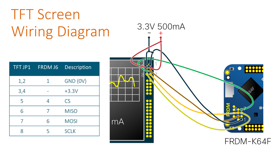

TFT Screen
The screen is available from many vendors on aliexpress and likely ebay too. There are several variants. The one to get should operate from 3.3V and configured for 4-wire SPI operation. There are versions with resistive or capacitive touch capability, but that has not been implemented in the code yet, so this is optional. The model number of the display is ER-TFTM050-3 and when configuring it to purchase, make sure 4-Wire SPI, and 3.3V operation (not 5V) is specified.
To operate the screen from the same 5-5.5V source as the rest of the project, a DC-DC converter is needed to convert to 3.3V. This could be an off-the-shelf module, or it could be constructed using an IC. I used a ST1S10 chip and followed the datasheet to construct this.

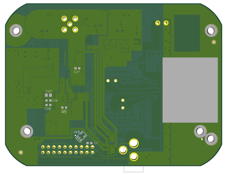

PCB Renders

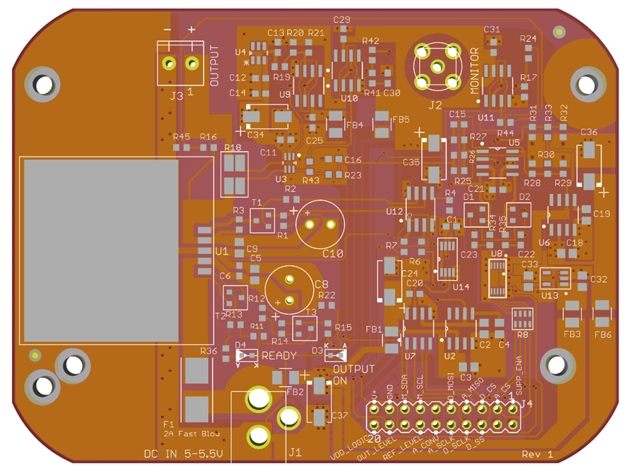

Most parts are installed on just one side, but a few passives and a serial Flash memory device are installed on the underside. The memory isn't used currently, but will eventually be used to store board-specific calibration data if desired.
To construct the project, the voltage regulator and DAC portion could be assembled first, and checked that the output is as expected by (say) running a test program on the microcontroller board. Next, the current sense amplifier and analog current measurement portion could be assembled and tested. Finally, the ADC part could be assembled to complete the functionality.

There are no known electrical faults with the PCB, however the following tweaks could be made in a future rev 2 board:
  • C6 pad needs to be increased from 0603 to 0805
  • Replace OUTPUT LED with a red LED instead of green
  • T2 and R13 text is touching each other
  • Move text J1 slightly right
  • Perhaps better silkscreen for the 20way connector (J4)
  • Move text J4 slightly right
  • Electrolytic silkscreen needs marking with semi-circles to indicate polarity
  • U4 silkscreen needs a dot, not an asterisk
  • Change MOSFET names T1/T2/T3 to Q1/Q2/Q3
  • Change R14 from 1M to 10k, to protect the MOSFET better
  • Consider replacing the DAC with a more coding-friendly one
  • Consider Welwyn OARS (OARS1) series current sense resistor, it has lower temp coeff. for the same price (but is physically larger)
