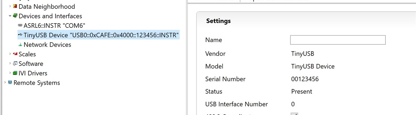

Test if NI-Visa recognises it
If a device enumerates as usbtmc, the NI-Visa tools should detect it. The easiest way to see that is by starting NI-MAX, the NI instrument explorer.
That completes this test. The device does not have any intelligence, but is able to make itself known as a usbtmc. And software recognises that after plugging it in a USB bus. This 'll be my first step to try and write a Pico "native" test instrument with the C-SDK.
