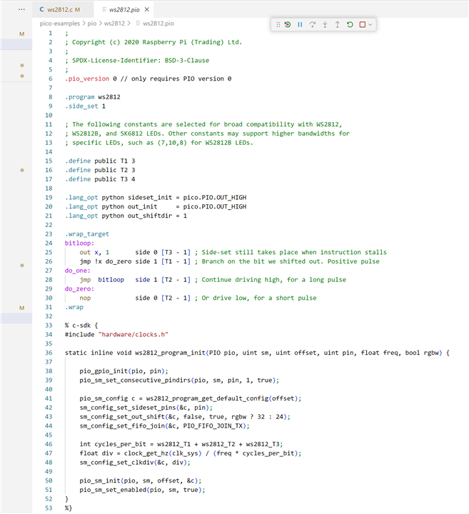

    Jan Cumps over 1 year ago
    There is an extension for VSCode, to syntax-highlight PIO scripts. It's called PIO ASM Syntax Highlighting:
