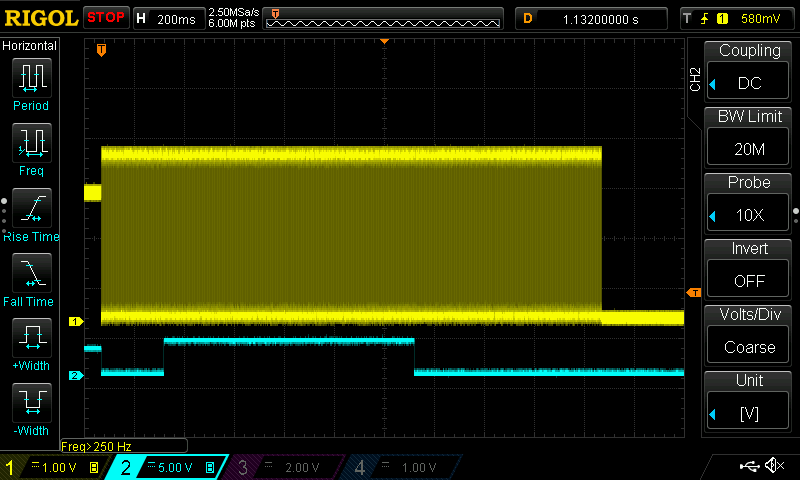

Here's how this looks like on a scope. Blue is the direction pin.
The video near the start of this blog shows the same sequence, but I added a little pause between the steps for visibility.

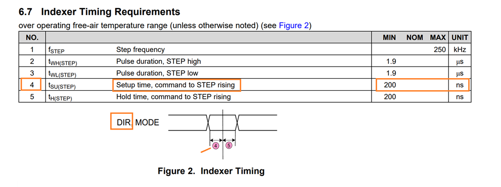

    The PIO program that I wrote works, but it violates a requirement from the stepper motor driver I use, a TI DRV8711
    There should be a 200 ns time between setting the DIR pin, and taking a step. My code violated that blatantly. It had 4 PIO clock ticks between the two events.

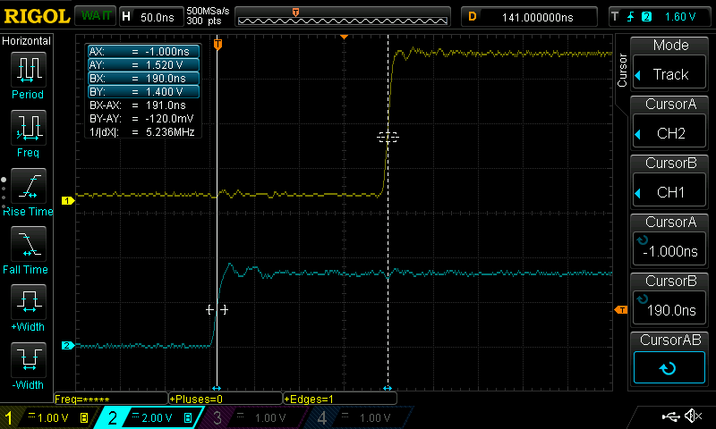

    I don't have a perfect solution yet, that works for all PIO clock speeds. Wat I've done now is configure the highest speed that works for my project.
    Then stretch the clocks used to set the DIR pin:
    .define public DIR_DELAY 4
    out pins, 1 side 0 [DIR_DELAY] ; shift direction out of OSR and output to dir. 200 ns before next step
    The [DIR_DELAY] stretches the clock ticks used by the out command from one tick to 5. (the command, and 4 delay ticks)
    It's not perfect. For slower PIO clock speeds (something you set, there will be a (nanosecond order of magnitude) delay. But I bet that you won't notice it.
    This is the scope capture of the time between the events, with the adapted code:

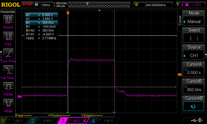

    Time taken by the ARM core to load an instruction into the PIO FIFO. I used a GPIO to measure the time, so you 'd have to discount two gpio_put() calls from the 360 ns it takes to pass the instruction from ARM to PIO.
    An instruction can have many steps (millions, if you need - anything that fits in 31 bits. For any process that needs a motor to step for milliseconds or seconds (or longer), this is definitely a resource gain. (although you can't put the Pico to sleep during that time, because then the PIO would stop too)

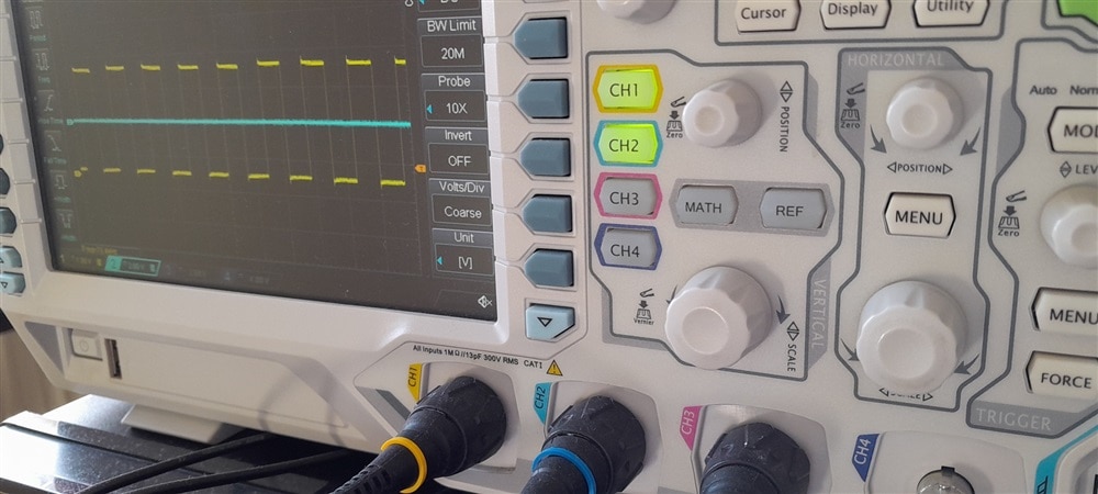

    Using an old school counter to validate the stepper motor firmware:
    My oscilloscope can do that too, as long as I can fit the signal on a single screen. A counter doesn't have that limitation.
