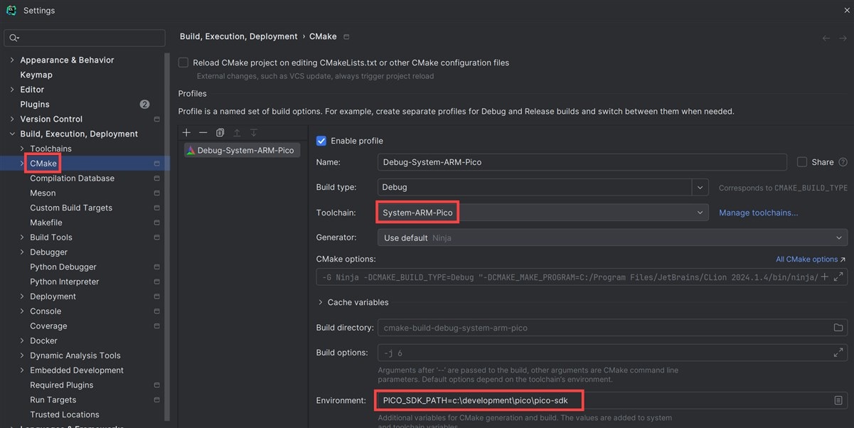

(8) Go to File->Settings->Build,Execution,Deployment->CMake and configure as shown here; notice that the Toolchain called Visual Studio is selected, and not ARM.
In the CMake Options text box, this should be typed:
-G Ninja -DCMAKE_C_COMPILER="C:\ARM_TOOLCHAIN\14.2_rel1\bin\arm-none-eabi-gcc.exe" -DCMAKE_CXX_COMPILER="C:\ARM_TOOLCHAIN\14.2_rel1\bin\arm-none-eabi-g++.exe
In the Environment text box, type:
PICO_SDK_PATH=c:\development\pico\pico-sdk
If you're using PICO-EXTRAS then use this line instead:
PICO_SDK_PATH=c:\development\pico\pico-sdk;PICO_EXTRAS_PATH=c:\development\pico\pico-extras
Click Apply/OK.

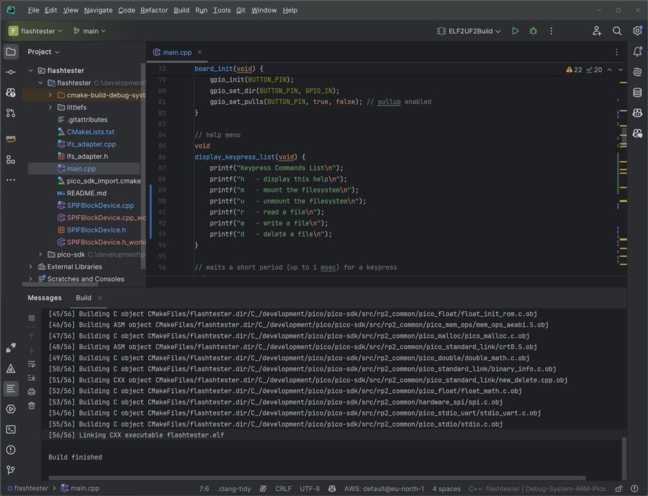

The screenshot below shows what the environment looks like while coding. The top-left pane shows the file names in the project, and double-clicking on a name will display the code in the right pane; that’s pretty standard.
I like that for each function call, CLion will display the description of the parameter as shown with the red arrows.
Another powerful feature is the Structure pane (go to View->Tool Windows->Structure to open it). It shows a kind of summary of what’s in the code file. I frequently look at that while coding, to recall the names of (say) global variables, or functions and their parameter types. It’s a huge time-saver.
A super-powerful keypress is Ctrl-B. If your text cursor is in any function or variable name in the code, pressing Ctrl-B will immediately either highlight where the variable was defined, or it will open up the file containing that function or variable in a separate tab. You can quickly drill down through nested functions in this way.

(c) In the settings, go to CMake and type as shown here, and click apply or OK:
(d) If you have a project already open, then click on Tools->CMake->Reset Cache and Reload Project and then click on the hammer icon to build the project!

There is one tiny bit of configuration that is needed, which is the text entry field called Environment, indicated with a red box in the screenshot above. It needs to be populated with this text:
Once you have done that, click OK.

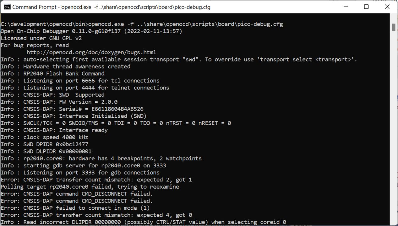

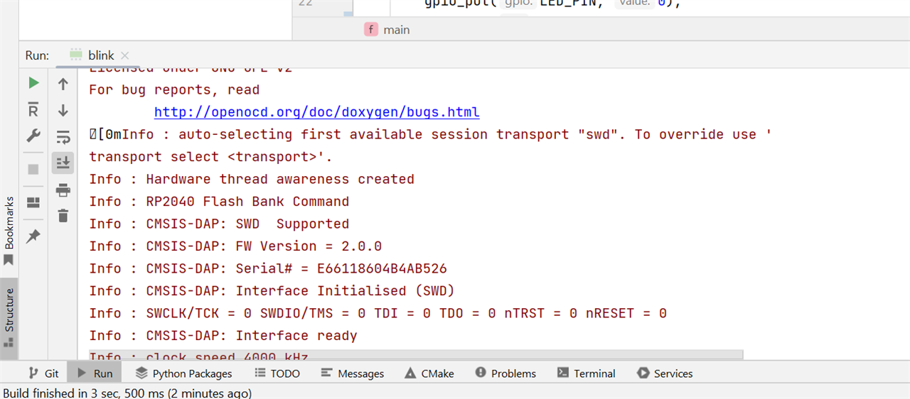

    Hehe I just discovered this too, and gave it a shot, but it didn't function for me,
    I see things seem to start up fine in CLion:
    However then things go downhill:
    It might be an inconsistency between the firmware for the debugger pico-debug-gimmecache.uf2 and the OpenOCD build that was downloaded from some quick toolchain site which is more recent.
    The official OpenOCD release is old, it doesn't support RP2040/pico. I tried a nightly build too. I didn't want to build it myself, because I want a  Windows executable and I'm not set up for building x86.
    Personally I'd rather use a separate debug tool, rather than the one that runs on a core, but attempts to get that working failed too. I peeked at the raspberrypi.org OpenOCD github page, and couldn't figure out how to set up my .cfg file to support the JLink-Lite that I have. I'm not sure if it is a JLink-Lite issue, or an error in my .cfg file.
    I think once these issues are sorted however, CLion will very adequately perform the debug operations, since that's now confirmed working with an STM board with the official OpenOCD release.
