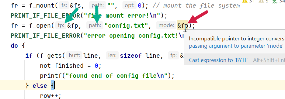

I like that for each function call, CLion will display the description of the parameter as shown with the red arrows.

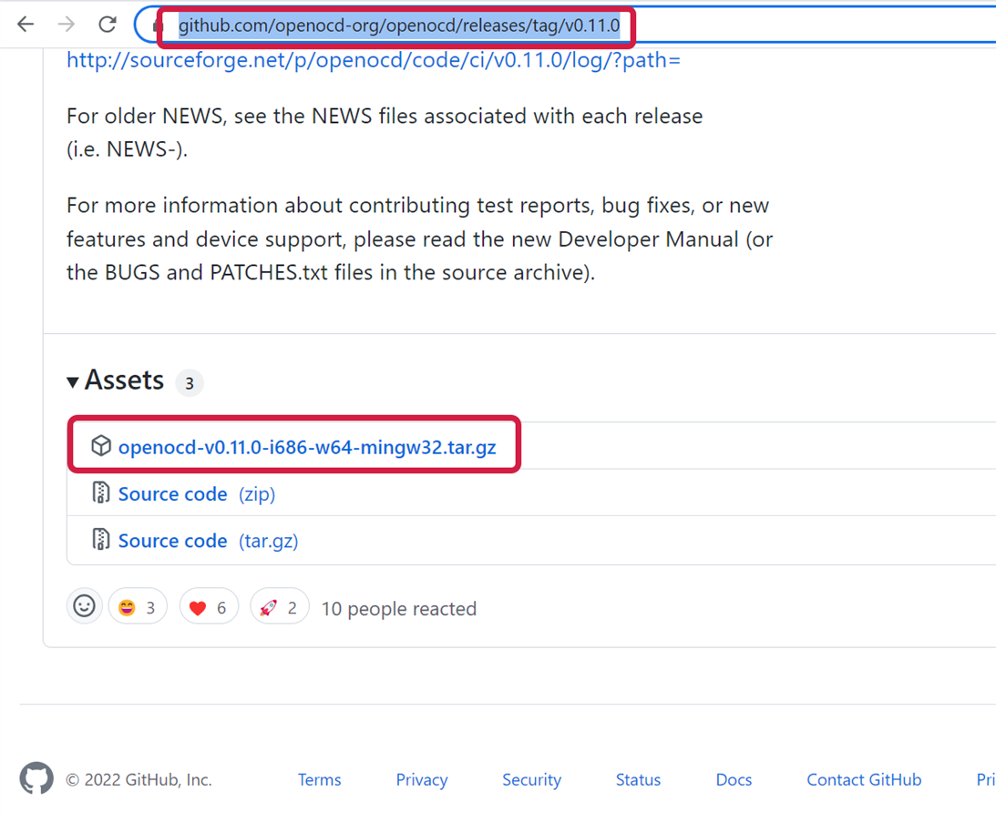

First off, install prerequisite software called OpenOCD, which will talk to GDB. You need a special build of OpenOCD that supports the Picoprobe. If you're using Windows, then there are pre-built versions here:  https://github.com/shabaz123/rp2040tools
Place the software in a convenient location, for instance in a folder called c:\development, such that the path to openocd.exe is c:\development\openocd_rp2040\bin\openocd.exe

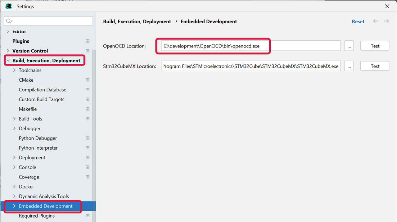

In CLion click File->Settings and select Embedded Development on the left of the pane that appears. Then, configure the full path and filename to OpenOCD (C:\development\openocd_rp2040\bin\openocd.exe if the OpenOCD steps earlier were followed).
Click Test and a green success box should appear. Click Apply and OK.

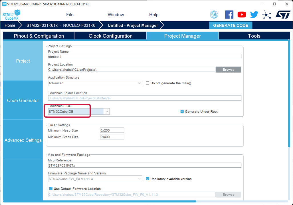

    (3) Initial setup for STM32 family chips - Excellent. Can use STM32CubeMX for an initial config, and then CLion will automatically import it and from then on, the coding and building and debugging is all done within CLion. Within STM32CubeMX, the only configuration is to set the Toolchain/IDE to STM32CubeIDE.

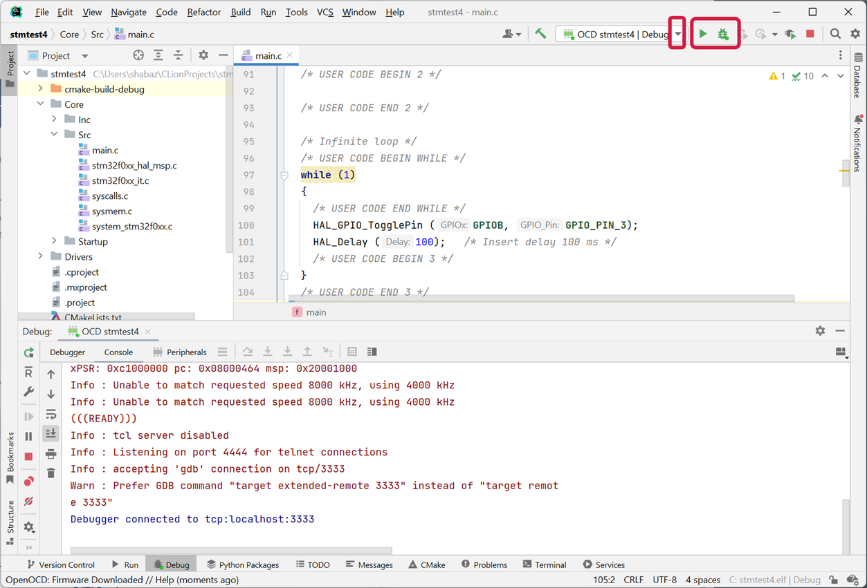

    (6) Debugging for ARM - OK to Good, it supports a couple of options, the one I tried uses software called OpenOCD which is not part of the CLion installer, but is very easy to use.
    Once I had downloaded and extracted OpenOCD to a folder, then in the CLion project I needed to point it to the OpenOCD executable.
    I also needed to find a configuration file for the microcontroller or board in use, it's called a "board config (.cfg) file". The files come with OpenOCD, there are several hundred of them. I tested with a Nucleo STM32F031 board, and there was a st_nucleo_f0.cfg file that worked.
    CLion seemed to detect the integrated J-Link on the Nucleo board and it ran the code fine, although the messages in red at the lower pane looked like an error, but it wasn't:
    Breakpoints are inserted by clicking in the margin in the C file of interest, and then when the code is run, the usual controls are there, and variables can be inspected and so on, I have not explored much so far.

    I'm currently working on a project where I'm pulling in reasonably large volumes of third party code which I am not familiar with, so having an IDE with the code structure and code navigation support helps loads. CLion automatically checks what I'm typing matches both the Pico SDK function and type definitions, as well as all the functions and types in the libraries I'm pulling in, and I didn't need to do anything to set that up. Visual Code can do that, but not with the way I have it set up. It just takes longer to set things up with VS Code since there are so many extensions and options, and at some point I just work with what I have, since it's good enough. But for a complex project, there's no doubt that hours/days/weeks of effort would be saved, so the cost of the tool becomes trivial. I purchased UltraEdit licenses for quite a few years simply because (at the time) it was ahead of any other text editor, and it improved productivity on a work project. An hour saved paid for a year of UltraEdit. I don't use it now, because other editors have overtaken it.
    In the example below, the function f_open is in a separate library of code, and I'll get immediate information about what each parameter to it is. If I get the type wrong, the box will indicate that (as shown with the red arrow).
    I'm thinking how I'll write up my project. If I ever want to expect someone to build it themselves, I'll have to make a couple of suggestions, because it's non-trivial to set up the environment for most IDEs. I might make a free suggestion that uses the command-line, and another that uses Visual Code since I've already written up the process for that, and perhaps CLion since that's easy to initially set up and use.
