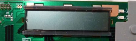

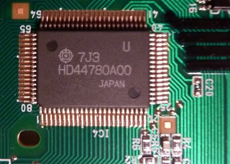

How do I get this to display messages, text, etc; through GPIO?  I have seen others do it before but they never state or tell how they do it.
I want to know if this is possible to do and how difficult it is to get the software for it.
This is my screen:
This is the chip:
How do I wire them togther (they are already on PCB togther)?  How do I wire them to GPIO?
I can work off schematics and can follow very basic instructions (but can not compile software).

    The problem I am having is that the Screen is already mounted on a PCB.  I don't know which pins to send to Raspberry Pi.  See the image above.
    Also, it connected to the rest of the fax machine via a 16 pin flat ribbon cable (which the socket is acessable from the rear - not pictured).
    Can I use any of these pins to acess the display?  And is the power for the display the same as what it was connected to on the fax machine (the two pins on the top left)?

    I have worked out that the 16 pin connect on the back of the board is for the display interface.  The two connections on the top left is a ground connector.  All I have to is desolder the 16 pins of the connect on the motherboard and away I go.  (any advice for desoldering 16 pins?)

    It ought to be possible so long as you have access to the HD44780 chip pins which you do. You have already discovered the power rails, so there are just 8 data pins, 3 status pins plus possibly the contrast control pins, these probably do come out to the connector but might not and you may possibly have the backlight control coming out to the connector.
    Page 4 of the http://www.sparkfun.com/datasheets/LCD/HD44780.pdf datasheet shows that DB0:7 are on pins 39...46 of the 44780 chip and it also shows that RS, RW, E are on pins 36....38 . Once you've found and mapped these on a piece of paper that leaves just 3 pins unaccounted for on your 16 pin connector. If two of these remaining pins trace to one of the power planes the third one is likely to be Vo which is the contrast control. If they don't then they could be the backlight switch.
    If RW pin doesn't seem to be represented on the connector check to see if there is a direct connection between that pin on the 44780 chip and ground.

    Could I make my own interface off the HD44800U Chip?  Say: Desolder the certain pins of the chip that I know and run a wire straight into the chip? from the Raspberry Pi?
    Is that possible?  I have scene it all over the internet but is there a special techque required?

    This is not a route I would take, but is possible, bear in mind not only is there a likelihood of breaking the pins, overheating the chip, plus trying to solder wires to the pins won't be easy if you are not experienced wit soldering nor have a fine tip and the correct size solder 0.6mm or less would be ideal.
    Did you not get anywhere in tracing the pins to your connector?
    The easiest thing by far would be to purchase a surplus 2 * 16 display if you cannot afford a new one.  Rockby or Oately Electronics  in Victoria and NSW respectively woul be a place to look for surplus.
