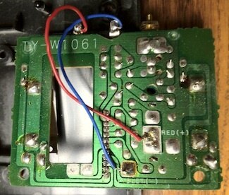

I was wondering if anyone could help with direction on making my idea a reality. I would like to wire the remote control of an RC car to the GPIO pins of the Raspberry Pi. I just do not know how to "make the connection" between the GPIOs on the Raspberry Pi and the remote's switches that drive the car. Ultimately, I was thinking that I could easily drive the Raspberry Pi around on this RC car, if I could activate it's switches.
To start, I only want to send one signal from one of the GPIO pins, and make one track go one direction (to make things easy). To help understand I've snapped some pictures and took a reading.  The remote, after taking it apart looks like this on the top:
And this on the bottom:
When I have it on, and place the voltmeter on it, I get a reading of 4.36 volts:
So my thought is that I should have something between the GPIO pins on the Raspberry Pi, and the J1-J4 headers on the remote's board. The remote control itself uses a 9V battery. Should I use transistors to convert the 3.3V signals from the Raspberry Pi to try and match the 4.36V that is running across the remote's switches?

    When I'm trying to do something like this, I generally try to extract a schematic of the circuit board I'm trying to adapt.  It looks to me like your remote has four switches, where pressing a switch connects J1-J4 to a common signal, which is probably ground or the negative terminal of the 9V battery.  If that's the case, RasPi can drive NPN or NMOS transistors which act as surrogates for the switches.  If the common signal is ground, you only need to pull down to ground and you don't need to worry about generating 4.36V.  Use the multimeter to measure the current between the common signal and J1-J4 to see how big a transistor you need.

    Looking at your photos, it looks like the blue wire is the common ground and goes to the negative battery terminal.  It looks like the red wire is +V (it's labeled "RED(+)" on the PC board) and probably goes to the positive battery terminal.  You can verify this by looking at how the 9V battery snaps in.  The battery's terminals are labeled + and -, so you can see which wire corresponds to + and -.
    To check how things are connected together on a PC board, put your multimeter on its most sensitive Ohmmeter setting (usually 200 Ohms) and make sure your PC board power is OFF -- take out the battery.  Then press the probes onto two points you think might be connected.  If there is a conduction path between them, the Ohmmeter shows the resistance.  For a wire or PCB trace, the resistance should be near 0 Ohms.  There is some resistance in the probe leads, so touch the probe tips to each other and see what that reads.  Usually it's between 0.3 Ohms and 0.5 Ohms.  You need to subtract that when you measure resistances on the PC board.  Also, you may need to scratch flux off a PCB location to make good contact.
    So put one probe at the blue wire terminal where it would connect to the battery.  See if it's really connected S-shape springs that are used as switches.  If they connect, you're in great shape because you can just use NPN or NMOS transistors to act as surrogate switches.

    It shows how to use RasPi to drive a small relay.  There is a schematic diagram that shows using a 1K resistor R1 and an NPN transistor Q1 along with other components.  In your case, you should only need R1 and Q1 for each of your four switches.  The flyback diode D1 is only needed for an inductive load like a motor or speaker.  Also, you won't be using RasPi's 5V or 3.3V.  You only need the transistors to pull down -- the pull-up circuit is on the remote control's PC board.
    But first check that the common ground is indeed the negative battery terminal so you can use NPN transistors.  Then, with the power on, activate one of your switches by using your multimeter as an ammeter.  This will tell you how much current has to go through the transistor.  If it's less than 30 mA (and the ground is the battery negative terminal) you should be able to use the R1 + Q1 circuit.
