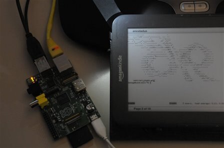

I saw this on the RPi.org website this morning and I thought that it would be easier to do the whole set-up just without the Raspberry Pi connected to the USB port on the RPi.
I have a Kindle 3 Wi-Fi edition.  An Edumax USB Wi-Fi adapter. A Raspberry Pi.
Will this work and if so, ... how would I configure the /etc/network/interfaces file so that I can use wlan0 as an Ad-Hoc Network between the Raspberry Pi and the Kindle?  With the Raspberry Pi with a static IP Address and the kindle (doesn't really matter what IP address - I think).
Then, He says something about using the USB keyboard attached to the Raspberry Pi, that should work the same right?
I still have to Jail-Break my kindle and install all the hacked software but I though I would raise the Question of the Wireless KindleBerry Pi.

    The Instructions are very vauge.
    The first part, connecting the Kindle to the Raspberry Pi is simple enough. Jail break the Kindle , install a terminal emulator like this one and then install UsbNetwork. Make sure the usbNetwork is enable, Connect the devices trough USB, do a quick ifconfig usb0 192.168.2.1 and Voila, I can login into the Raspberry Pi with no problem, using the great display of the Kindle but sadly also using it’s limiting keyboard.
    This would be ideal if you knew exactly what you are doing.  I don't.  I have, though, completed the above with great difficulty.  I will write out some detailed instructions later.

    Just a quick update:
    I have got the kindle and screen working better than before without the code that was on the instruction page.
    My instructions are as follows:
    1.  Install the package 'screen' on the RASPBERRY PI.  sudo apt-get install screen
    2.  Run screen on the RASPBERRY PI by typing: "screen" at the terminal
    3.  Using the KINDLE - open a terminal sesson and then, SSH into the raspberry pi (This is for people who are using the wireless interface, using existing infrustructure)
              On KINDLE: "ssh root@192.168.12.1"
    4. Log in. (that is: type password; type "y")
    5.  On the KINDLE type: "screen -x"
    6.  All Good, you have succeed!
    I am going to work on a start-up script and improve on the ad-hoc network stucture later (not used above).
