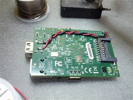

    I had a similar issue with USB devices while powering the Raspberry Pi from the GPIO headers.  I was able to overcome the issue by directly connecting the 5V and GND of the GPIOs to the 5V and GND of the USB.  The attached image is of a modified rev1 board, but should also work the same for the rev2 board.  Not exactlty the most elegant of solutions, but it was just the quick and dirty fix I needed.

    It's kind of scary that adding the wires fixed the problem.  After all, with a rev 2.0 or an Ohmless rev 1.0 the GPIO 5V and GND pins are directly wired to the USB jack according to the schematics.  The fact that adding wires changes behaviour suggests that the 5V trace to GPIO is pretty narrow.  Sure would be nice to see those Gerbers image
