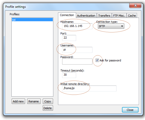

    0 e14 Contributor over 10 years ago in reply to shabaz

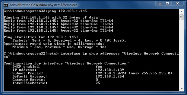

    Sorry, i got the exact mistake, i actually cannot establish the connection between the two, after i click that Dis(Connect) pane on the window, it doesnt connect to my raspberry.
    0 shabaz over 10 years ago in reply to e14 Contributor
    The screenshot below shows my settings, yours needs to look something similar.
    You can confirm if your raspberry pi is reachable by typing 'ping xx.xx.xx.xx' in a
    Windows command prompt first (where xx.xx.xx.xx is the IP address of your
    Raspberry Pi). If the ping is not successful, then there is a network related issue.
    The ping should always be your first test to ensure that you have reachability.
    Bear in mind, this won't (usually) work if the only path between you and the Raspberry Pi is the public Internet. Where is your Raspberry Pi and PC located - in the same physical location?
    This is what the ping output could look like, your addressing will be different:
    (Type ipconfig /all if you're unsure what network connection is in use on your PC). You can see that my PC is on the same network (192.168.1.xx) as the Raspberry Pi.
    Thanks for all the help. I finally got it. I was doing one stupid mistake, my laptop and my raspberry pi were not on same network. thats why it didnt connect
