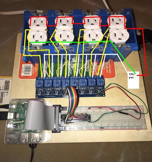

Hello, I will be blunt and honest, This is my first time looking at a Linux system let alone trying to learn to code in python and I'm struggling big time trying to learn this all. I need a coding mentor who is willing to communicate with me and help me get this done. Ahead of time, I apologize for my lack of vocabulary and my unorthodox techniques and perspective and thank you for your everlasting patients and I really appreciate any and all time you invest into helping me!
Question: Will you look over my project (posted below) and help me get it coded? ideally, i would be able to have an interface that would allow ease of use programmable on//off cycle on each outlet (all 8) and also in addition to, a simple toggle on//off of all 8 as well.    ( example:    [OUTLET 1]  on=15 minutes   off=45 minutes * repeat*
                                                                                                                 [OUTLET 2]  on= 16 minutes   off=44 minutes *repeat*
                                                                                                                 [OUTLET 3]       on=2pm         off=11pm
                                                                                                                 [OUTLET 4]      ON
                                                                                                                 etc....etc......)
Here's where i am so far the best i can sum it up;
Pi3
Relay       Diagram of relay
CanaKit GPIO to Breadboard Interface Board
This is how i wired the relay to the main power source
Below is a how I wired the breadboard to the relay. (Picture is visual rep of it written out)
Relay       |      Gpio#
JD=Vcc            5v
GND                GND
Vcc                  5v
1n1                GPIO 17
1n2                GPIO 27
1n3               GPIO 22
1n4               GPIO 23
1n5              GPIO 24
1n6              GPIO 26
1n7              GPIO 12
1n8              GPIO 16
what do you think? Can you tailor some code for me? I'm sure the code is out there some where, I most likely just need some guidance on how to fine tune it to my wiring/setup.
                                                  Anxiously and hopefully awaiting a response
                                                                      ~Mathew
* WORKING WITH ELECTRICITY IS EXTREMELY DANGEROUS. DO NOT TRY THIS. THIS IS A HYPOTHETICAL PROJECT NOT MEANT TO BE DUPLICATED OR REPRODUCED BUT FOR EDUCATION PURPOSES ONLY. ALWAYS USE ALL SAFETY STANDARDS WHEN WORKING WITH ELECTRICITY PER YOUR AREAS LAWS AND REGULATIONS*
Message was edited by: Mathew Rawlings THANKS PETER

    Logically, everything looks good.
    Electrically ti are not following safe standards and while it is up to you if you do this on your projects, you need to consider that others will follow your example
    The relay board should be in a safe housing. It has mains on it and as such should be correctly protected from people sticking their fingers into it.
    Using standard and approved power outlets is a good thing, especially if they are in the approved enclosure and with the right covers in place.
    You need to add words of wisdom indicating to viewers that if they are not familiar with working with mains then they should get help from someone that is., add the fact that not doing this can lead to death or worse.
    You need to add that Electrical Code is different for each country and province so people should be aware and follow their local codes of practice or dont do this.
    Hope this helps
    Peter

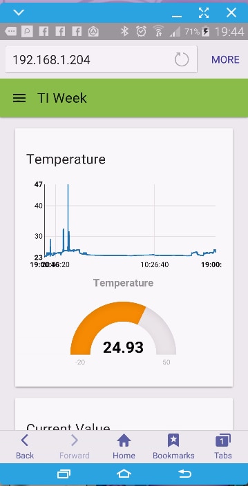

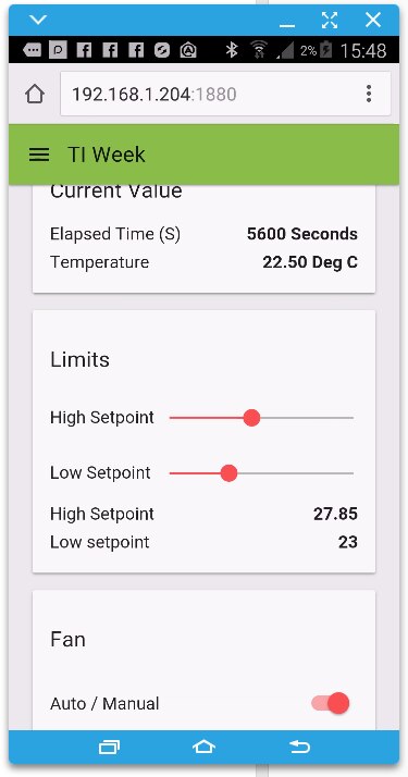

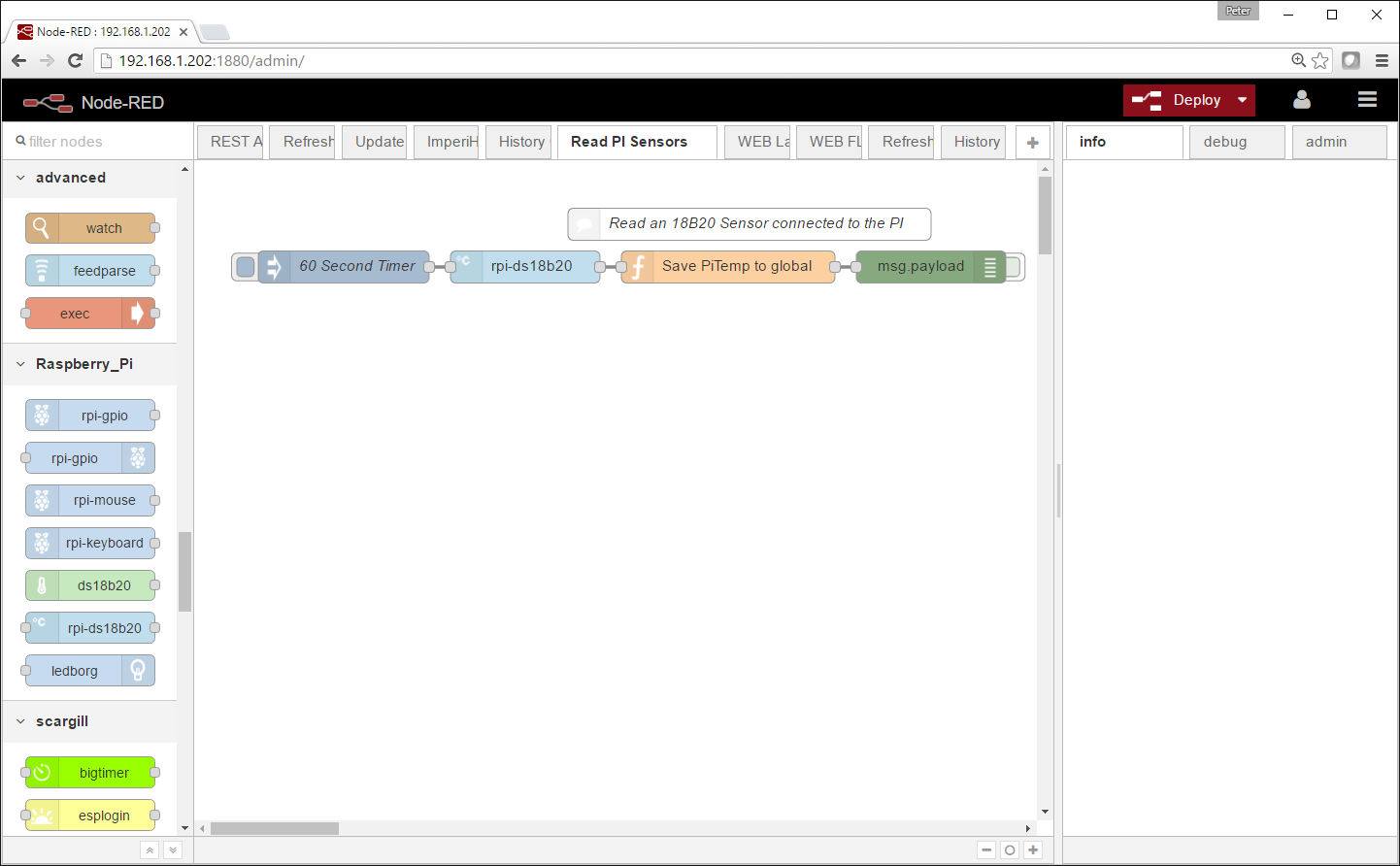

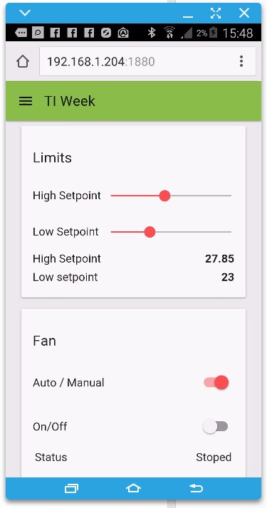

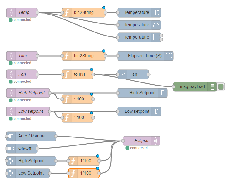

    Looking at what your doing with the GPIO etc and also the scheduling of the GPIO, I think using Node-Red would greatly simplify the design of the solution.
    Node-Red is a graphical Design environment and is fully supported on the Raspberry PI... And it is Free and with the latest versions of Raspbian, it is also part of the image.
    There are nodes designed to directly interact with the GPIO of the PI and you can also script in Java or call python if you want.
    This is what a design could look like
    ,image
    this produces a WEB UI like this (I took 3 pics as I scrolled down)
    and for output to GPIO there are design elements like this
    Note the set of Raspberry PI nodes on the left and the great big BIGTIMER below that. BIGTimer is a node that can handle scheduling for you and was written by a good friend of mine.
    Also note the light blue node second in that is used to automatically handle a DS18B20 temperature sensor.
    So in summary... Node Red can provide the interface to the hardware for you in an easy to use way, it can provide a WEB based UI for you to interact with your project from any smart device, it can schedule tasks. It is free and runs on Linux.
