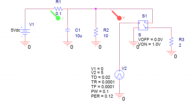

    Wouldn't it be easier to use an O'Scope to measure the input voltage during the "hang" to make sure that voltage drop is the actual problem? This would be my first step because I would think it highly unlikely that an update would use enough extra current to drop the voltage enough to cause a micro to stop functioning.
    Is the Pi controlling the sprinkler system through logic control or is it actually providing the power to a valve?
    10uf Cap
    1000uf Cap

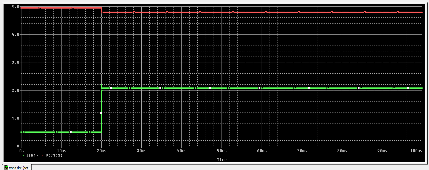

    Notice the drop in voltage is about the same with a 2A jump in current. R1 in the schematic represents the incoming wire resistance to the Pi. If all the power to the Pi and sprinkler run through that one wire then I would focus on fixing that. Use two separate wires or one large one. That resistance will be the primary driver for voltage drop.

    Jason, that's a very good suggestion. Usually it is quite difficult to catch "occasional" problems. But for power supply sagging problems you can indeed put the scope in "normal" mode (as opposed to "single" or "auto") and set the trigger point at say 4.5V. Then you'd end up with a trace of "the event" when it eventually triggers. On the other hand, not everybody has an oscilloscope.

    Thanks for running those tests and the resulting graphs! From what I see, it looks like a capacitor wouldn't really make any difference - is that correct?
    And the conclusion being pretty much what everyone else was saying - upgrade the power supply.

    Yes, the capacitance on the input to the Pi would probably not fix the issue you are having. Upgrading the power supply and the USB cable would help greatly but the post you mentioned also included wire gauge and current ratings. A typical USB port can only supply 1.5A anyway.
