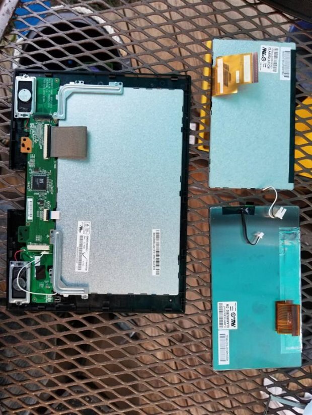

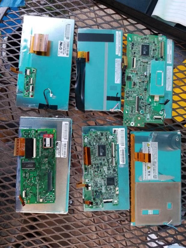

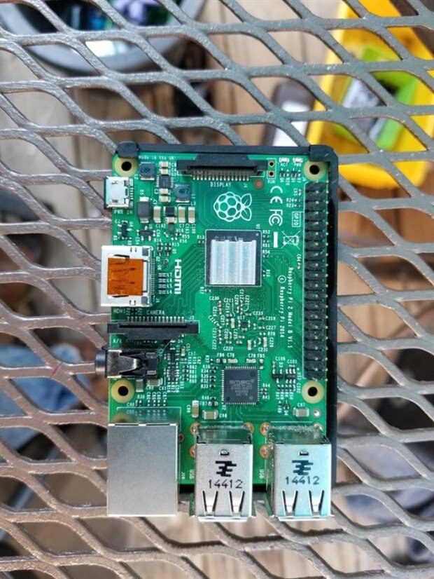

Let me start off by saying I am a noob at this stuff but a fast leaner.  This is something I have been wanting to do for a while which is to make a portable gaming device with a raspberry pi.  Now I have the raspberry pi but can not for the life of me figure out how to connect a TFT screen to it because the cables do not fit the pi itself.  I have 8 lcd's with with 4 of them having a removable touchscreen, and one portable Blu-ray player.  I  have looked really hard to find someone using theses types of screens but almost all of them are using ones with a red, white, and yellow cables.  I really want to use the Blu-ray player  because I can also use the case and the rechargeable battery pack which is another issue because it pumps out 7.2v and I am afraid that it might short out the pi.  Can anyone please help me with this?imageimageimage

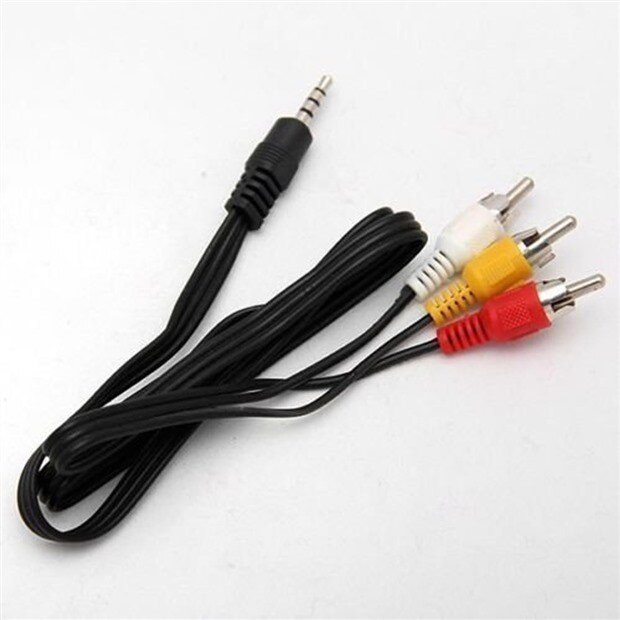

    Maybe I am not understanding your question, but if a TFT screen you have uses the "Red, White and Yellow" cables, then yes, the Raspberry Pi can send video to that screen.  This picture is just an example I grabbed from the internet.  The yellow connector is Composite video that Shabaz mentioned.  (Red and White are RCA connectors from stereo sound). (This picture is just to confirm if these are the connector shapes on your TFT screen)
    (sorry, it's a much bigger photo than I expected)
    The Raspberry Pi (model 2B) has a 3.5mm jack for Composite video.  You need a cable to make it work with a TFT screen.  Like this one:
    Allen

    No it does not have yellow,  red, and white cables.  It has a ribbon cable and a pink and white power cable.  The ribbon cable fits but the screen is from a car radio so I think it is a 9v screen.  I also have a DVD player with output only and no input.  So I am trying to figure out how to connect it to the pi.
    0 shabaz over 8 years ago in reply to wayne.t.johnson
    If the ribbon cable is a flat flex cable directly from the TFT, then that's near-impossible to use easily, because there are many different configurations of interface and connector, and it would become a game of luck trying to find some adaptor or controller card that definitely works, and costs less overall compared to just buying a new display that is already intended for the Pi.
    If the ribbon cable is from some circuit board, you may have some luck trying to trace connections - without a circuit diagram some detailed photo would be needed to see if this is possible.
    The DVD player has an output, but internally the TFT accepts input signals, so any chance of getting it connected involves opening the player - but it is unlikely to be easily usable, because there is no need for the player internals to have any accessible HDMI or composite signals.
