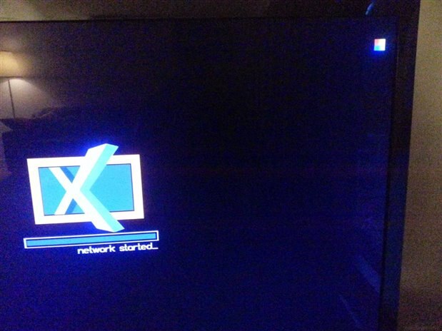

Hi,
I have 3 Pies
#1  1x Model B with 2 USB ports
#2  1x Model B+ with 4 USB ports
#4  1x Pi2  (there is only one model, right?)
I have used all 3 to run Openelec.
#1 works perfectly

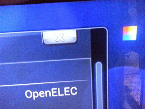

#2 and #3 also run openelec but they both show an artifact on the top right-hand corner. It seems to be a miniature version of the colour screen that is shown right after the Pi wakes up but before it runs an OS.
Has anyone else seen this????
Cheers,
Nick
    0 e14 Contributor over 11 years ago
    It's a low-power warning. It shows up when the 5V supply goes below 4.65 if I remember correctly.
    http://www.raspberrypi.org/forums/viewtopic.php?f=29&t=82373

    0 e14 Contributor over 11 years ago in reply to e14 Contributor
    Thank you very much Ragnar!!!!!
    That's exactly what was happening.
    I've had issues many years ago with crappy USB leads, so I started buying one at a time from different ebay vendors until I found one that had cables that could carry 2,000 mA and then I bought a dozen or more from him, tested them each and gave most of them to my friends who were complaining about slow charging times.
    (I also bought a bunch for myself)
    So, when I saw your message, I collected a few of my 5V, 2,000mA power packs and tested them (as well as 2 different cables) with the Pi2.
    Voila!!!
    One substandard cable in the bin later and the Pi is happy.
    Thanks again,
    Nick
