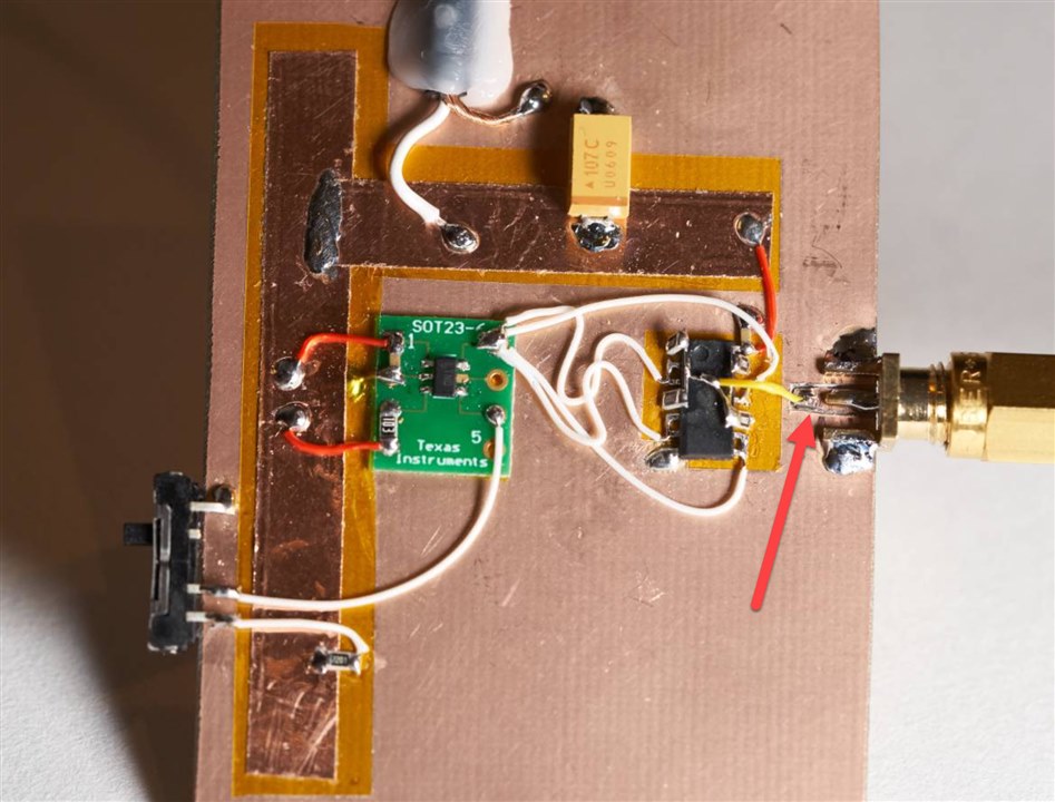

    (or cladboard - unetched PCB, and an exacto knife. Costs virtually nothing, lasts for years. The cheapest impregnated paper board works more reliable than a breadboard)
    (impregnated paper is also easier on the knife and lungs than fiber boards)

    The paper boards are brilliant for prototyping! Easy to drill too, with the most cheapest of drills, if that is needed (usually doesn't need drilling at all for quick prototyping).

    I've not heard of these. I will have to take a look.I normally breadboard and then perf board a CAD PCB design. If it works I'm confident the PCB electrically works. The physical part is where I get into problems.
    Jan Cumps over 3 years ago in reply to colporteur
    Action photo:

    There's some info here with a short video:
     Copper Clad Prototyping Tools
    In brief, the rotary tool there wasn't useful for this prototyping method (but is _extremely_ useful for cutting fine traces on ready-made PCBs). The "scorper" tool is very handy, but exacto knife would be as effective too. I still have not perfected a technique with the scorper (I recently purchased a second scorper with a slightly different shape, but I think it is possible to do better).

    You can modify that slightly by using this approach:

    That technique is featured in the video Stuck out tongue winking eye. It's a treasure throve of reliable prototyping - with a little flavouring with high frequency sauce

    Also sometimes tape can be added to the mix, i.e. cut out some parts, and also use tape where it's convenient. Not as rugged though. More pricey too.. conductive adhesive versions of it are crazy expensive now compared to a few years ago (although a reel of the tape could last for years).

    With cladboard, there is also the technique to cut round isolated pads with a broken drill or special tools.
