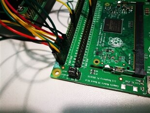

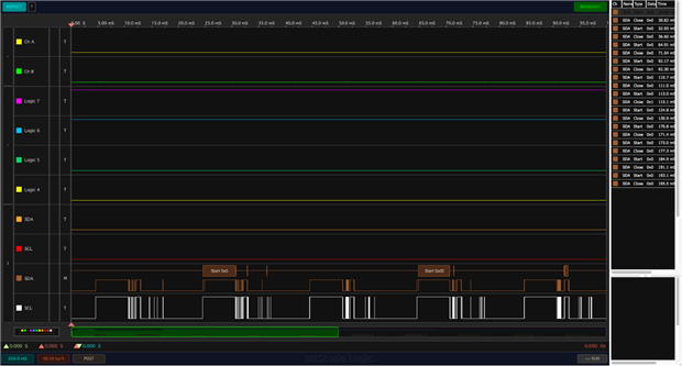

This is a strange issue I have no idea how to solve; it seems I am unable to debug correctly the problem to find at least what class of issue it is.

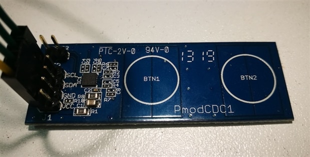

I have tried several I2C devices set as slave including Infineon XMC1100 Boot KitXMC1100 Boot Kit and Arduino UNOArduino UNO. Then I moved to the simple two cap sense buttons PmodCDC1PmodCDC1 by Digilent; as the device is powered and connected to the I2C bus it starts in continue sending data. I should expect to see at least its address will be detected by the CM3 I/O board but nothing happens.
I2C has been set and enable correctly in /boot/config.txt and the raspbian version running on the eMMC of the CM3CM3 is the latest Jessie (July, 5 , 2017). Signals are connected to the GPIO2 and GPIO3 (SDA1, SCL1) accordingly with the eLinux table specifications (see in attach) to the GPIO Pins 2 and 3. Digilent device is powered with the 3V3 and voltage is correct and stable.
I have not used external pull-up resistors on SDA/SCL signals as the CM3 already includes 1.8K pull-up resistors on these two lines, following the CM3 peripheral recommendations.
Initially I though that it was possible that wrong resistor values was blocking the signals to go up but as shown in the video below, hardware seems working fine. Note that when I send a i2cdetect -y 1 command from the terminal data are sent by the CM3 side. But nothing is shown.
Any suggestion is welcome.

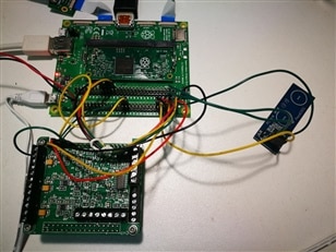

Supposing that despite what the documentation says the internal pull-up resistor is not enabled I have added a 1.5K resistor pulled up to the 3V3 (the nearest I have at home respect the declared in the documentation (1K8). What I get with the protocol analyser is a series of packets as shown in the images below but always nothing is detected by the master (Pi side).
Last update
After trying and discussing with all the helpful members that spent time with me I have received in the meantime a second Pi Compute Module IO board and as all the suggested tests and possible mistakes was converging to the right setup for the I2C protocol, as expected, the problem was for  some unknown reason the board itself. As I replaced the board with a new one things started working perfectly.
Thanks to shabaz Robert Peter Oakes rew Jan Cumps and... johnbeetem for the useless suggestion of the thread image LoL

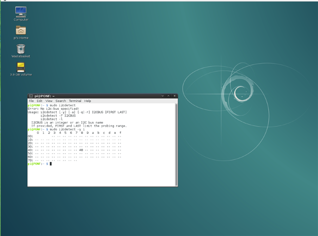

First test: a new microSD with the Raspbian Jessie Lite has been set and after booting the Compute Module 3 Lite I have done the same setup of the Compute Module eMMC. At this point bot boards runs the same version. And after sudo update / upgrade the command i2cdetect -y 1 works perfectly! So we can think 90% sure that the issue is in the Compute Module 3 with eMMC memory. Remain a last test to see if this issue is systematic or not: flashing another Compute Module 3 eMMC and see if it work.
Update - Conclusion
After doing the test mentioned in the update above a new Compute Module 3 eMMC board has been setup with a fresh installation and with the same connections of the previous settings, same Jessie Lite July 2017 and I2C protocol worked immediately without problems. So, the main issue was the CM3 eMMC board and the I/O board kit.

    Isn't it strange that the digilent component starts sending data as soon as it's connected? It should be the RPi as master that gives the clock and send the first contact. And then keeps sending the clock as long as it wants to read?
    is the digilent kit an i2c master?
    Jan Cumps over 9 years ago in reply to Jan Cumps
    I've just read the datasheet of the pmod.
    It will constantly sample, but only send data when you send the right commands over i2c
    It should never decide to use the I2C bus on it's own will, without being asked by the master.
    It's i2c address (7-bit) is 0x48.
    depending on your i2c driver, You'll have to use either 0x48 and tell it you either want to send or receive data,
    or use 0x90 for reading and 0x91 for writing.
    If your i2c detection tool doesn't return anything, there's something is off. Does that same RPi board detect other i2c ICs when you attach them?

    Jan is correct that there are two ways of writing the I2C address. The "i2ctools" of which i2c-detect is a part, will use the first method: 0x48. So you should expect to see somethign on address 0x48.
    balearicdynamics over 9 years ago in reply to rew
    I know Roger, and it is the minimal basic expectation I have, to discover the slaves connected to the bus when I launch the command.

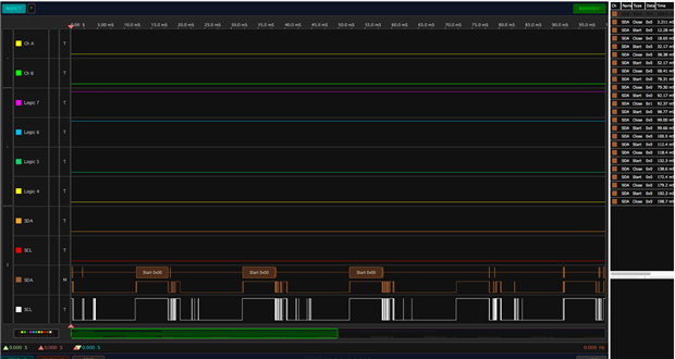

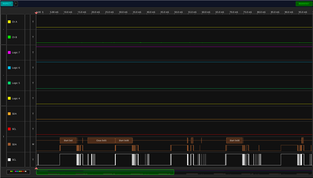

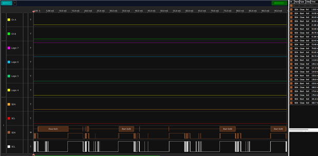

    I haven't had the time to go through the "too many" steps to look at your traces. But from the fact that there ARE traces, you're well equipped to find the problem. (click on image: still too small to see, then enlarge, and still to small (scaled down) then open image in new tab, then click to enlarge. THEN I can read what is going on.)
    When you just connect things, I expect the bus to be idle. Doublecheck that.
    When you run a scan, you should see a single byte being transferred, and when i2c-decoding is on you should see something like READ FROM 0x08 NAK  This is the host sending 0x11 (read + address =0x08) and nobody acknowledging the request.
    So, start the logic analyser, run the i2cdetect, and look for the 0x91, the probe at 0x48. Check to see if you can find the ack/nak. And/or enlarge that portion and post the screenshot.
    Jan Cumps over 9 years ago in reply to rew
    it also seems that the clock signal looks more like a data signal. That's not how I expect an i2c clock to look like. It may be because of sample rate, or because it's not the i2c clock ?
