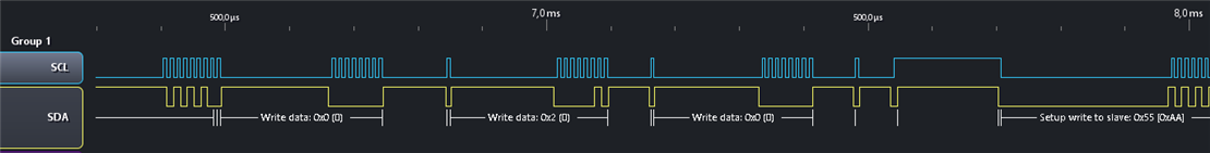

This is a strange issue I have no idea how to solve; it seems I am unable to debug correctly the problem to find at least what class of issue it is.
I have tried several I2C devices set as slave including Infineon XMC1100 Boot KitXMC1100 Boot Kit and Arduino UNOArduino UNO. Then I moved to the simple two cap sense buttons PmodCDC1PmodCDC1 by Digilent; as the device is powered and connected to the I2C bus it starts in continue sending data. I should expect to see at least its address will be detected by the CM3 I/O board but nothing happens.
I2C has been set and enable correctly in /boot/config.txt and the raspbian version running on the eMMC of the CM3CM3 is the latest Jessie (July, 5 , 2017). Signals are connected to the GPIO2 and GPIO3 (SDA1, SCL1) accordingly with the eLinux table specifications (see in attach) to the GPIO Pins 2 and 3. Digilent device is powered with the 3V3 and voltage is correct and stable.
I have not used external pull-up resistors on SDA/SCL signals as the CM3 already includes 1.8K pull-up resistors on these two lines, following the CM3 peripheral recommendations.
Initially I though that it was possible that wrong resistor values was blocking the signals to go up but as shown in the video below, hardware seems working fine. Note that when I send a i2cdetect -y 1 command from the terminal data are sent by the CM3 side. But nothing is shown.
Any suggestion is welcome.

    Enrico, can you check that clock signal, and maybe use a higher resolution?
    The capture below (for another ic) has a pattern that I'd expect, with a train of clock ticks generated by the master. It has a rhythm in it. I don't find that back on your captures.

    I agree with Jan, the pictures arent representative of an I2C clock.
    The video however does show an expected clock pattern whenever you run i2cdetect. The problem here is that in the video there is already some activity on that bus even when theres not any expected activity so the clock pattern in the video is just overlaying onto an existing signal. The activity that seems always present isn't expected for an i2c bus and this is interfering with the I2C clock and data that you are sending out.

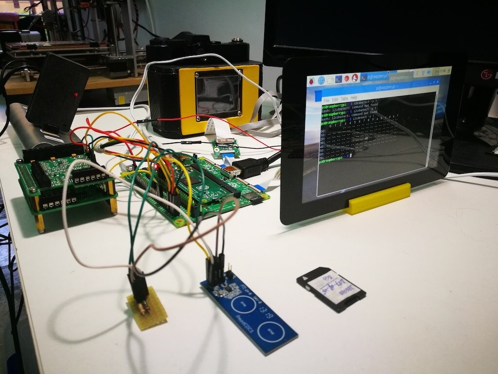

    Update (to be definitely verified). I have set the Raspbian (same distro, full version) jessie on the SD card and CM3 Lite. Setup the board with the following peripherals (not all but almost the base)
    • USB: SSD + Keyboard + Mouse + WiFi
    • Pi Camera V2
    • 7" display
    • Serial PTHat controller
    • HDMI (connected but not shown when the display is on)
    • Digilent I2C capsense buttons
    All work perfectly! And the i2cdetect find the capacitive device immediately. Only with the CM3 Lite boot from 8Gb microSD. Not when boot on the other CM3 + eMMC
    Next step is trying a different CM3 + eMMC
    Enrico

    have you loaded the drivers on for the lcd?
    balearicdynamics over 9 years ago in reply to e14 Contributor
    Yes Luvie, as you can see in the picture it is up and running (showing i2c detected address)
