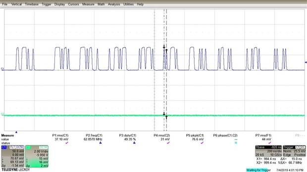

    Using the link you provided I've got direct register access pin toggling working from C.
    Early days yet and I'll post some scope traces once I've made some high speed Pi compatible probes.
    First thing:
    The peripheral base address is 0xFE000000. It  took some time to find this - as ever the official documentation is poor (absent - there are broken links in the hardware documents on the RPi site). On the plus side it was on the RPi forum that I found the answer:
    https://www.raspberrypi.org/forums/viewtopic.php?f=33&t=244031
    I tweaked the code (from https://www.element14.com/community/external-link.jspa?url=https%3A%2F%2Felinux.org%2FRPi_GPIO_Code_Samples )  to make a burst of 4 pairs of:
    GPIO_SET = 127;
    GPIO_CLR = 127;
    I'd set this up so I could only reach it with a 200MHz scope with cheapo probes.
    The pins/probe/scope  can't toggle anything like fast enough but it looks as if the best interval between peaks is 10ns, implying a peak pin update rate of 200MHz and a toggle rate of 100MHz.
    I'll need to make a probe that plugs directly onto the header and move the whole caboodle to somewhere near enough to the 1GHz scope to measure the best that can be done.
    MK

    rew over 7 years ago in reply to michaelkellett
    Nice work! :-)
    I'd recommend not letting this run for minutes at a time. Consider running it for one second, and then let things cool for say ten. It is possible you'd overheat the IO pad if you keep going. When you toggle the IO pin at 100MHz oir more, the "outside" acts as a short. So for the chip it "feels" as if you order it to make the pin high, but then short the pin to ground. You wouldn't be surprised if that breaks things, so you shouldn't be if you try to toggle at 100MHz.
    Stuff like PCIE gets low swing output pads, and an encoding that ensures the pads get the lowest possible number of transitions to encode the datastream.

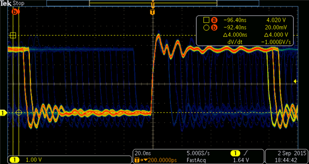

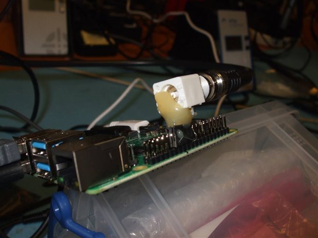

    michaelkellett over 7 years ago in reply to rew
    I've made a little matching pad and coupled the port to the 50ohm input of a fast scope with 1k in series, then 51R to ground (using GPIO7 means there is an adjacent ground pin) then 1m co-ax to scope.
    Getting reasonable waveforms  - rise and fall times about 5ns.
    The code sends 10 bursts of 4 pulses - it's pretty obvious that there is a synchronisation between processor clock and IO clock causing variations in high and low times.
    The IO clock is a bit slower than I thought - perhaps 120MHz but quite respectable.
    The interface pad looks like this:
    The gunk is needed to stop the co-ax from breaking the 0603 resistor between the socket pin and the BNC.
    It looks to me as if one might just about manage a 5MHz bit banged 8 bit bus with handshake !

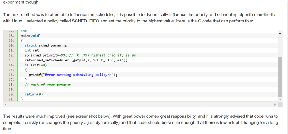

    shabaz over 7 years ago in reply to michaelkellett
    Hi Michael,
    Incidentally (not sure if it will help), in user-space if any context switching is getting in the way over the longer term time period (it won't help with the high/low time variations in your scope trace of course), this code can try to influence the scheduler a little bit - I found it useful when sending multiple bytes over a serial interface, to reduce jitter from byte to byte (not bit-to-bit).
    It is discussed here: Miniature Solar Cells and Improving Real-Time GPIO Performance
