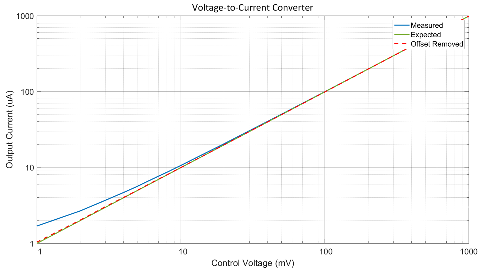

    I still don't know if this would be a useful feature or not.. I'm thinking there's a fair chance people may want to use the PST for characterising the occasional semiconductor, or for applying current to a sensor perhaps, so maybe such a thing is worthwhile. I reckon together with a voltage source too (doesn't have to be super-powerful, could just be 0-3.3V or 0-5V, 50 mA or so), then it could be handy, especially as most people on a budget, students etc., won't have reasonably-precise source generation capabilities, so the Pico SCPI labTool could come to the rescue here.
    This circuit (based on Howland current source) is configured for 0-1mA adjustable output. (I only tested with MCP6024, LM324 is untested. But the MCP6024 is not expensive anyway, so maybe there's no point going cheaper).

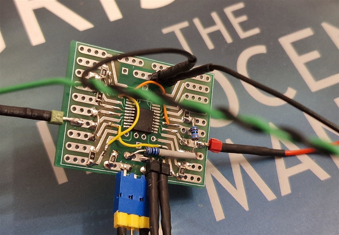

    For the prototype, I used 100k resistors for R1 and R3 (it's not critical, it just changes the result slightly of course, so that it's no longer 1mA per volt).
    Results:
    The main error is pretty much an offset which in my case caused an error of about 0.65 uA, so that could be calibrated out, although that's still a bit annoying. Anyway, I think it's acceptable for a version 1.0, it can be further improved by anyone who needs additional accuracy. I think it already seems precise enough.
    The chart below shows the 0.65 uA subtracted on the dashed line.
    There could also be a 0-20mA output version, if desired!
