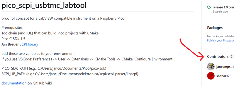

    shabaz over 3 years ago in reply to Jan Cumps
    That's awesome! Plus, extra bonus, it is nice to see who one can blame for the code : )

    fmilburn over 3 years ago
    Really well documented and useful work by Jan and Shabaz…
    Jan Cumps over 3 years ago
    > You'll get a GitHub badge the first time you do this.
