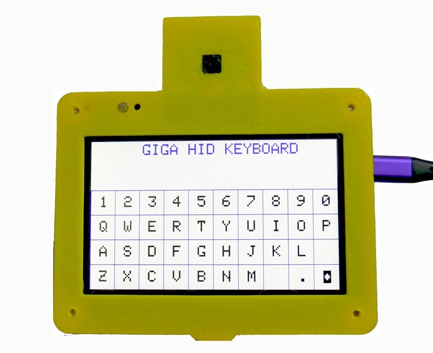

Intro
I have implemented lots of HID style peripherals in the past, but I have never made a capacitive touch keyboard HID before. The GIGA with its touch display means a touch keyboard can be implemented without any extra hardware, so that is what this demo is all about.
Giga HID Keyboard Image
HID Keyboard in Action
Firmware
HID Keyboard using arduino Giga Touch Display
by Doug Wong
2025

Discussion
As mcrocontrollers become more powerful, they increasingly can handle more complex data and peripherals. This HID keyboard capability provides a pretty general purpose user interface which would be unlikely on a simple mcrocontroller because it could be more complex to implement than the actual application. The GIGA and its touch display handle the whole task without even tweaking any hardware. Even the software is easy, with appropriate libraries already available. That isn't to say that I got it working quickly - I went down a few rabbit holes and had a few head scratching episodes, but that is mostly a result of my limited software skills.
This application makes use of the GIGA, its LCD, its touch screen and one of its USB ports.
I did find that I had to implement an enhanced "debouncing" algorithm to prevent extra key presses from being recognized, but in the end it is a pretty robust solution with good sensitivity and the touch area is large enough to make it easy to touch the correct key.
