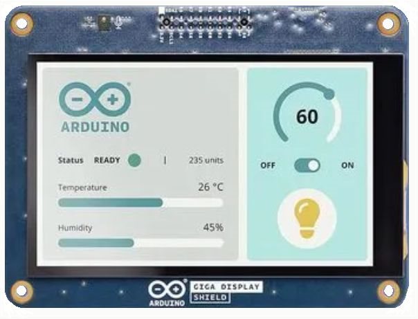

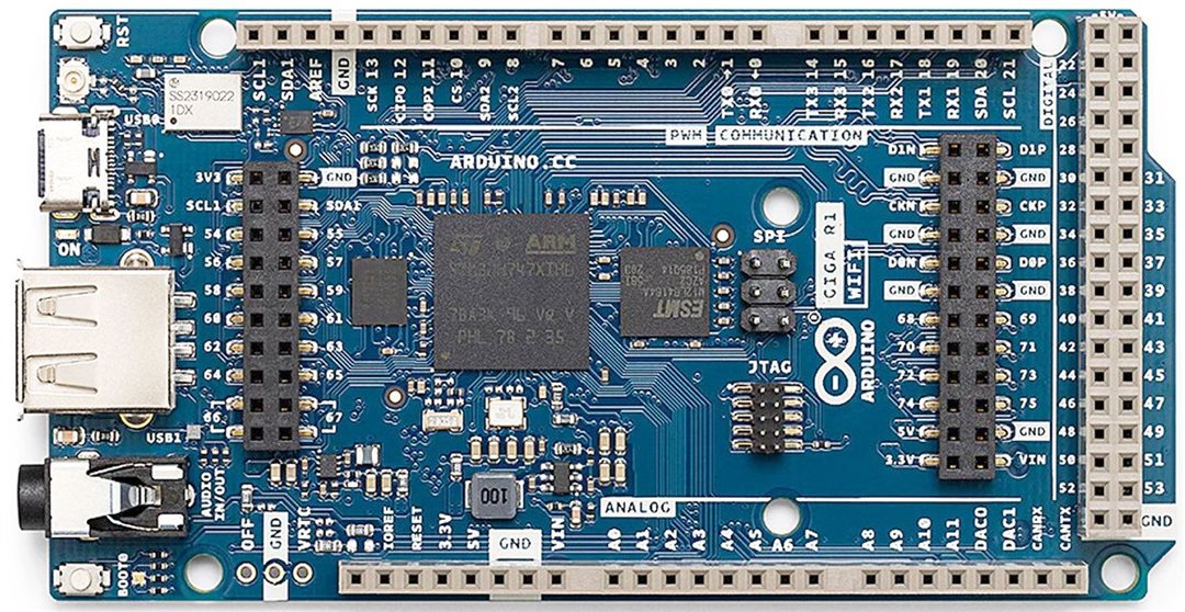

This is the first installment towards an Arduino GIGA R1 Road Test.
Intro
The Giga R1 WiFi could be the most capable microcontroller so far, both from a computing capability point of view as well as an I/O point of view. On the computing side it has both ARM Cortex M7 (480 MHz) and ARM Cortex M4 (240MHz) cores, supported by internal 2MB FLASH and 1MB RAM plus 16MB external QSPI FLASH and 8MB SDRAM. On the I/O side it has 76 DIO pins, 12 ADC pins (up to 16 bit resolution), 13 PWM pins, 2 DAC pins. It even has built-in IMU sensors. For communications it supports USB A Host, USB C peripheral, RTC, 4 UARTs, 3 I2C, 2 SPI, 1 CAN, WiFi (65 Mbps), BLE. It also has peripheral connectors for a touch screen LCD, audio jack, and a camera.
I am really looking forward to exploring this amazing kit.
In this road test I want to implement a series of applications that demonstrate and highlight some of the great features of the GIGA R1 WiFi. This first blog covers unboxing and a little demonstration of the display in the following 2 videos:
