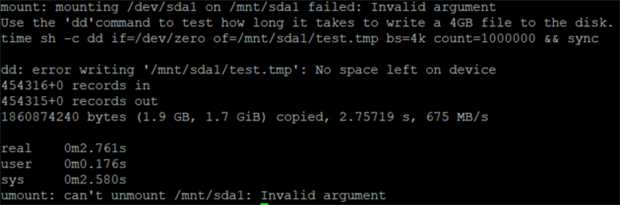

I was initially concerned with possible power sequencing issues because the UltraZed-EV does not have a power connector for the SATA drive only a data interface which means that I need to provide an external power supply.  But SATA is designed electrically for hot plug applications and the data signals are AC coupled differential lines so there is little risk of damage.  I noticed that the ZCU102 board does provide a drive power connector which makes using a drive a lot more convenient, but I can understand the PCB real estate tradeoff.
This seems like a very simple test, but I ended up getting into a lot of trouble because I had formatted the drive as NTFS.

Test procedure
Boot and verify SATA interface is up
dmesg | grep -i sata
Check for the drive using fdisk -l.  Drive is /dev/sda1.  Type is HPFS/NTFS.
Running dd test
./drive-test.sh –d sda1 –t dd
The dd program copies less than 2GB of data before it thinks the disk is full even though fdisk knows that it is a 500GB drive.  Apparently this PetaLinux build doesn't support NTFS.
In Appendix I: Troubleshooting SATA Connection of the test document it states:
Verify that the SATA III drive is partitioned and formatted with a file system that is compatible with the Linux build generated from the PetaLinux project. The FAT32 file system is supported with the provided pre-built image accompanying this tutorial but other file system types might also be supported.
The SATA drive that was used in the reference test was a Delkin Utility+ 64GB SATA III SSD formatted as FAT32.  Windows 10 will not allow me to format a 500MB partition as FAT32.
But I noticed that I could configure the kernel in PetaLinux to add NTFS capability.
So, I built another image and ran the test again.
Now I have a problem because apparently NTFS is apparently read-only!
I discovered from searching that I could probably add NTFS-3G with a Yocto recipe which would allow me to have read/write capabiltiy.  At this point I've decided to punt and proceed doing the test with the drive formatted as EXT4.  I'll come back and figure this out later as I'd really like to use NTFS.  It seems that not many people are doing this in the embedded world?
Formatted the drive as EXT4.
Check for the drive using fdisk -l.  Drive is /dev/sda1.  Type is now Linux.
Running dd test
Test is now running correctly.
4096000000 bytes (4.1 GB, 3.8 GiB) copied, 13.0229 s, 315 MB/s
I had thought I'd get better performance since the drive itself is rated at 560 MB/s read and 530 MB/s write but not sure how to determine what the overhead is.
The reference drive in the documentation (64GB Delkin) measured 76.3 MB/s.
