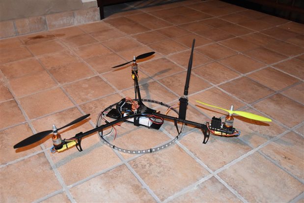

LED strip mount
I repurposed the old Chinese umbrella wires to make a lightweight wireframe mount for my WS2812B LED strip image Wires were painted black to match the Tricopter body.
Unfortunately, I forgot to take pictures during the wireframe build. I only have post-build pictures.
LED strip mount was attached using metal clips (also made from umbrella parts). These clips make it easy to attach/detach the mount to/from tricopter body:
LED strip was carefully attached to the wireframe mount using zip ties:
This is how it ended up. I'm very satisfied with the outcome:
