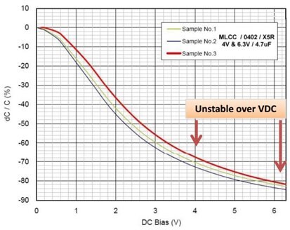

As you may know multilayer ceramic chip (MLCC) capacitors, like the ones I am measuring in this test, change capacitance significantly based on voltage. The following graph shows they can lose over 80% of their rated capacitance near their rated voltage. It is worse for dense capacitors so a 1uf 0603 will be affected more than a 1uf 1206. This will have a significant effect on filters and other circuits requiring stable capacitance. It may be worth placing such filters before your amplifiers.
The reason capacitance degrades with voltage is that the permittivity of Barium Titanate (ceramic dielectric) is a function of voltage – spontaneous local reversals of polarization at the crystal lattice level are increasingly inhibited by stronger electric fields. Polarization reversals increase permittivity and capacitance is directly proportional to permittivity, so the higher the voltage, the lower the capacitance.

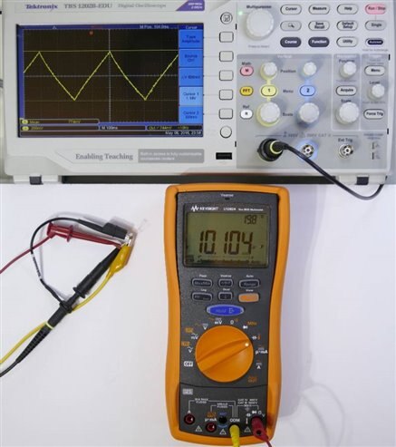

The scope trace tells us a number of things:
  • The wave form is a triangle wave, which means the Keysight is using a constant current source and constant current sink to generate this frequency.
  • The frequency is 99.1 Hz (implying the charge period is 5 ms), the capacitance is 21.46 nF and the voltage is about 850 mV; so the constant current is about 3.65 uA (because i=CV/t)
  • The peak-to-peak voltage is 856 mV but the peak voltage is 1.18 V because the waveform is offset from ground.
The signal looks to be around 1 volt which is good because it is below where 16V MLCC capacitance falls off the cliff - as shown above. Most of my my capacitors are 16V or more, except maybe a couple of 10uf caps.

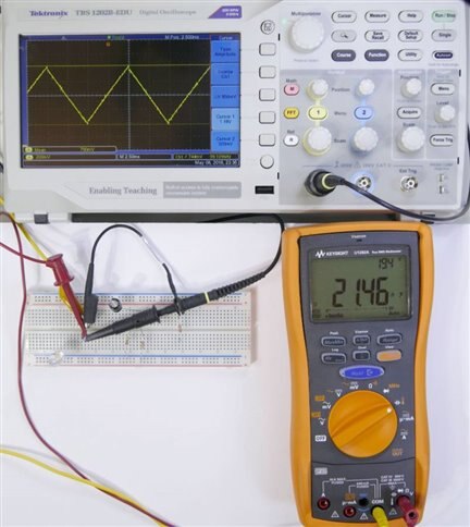

But here is what a 10 uF, 6.3 V 0805 MLCCapacitor looks like on the scope.
Note even at this low voltage the slopes of the triangle waveform are not exactly straight lines. This shows the capacitance is changing with voltage. The frequency is about 2.5 Hz.

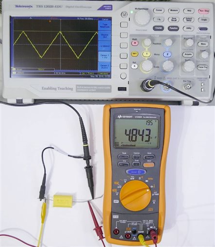

Here is a high voltage 4.7 uF plastic film capacitor for comparison – its capacitance should be pretty stable with voltage:
Note the better triangle waveform. The frequency is about double the frequency of the 10 uF measurement, as you would expect with a constant current driver.
