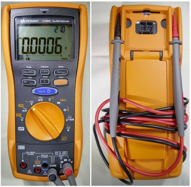

Note the handy storage clips for the probes, that protect the probe tips and control the leads while not in use. Those probe slots provide extra cushioning if the device is dropped.

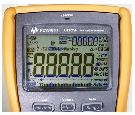

This instrument is quite large for a handheld meter, (22 cm x 10.1 cm x 5.8 cm) but feels good and solid at 702 g. The five large 2 cm digits are easily visible from about +- 80 degrees horizontally, about 70 degrees tilting down and about 85 degrees tilting up. The display also has a lot of other information on it depending on what it is measuring as this test screen shows.
This LCD test screen is initiated if you hold the Hold button down while turning the device on.
The primary functions are labelled well and intuitive to anyone familiar with digital multimeters, however this is a high end multimeter with many more functions available than those labelled. For example, when in setup mode, there is a whole menu of adjustments and settings to choose from. There are subtle arrows on the hold button allowing right and left menu navigation and there are similar vertical arrows on the Null and Backlight buttons for vertical menu navigation or parameter adjustment. The Hz button doubles as a select or Save button and the Shift button doubles and an ESC key.
