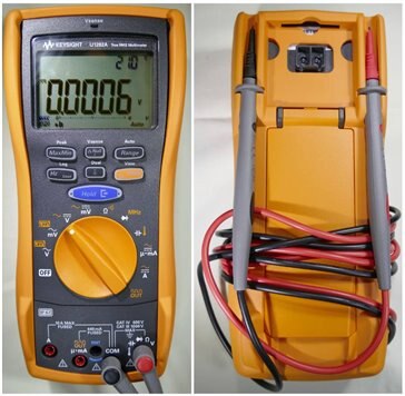

The Keysight  U1282AU1282A Multimeter is an awesome instrument loads of features great resolution(59999 great accuracy(0.025 spectacular battery life(up to 800 hours and phenomenally rugged(3 m drop and IP67 image

The meter is waterproof and all controls reflect this design objective, none the less, they all provide good tactile feedback with enough spacing to allow operation with gloves on. The hinged stand is part of the inner hard plastic case, so it will still stand up fine with the protective rubber shell removed.

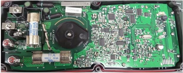

Removing the 6 self-tapping case screws allows the back, which houses the batteries, to come off, revealing the back of the rotary switch and a couple of large high voltage, high current fuses.

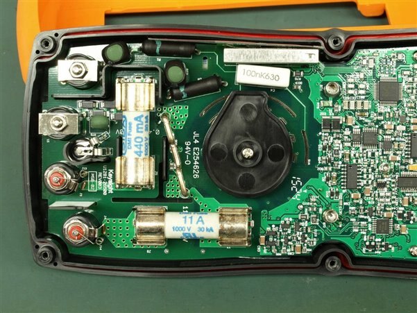

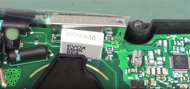

In this close-up of the terminal area you can see the lengths they went to to protect against high voltage and current. The PCB has physical slots and metal shields to prevent arcing across the surface. There are perhaps 5 positive temperature coefficient (PTC) resistors (large green or black components in the input area) that will increase their resistance if they experience high current.
The white brick here looks like a nice 100nf Kemet Evox metallized polyester capacitor 630 V. The metal cover behind it shields the range-selection ceramic resistor network of temperature coefficient matched resistors. The spring connects to a battery terminal.image

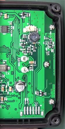

Over at the right is the V-Sense circuit to detect high electric fields.

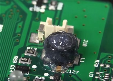

Zooming in - this inductor (L1) has been gooped up with RTV, probably to make it better able to survive high g shock loads. Inductors can be relatively large with lots of heavy iron and copper in them and they tend to break before most other types of component.

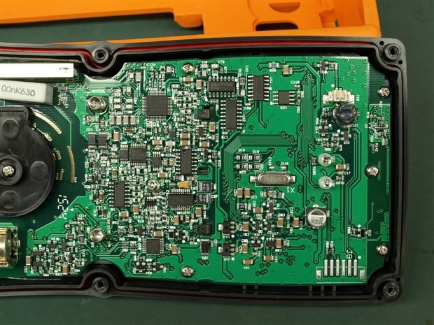

In this overview it looks like there are about 15 chips with more than 4 pins. A crystal is also visible.image

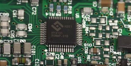

The 48 pin LQFP chip is a very capable Hycon HY3131 DMM analog front end.

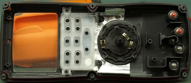

This image shows the back of the front cover with the rotary selector in the middle. The silicone rubber keypad has 12 carbon-silicone contact pucks.

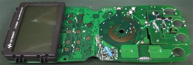

The top of the CCA does not have much circuitry but you can see more clearly how extensive the isolation cut-outs are, and you can see the hard gold contacts for the rotary switch. It looks like the keypad contacts use the same contact finish.
Just above the rotary contacts are a couple of gas discharge tubes (GDTs) to protect against high voltage. On some of the other images you can see there is actually a slot right under each tube to prevent arcing on the card.

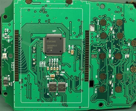

With the LCD off you can see the rows of pads that connect to the LCD zebra connectors. The main CPU and display driver chip is a Renesas D78F0485 which is an 8 bit CPU with a 16 bit A/D converter. You may be able to deduce the clock rate from the crystal on the other side.

    I don't think it is necessary to provide cures for extreme tests.
    I agree and it was impressive how much abuse it took.
    But the test where it was always dropped on the corner got me thinking if the 3m test done that way, could it cause the same issue.
    The design does seem to have those two parts that are vunerable, and they have gooped up the inductor (presuambly because it did fail).

    If I recall one of the parts that came loose was the thru hole xtal which had been mounted as a SMD.
    Pity they didn't also add some goop as insurance.
    The other item was the ceramic resistor that slide out the bottom of themetal housing.
    Granted these were extreme tests, but a relatively simple cure with little cost.
