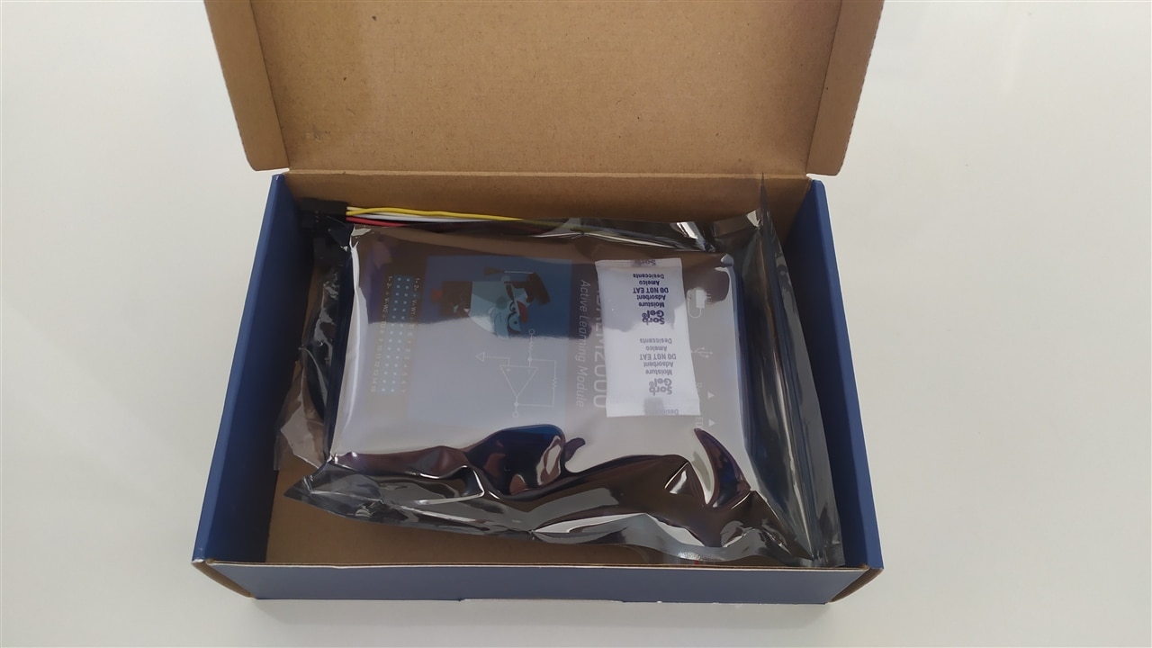

  • The ADALM2000 device, packed inside an ESD bag with (moisture absorbing) silica gel bag.

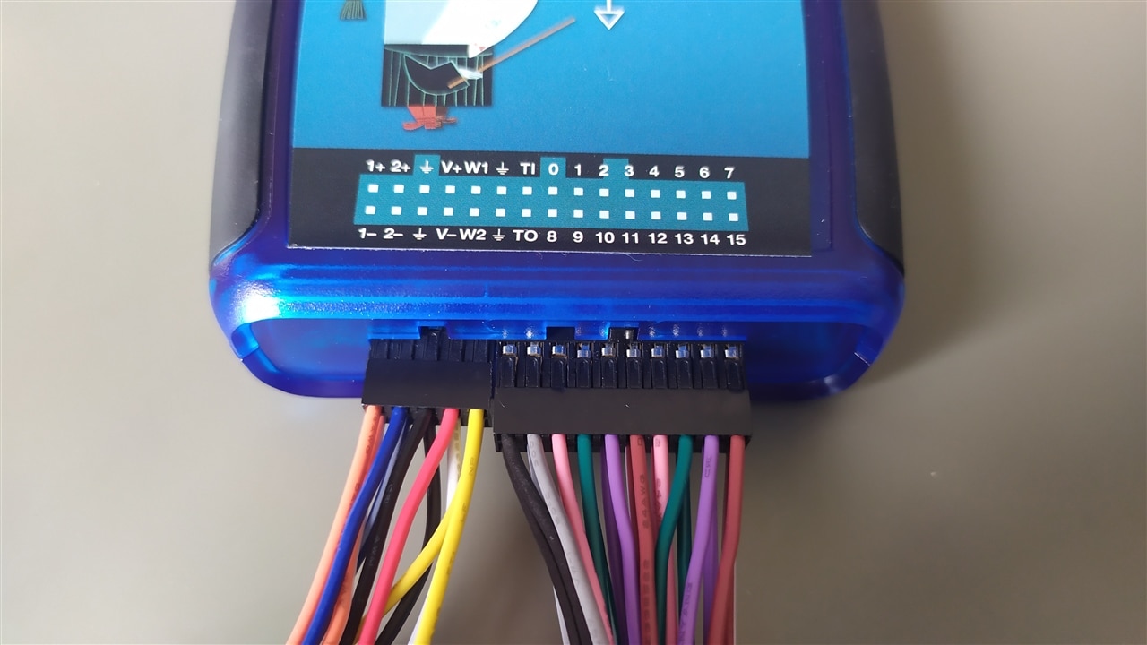

  • A set of wires to connect the ADALM2000 to the outside world. The connectors on one side fit the ADALM2000, while the other ends of cables all have single 2.54mm pitch "DuPont" female type connectors. These are breadboard friendly due to their 2.54mm spacing.

  • Personally, I ended up using the device mostly with a set of Mini "grabber" test clips I already owned. While the provided header pins are good for breadboard setups, in most other real world scenarios (e.g., using with production systems) the grabber clips are a lot more convenient. The fact that the ends of the ADALM2000 cables were 2.54mm female type helped here because these were directly compatible with all the types of grabber clips I had (most of them come with a male pin). Note that although not included with the ADALM2000, the BNC Adapter Addon (AD-M2KBNC-EBZ) does come with such grabber clips (in addition to oscilloscope probes) so I'll recommend it as a worthwhile upgrade.
  • One nice thing I observed was that the set of breakout cables that comes included in the package is actually not one but two separate harnesses. One connects to the mostly Analog side (left portion of  interface connector) while the other connects to the digital side (right side of interface connector). I realized that this was a good thing to have them separately because I found myself using the Analog side (Oscilloscopes, signal generators, dual power supplies) much more than the Digital side (Logic analyzer, Virtual IO, Pattern generator). If it came as one connector, it would have caused a huge mess of cables all the time. As it is, I can only connect the side I need and keep the other side in the box to keep thing nice and tidy. You can see the two connectors in the picture below (the right connector is not inserted completely here, to allow easy differentiation in the picture).

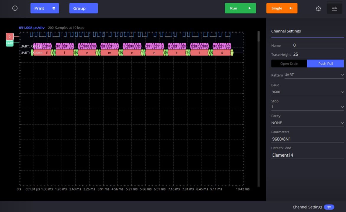

5. *Bonus* 100% Standalone operation
Did I mention a 5th bonus option? Well, again thanks to the Linux running natively on the device itself, you can run some applications on the device itself without requiring any external network connectivity or needing to connect to a host computer. The device only needs power and will keep running your scripts as long as the power is there! This is very helpful for logging applications. I found a short video on the ADI official YouTube channel that describes the process very well, so instead of replicating the process here, I will just leave a link here:
https://www.youtube.com/watch?v=-QblCcu9x_o&t=284s
Needless to say, I was able to follow along with the tutorial and replicate the logging experiment without any issues. This is one of the features I will definitely be using for some long running tests for work, in future.

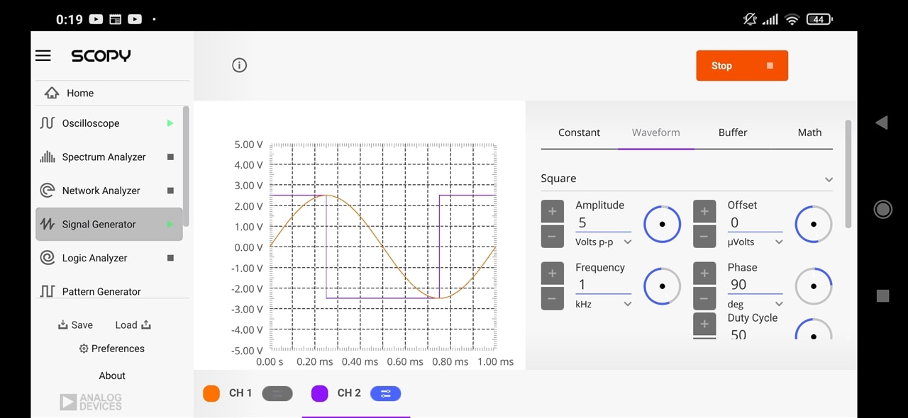

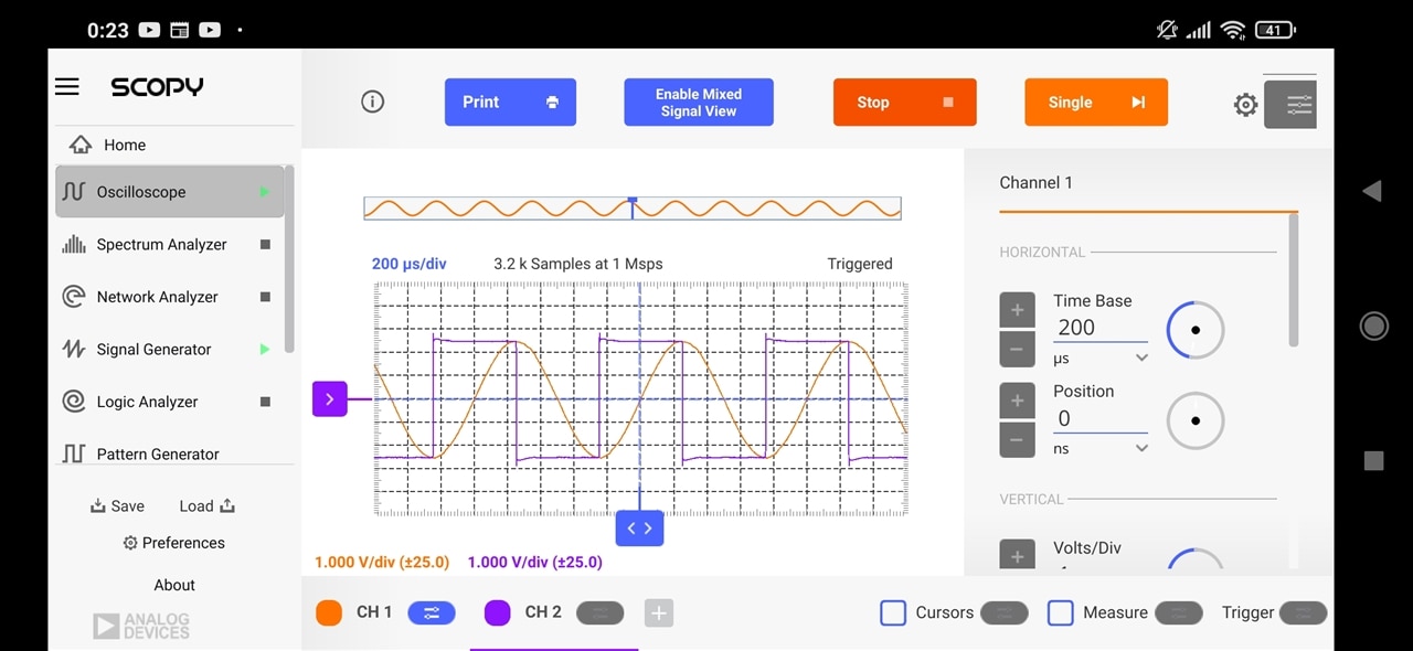

Scopy App on Android
The Scopy app, as per my understanding, is designed for cross-compatibility across platforms, i.e., the same application can be compiled and used for most major platforms. This includes Windows, Linux, Mac/OSX, and.... Android! The good thing about this approach is that you get the same familiar user interface irrespective of what host platform you're using. I found this to be a potentially useful feature since I wanted to be able to use ADALM2000 with my Android devices. This would take things to another level in terms of mobility for me. Put the Scopy in one pocket and phone in another and carry your lab with you!
Installing on Android is as simple as downloading the app from the app store. I verified that the version on Google Play store was indeed the latest one.
Since my phone uses USB-C, I used an appropriate OTG adapter to connect with ADALM2000.
After executing the app, it took permission to use the USB device, and that was it! I had ADALM2000 working with my phone!
I then played around with it to see how usable it was with my phone. A simple test is shown below whereby I started the Signal generators to generate Sine and Square waves.
Then, after connecting the signal generator channels to respective oscilloscope channels, I could observe these on the oscilloscope channels as well as on the Spectrum Analyzer.
All the above screenshots are taken directly from my phone. I used the Light Mode here (from the "Preferences" page in Scopy) instead of the default dark mode.
Although the user interface was usable, due to smaller sizes of controls (compared to my fingers) it was a bit harder to tap in the right places. Of course the controls had scaled down based on my phone screen (6 inch). So I figured it's more suited to a tablet instead, something with a bigger screen. Unfortunately I didn't have access to any android tablet except my BOOX ePaper tablet. It runs android so I decided to try it anyway despite the ePaper screen. Again, installing was easy and the device did seem to get connected without issue. However, I found that the interface element didn't display too well with the ePaper display (I tried all ePaper modes).

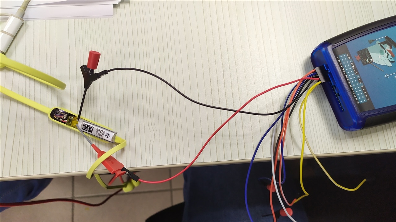

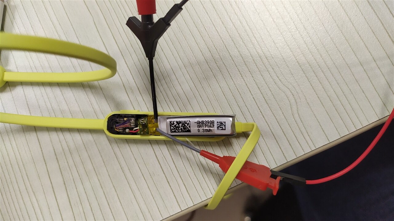

Unfortunate outcome for me, but to be fair this is NOT Scopy's fault since I am sure no one had ePaper displays in mind when they thought of Android support. ePaper tablets are an extremely small population among android tablets anyway so it doesn't matter. Should work fine on a normal Android tablet.
Going back to my experience of using the ADALM2000 with phone, I observed that while it was usable, there were few things which I think can be improved:
  • The UI elements do not respond to touch gestures like we have come to expect in the smartphone age. For example, to scroll up/down you need to drag the scroll bar. Just touching and dragging the screen on any scrollable UI element doesn't work as it does in modern touch interfaces. In case of using on the phone, this made it very difficult since the scrollbar becomes very small compared to finger size. For tablets this should be better but my point still remains.
  • Similarly, even inside the graphic display parts of the screen (which displays the actual data), pinch-zoom (in or out) doesn't work. To zoom-in you need to tap and drag like you would with a mouse. To zoom-out, you need to double tap the screen. This double tapping, in my experience, didn't work too well as sometimes it would take the double taps as a tap-and-drag and zoomed-in instead. Also there was no way to pan once zoomed. Again I would highly advocate support for the popular touch gestures (pinch zoom, pan, etc).
One word of caution: Keep in mind that when used with phone/tablet in the configuration shown above, the ADALM2000 consumes power from your Android phone/tablet so the phone/tablet battery will deplete (much) faster than usual. For prolonged usage in this configuration, if needed, you can use the second USB port on the ADALM2000 to provide power to the ADALM2000 separately while still staying connected to your phone/tablet.

Overall, I found the oscilloscope channels to work as advertised and was very easy to use.  You get the usual oscilloscope settings of  setting time base, Voltage/div scale, trace positions in X and Y, etc.
I did not have the BNC adapter board for the ADALM2000, and so with the flying lead setup I could see the ringing at the edges even at 100kHz (although it has more to do with the fast edge than the frequency of the square wave). I think if I had the BNC Adapter board with some proper probes, I could have used the compensation potentiometer on the probe to get rid of the ringing.
Although the frequency of the oscilloscope channels is much limited compared to most lab bench oscilloscopes, the fact is that 90% of the time we are looking at signals that don’t go beyond a few Mhz. That said, do keep in mind that Bandwidth and Sample rate are not the same thing!! There is a very good video by "The bald engineer" on this topic that I would refer you to (https://www.youtube.com/watch?v=9AJRaDJ0ofQ ). My point here being that 100MSPS is the sample rate of the ADCs, not the bandwidth! A visual demonstration in this case is that at 10Mhz, the captured signal (square wave) is already looking like this:
One strange observation I had was that there is something with the sample rates or the input filters such that when I increase the timebase, the signals seemed to get filtered. As an example, the 10Mhz signal displayed above was captured at 100ns timebase (minimum possible value). If i switch the timebase to 100us, the signal totally disappers.
I am not sure if this is the expected behaviour. At least I don't remember the normal benchtop oscilloscopes doing this. Perhaps someone more experienced with this can help explain!
Anyway, you get to display the 2 hardware channels, and in addition you can also display Math channels, Import and display reference signals (that you perhaps saved before), and you can also enable the mixed signal view to show logic channels alongside the oscilloscope channels.
For the snapshots, I noticed that you can display up to 4 snapshots at a time for comparison (the "Snapshot") button on bottom right of screen is handy for that! Once you take and display the snapshots, you can shift them in the Y direction but not in the horizontal direction.
You can also enable the FFT, X-Y and Histogram displays, which then appear as tabbed displays in the window (you can view up to 2 at a time). I did not use these views too much in my own testing but I believe these would be useful when you're looking for the relevant information.
The (edge) triggering worked fine and having the option to set hysteresis on the trigger was helpful especially when dealing with noisy signals. You can also trigger on digital signals as well as from an external trigger.
Lastly, you can add the usual cursors (2 horizontal, 2 vertical), as well as vertical and horizontal measurements (Duty cycle, freq, pk-pk voltage, etc etc etc)
One very interesting thing about the oscilloscope in the ADALM2000 is that the inputs are "differential" in nature, which is very interesting since most lab oscilloscopes have single ended inputs and require special (expensive) differential probes for looking at differential signals. This was very useful to me when doing the experiments with twisted cables (differential signals), and also when looking at some differential encoder signals during a field visit.
2-ch Function Generator:
The function generator is a very integral part of an instrument like the ADALM2000 since in many experiments you need a controlled source to stimulate your Device Under Test. The dual channel function generator inside the ADALM2000 worked well in my testing. Keep in mind that the outputs of the function generator are single ended (unlike the oscilloscope channels which are differential). For this reason in my experiments with twisted cables I used a BALUN to convert the signals to differential.
Some things I really liked about the Function generator:
  • The "Buffer" function allows you to load a csv, tab-delimited text file or a .wave (sound) file as your pattern. Once loaded, you can scale the signal in Amplitude, offset, phase and sample rate which is very handy. I also found that the format of the csv file is so simple that I was able to create different signals in excel itself and just export the data as one column. Extremely easy and convenient. I was also able to load sound files in .wav file, play them through the Signal generator outputs, and connected them to headphone wires to hear the signals (with just a bit of distortion due to the 12bit ADC instead of the usual 16bit for sound)
  • I found the Math functions very handy to generate signals that otherwise are not possible to generate with the basic waveforms. For example, I was trying to generate "Sinc" signals which I couldn't generate from the basic waveforms. The math function allowed me to generate the signals using the equation for Sinc functions easily.
  • I really loved the feature to be able to add "Noise" to any generated waveform. This is a very well-thought feature. Adding noise to signals helps us simulate real-world signals much better. I used this feature several times when playing around with signal coupling transformers to see how the behaved in terms of filtering and passing noise, for example. You can choose from 4 different types of noise types (Uniform, Gaussian, Laplacian, Impulse) and also set the Amplitude for the noise.

On the Logic Analyzer side, you similarly select what DIO channels to use and optionally assign a decoder to single or group of channels. The difference, though, is that in this case there is a LONG list of decoders to choose from, which I was very pleased to see.
A uart decoder on the same channel with matched baud rate enabled me to see the decoded data on the screen.

One day the power supplies inside the ADALM2000 served an interesting purpose. A colleague of mine asked me to look at her wireless earphones that seemed dead. I was at my office desk without any instruments. However, I had my ADALM2000 in my bag. Anyway, I opened the cover and checked the voltage on the single cell battery (with ADALM2000's voltmeter), which was below 2.5V so the protection circuitry had decided to disconnect it and was refusing to charge it back. I then used the power supply inside the ADALM2000 to "jump start" the battery again by setting it to the measured voltage, and slowly increasing it to 4.2V in steps of few hundred millivolts. Since the measured value is shown along with the commanded value, I could see when the battery had charged to the commanded value (so I could increase further). Long story short, the battery was brought back to life and the earplugs started working again without me having to even leave my desk.
The ADALM2000 clearly saved the day!
