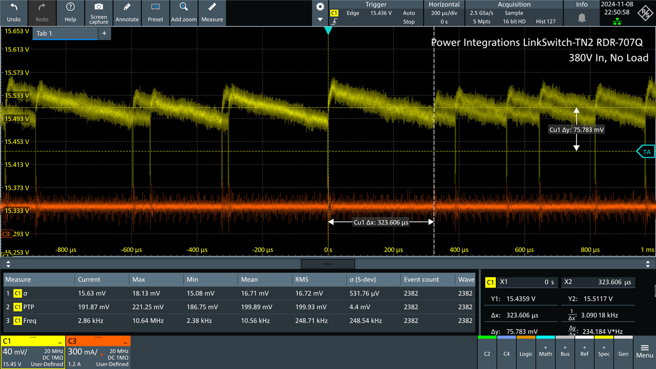

380V
image image
Increasing to 380V, the no-load ripple averaged 200mV peak-to-peak; at full-load this was 267mV peak-to-peak.

FFT
A look at the FFT showing harmonic spikes with some breath indicates the spread-spectrum (or frequency jittering as they call it) is working to reduce EMI emissions at single-frequencies.

  • Thanks for the reminder. I did suspect this, based on seeing another schematic in the datasheet with a 15kOhm resistor over the output instead of the TVSS + resistor combination. That is interesting to know that the TVSS + resistor combination is not purely used for protective reasons but is a required functional element.
    In the meantime, I guess I missed this part in the datasheet. My bad!
    Pre-Load Resistor R4
    In high-side, direct feedback designs where the minimum load is
    <3 mA, a pre-load resistor is required to maintain output regulation.
    This ensures sufficient inductor energy to pull the inductor side of the
    feedback capacitor C3 to input return via D3. Recommended values
    of R4 should be selected to provide a minimum output load of 3 mA.
    However, lower pre-load resistors increases no-load input power
    consumption and improves regulation at no-load. Higher pre-load
    resistors decreases no-load input power consumption and worsen
    regulation at no-load. Selection of pre-load resistor is a balance
    between no-load power consumption and no-load regulation.
